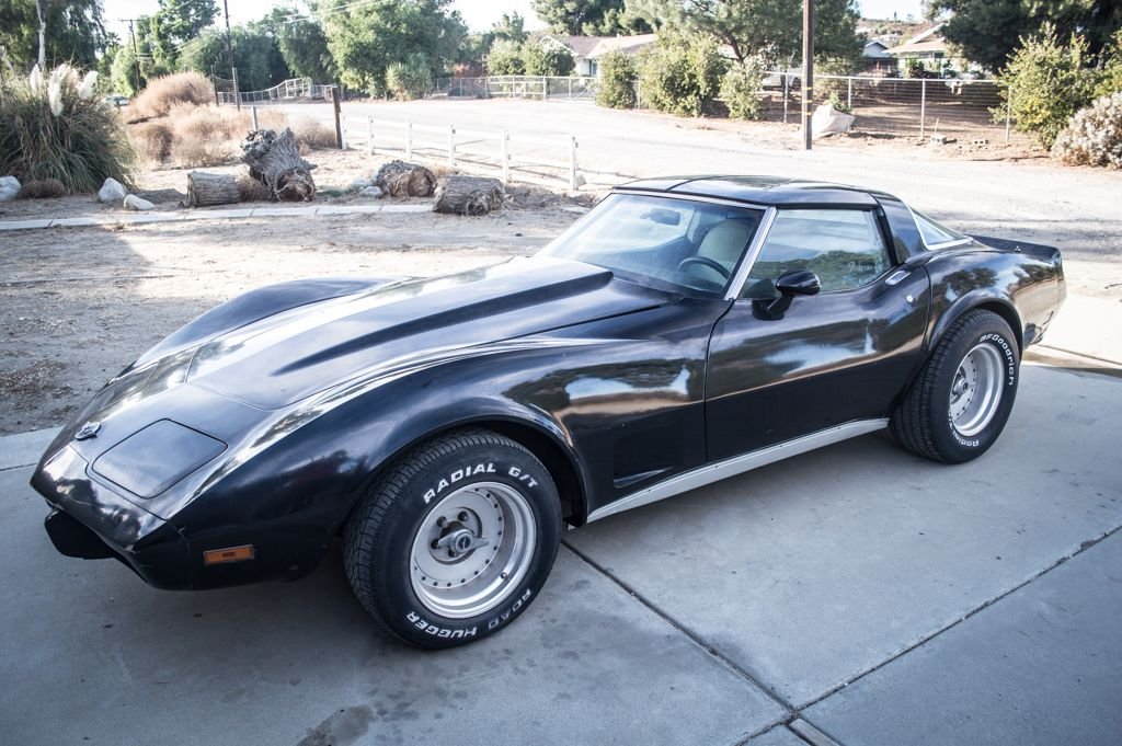

Hi all,
Question to this group... my 1978 Corvette doenst have a smog pump or a catalytic converter.
It wont pass smog emissions, and therefore it is non-op in the great state f California.
My intake is an Edelbrock... could I change my Holley carburetor to a fuel injection carburetor and intercut on a catalytic converter to my exhaust pipes to get this to pass smog... or will a redo of the manifold, carb, catalytic and the addition of a converter and smog will be the only way to get this thing to pass?
The car runs good, but I cant get it registered because the previous owner decided to hot rod it and take off all emissions. Appreciate any help!
