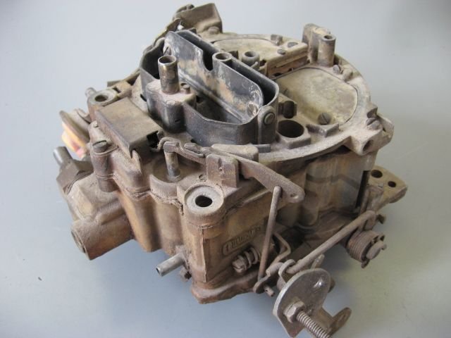

As "good" Q-Jet carbs become more difficult to find, I have been providing a "coaching" service to assist people in finding good, original, rebuildable Q-Jets for their Corvettes. As most of you who have been following my opinionated posts know, I highly discourage the use of the junk, "commercially rebuilt" carbs - those carbs are a complete waste of money, and will seldom run well enough to make your engine idle - much less make your car run right. So I encourage people to find unmolested, un-rebuilt, original carbs, and then do a good rebuild to bring your car back to it's original configuration and level of performance.

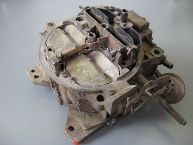

The carbs you want to find are the old, un-restored carbs with lots of grime and dirt. Not rust. Just slime and bugs. Scorpions in the float bowl are just fine (I feel like the "Farmers" insurance commercial: "I know a thing or two, because I've seen a thing or two." Yes, I have received carbs with dead baby scorpions in the float bowl). Here is a magnificent find that one of our Forum members sent to me for evaluation off an eBay ad. It's a 7029202 1969 standard 350 Vette carb. $35 (this was actually the second '69 Vette carb for less than $50 that Forum people found on eBay this week). This carb is absolutely beautiful - a fantastic eBay find:

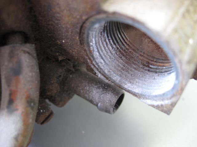

Gotta' love the stripped inlet threads:

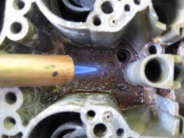

So much crap in the float bowl that I had to use a torch to get the jets out:

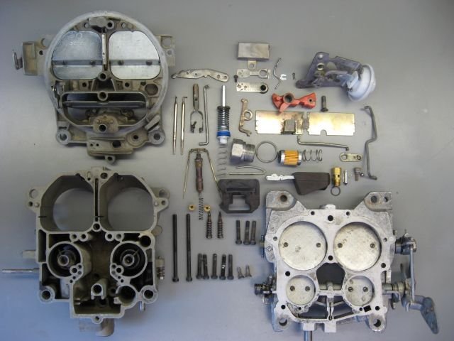

But after hot tank cleanup, de-oxidizing solution, and inlet thread repair the carb is ready to go together. Here it's all laid out in its glory:

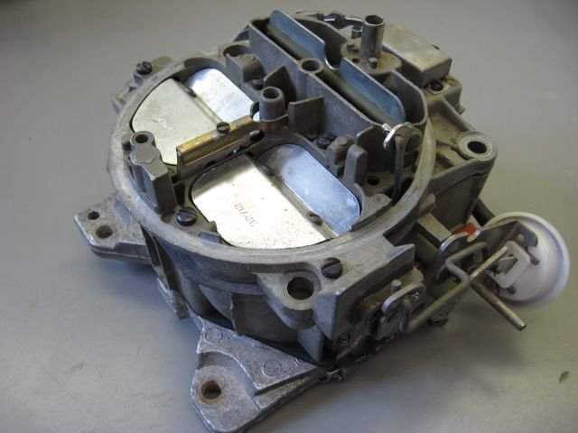

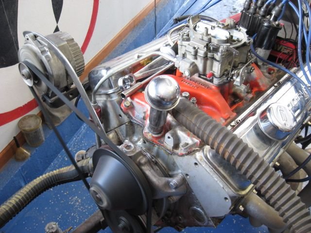

Carb assembled and on the test engine - it tested and ran perfectly:

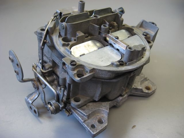

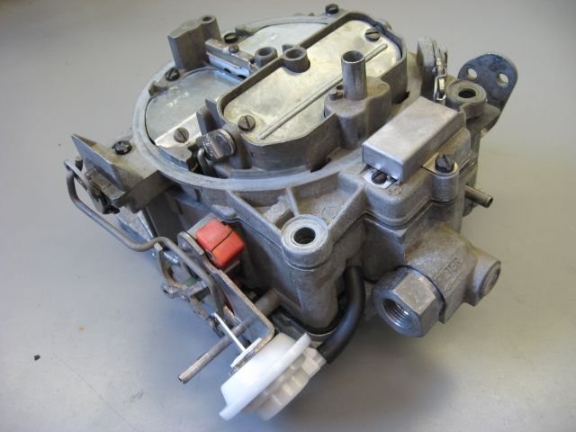

The same eBay carb after cleanup, rebuild and final testing. Everything is correct and original from the steel fuel inlet fitting to the "doghouse" vent cover. A very nice original, correct setup for any '69 Vette:
