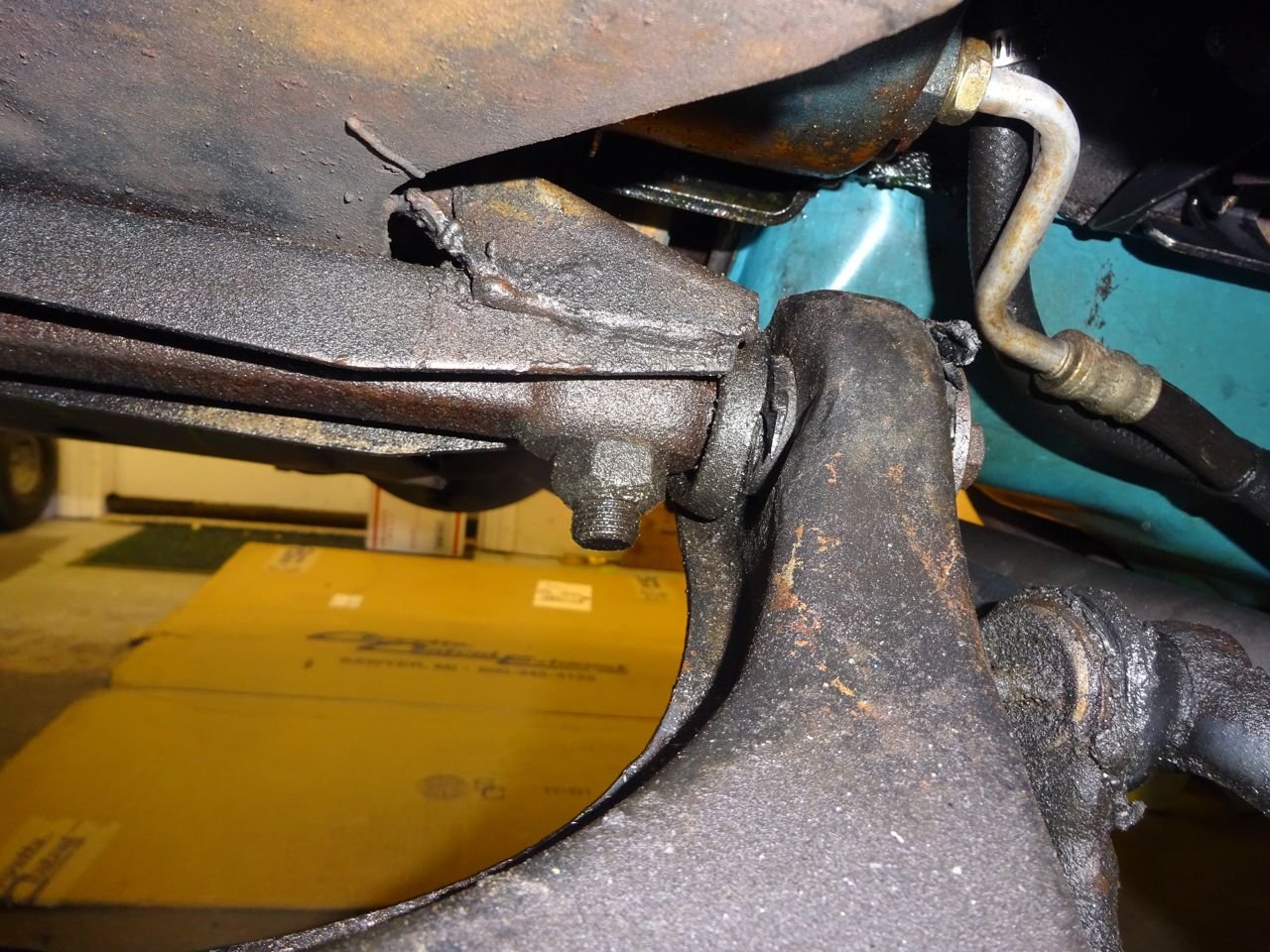

Is this the bolt you're talking about? It's been a while but I don't think I had to hold the bolt head. I just put a socket on the nut.
That's the one.
