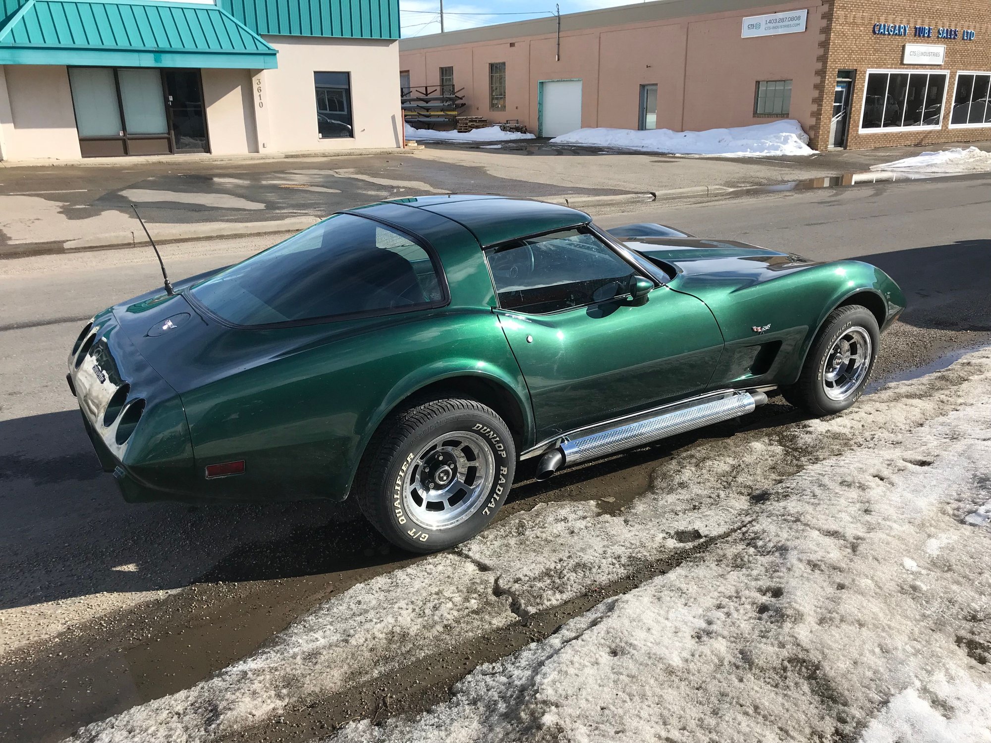

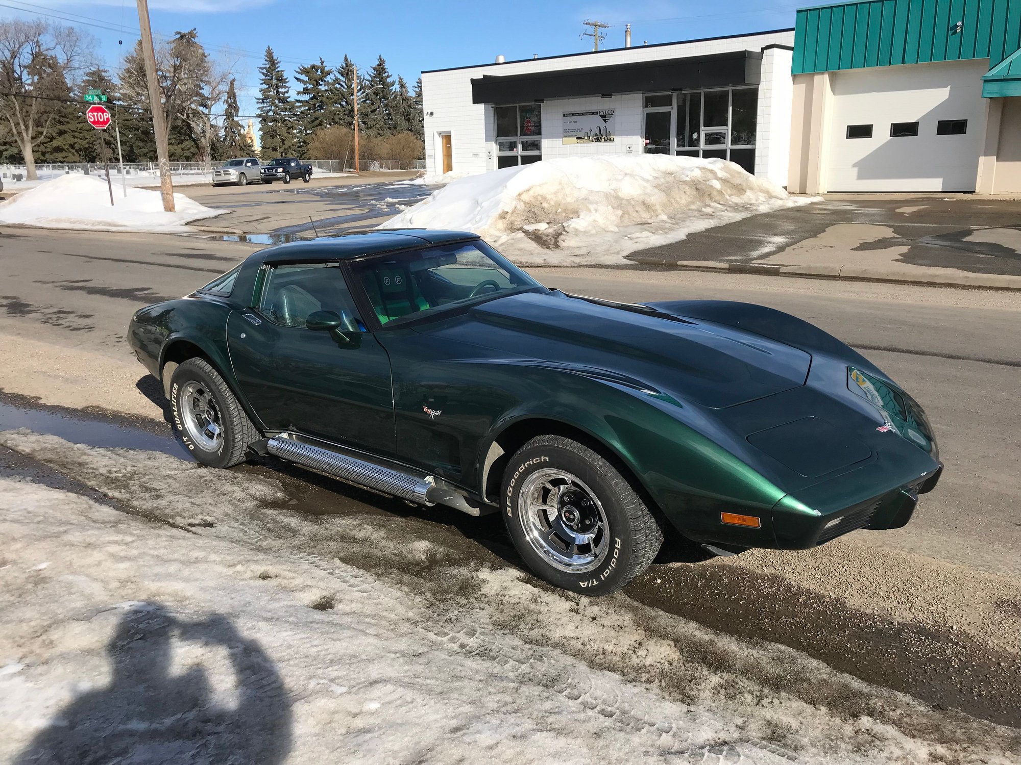

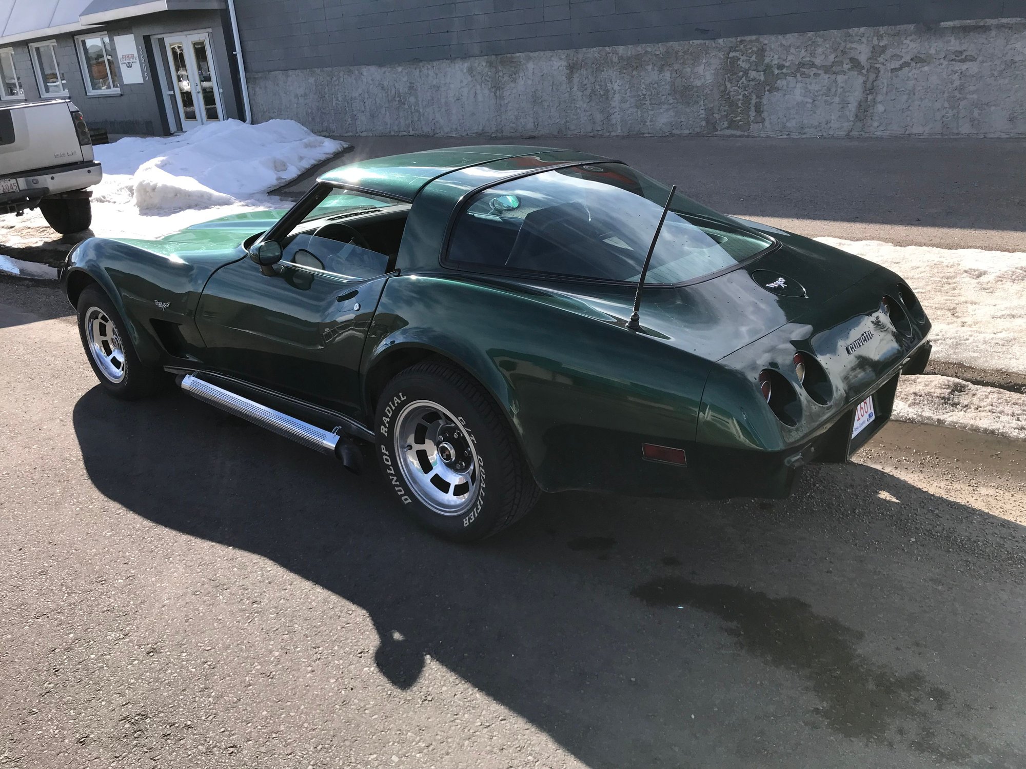

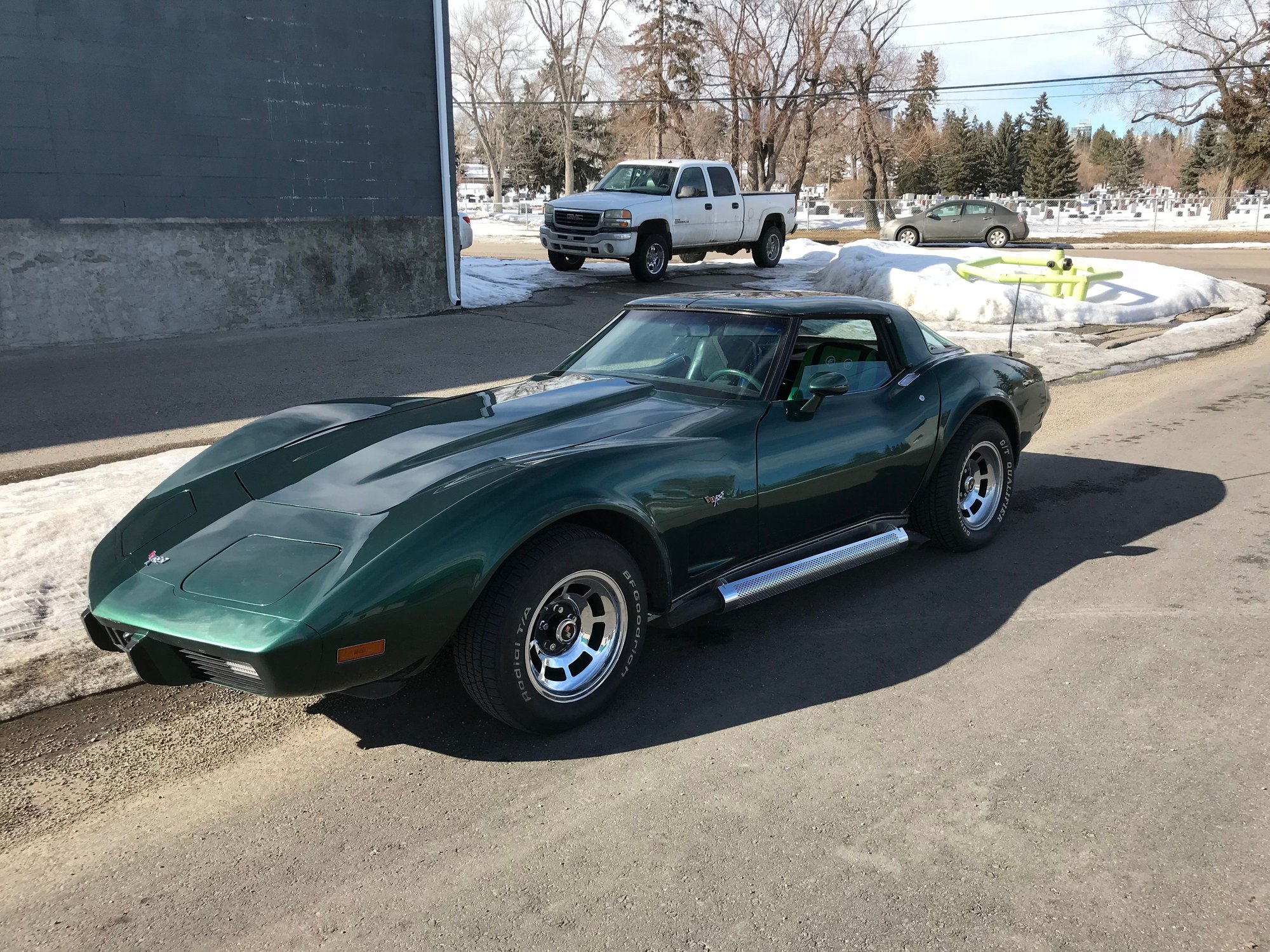

is this a vette that is one huge tire!

I agree, I went back to confirm the tire size so many times because I thought I must be crazy and read it wrong as compared to what I found for stock tire sizes... It does not look like anything was changed from stock but those were what came with the car. The tires do not have DOT numbers on them which makes me think they're 20 years old at least (car was stored indoors with no sun exposure which is why the previous owner of 13 years felt they were in great shape - they still look brand new IMO)

those 20 + year old tires are time bombs.

Sounds good, I should be able to complete that this coming weekend and I'll keep everyone posted. The tires don't even show signs of cracking, the rubber feels soft to the touch still, i'll post some pics so everyone can get an idea
