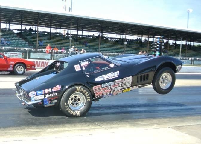

NHRA lists the L82 and the heads. But their source document from GM has an error. I’ve dealt with NHRA for 20 years. This isn’t my first rodeo with them. Here’s our other stocker
