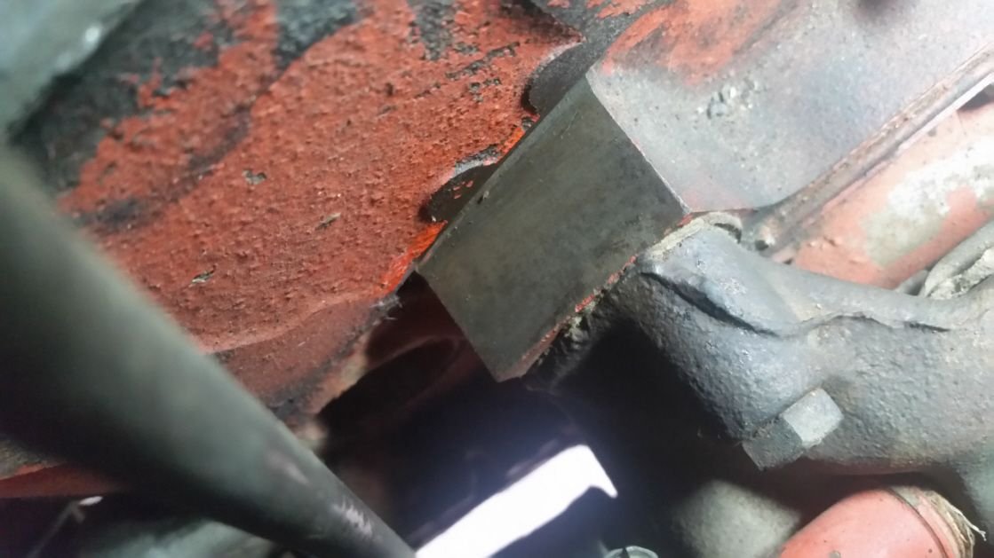

Over the years I have had 18 vett's from 57 to 71....I just purchased my 19th one and have a question...This is the first one I have owned in 30 years....Back when I had them we didn't care much what motor they had because we blew them up....I know about the serial pad and such but this engine has a serial pad that is square...Can anyone help me what engine this might be.....Thank you

look up the engine block number from the back of the block, also the date - it may give you additional information/
1970 = 3927186, 3927187, 3973414
454=3964291, LS7=3964291

Later 1970’s and 80’s used the shorter pad like that.

Thanks, I will get those numbers tomorrow......Air cleaner and console says 350- 370 hp But there is no serial number on the pad..

They went to the small pad in 1975

No numbers at all on pad, block has been decked.

The stamp pad shape changed in mid 1977 so that is a newer block than 1970.
