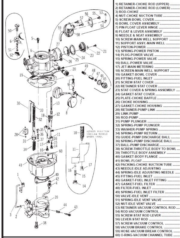

Here is a parts diagram.........#17 is the main jet. You could easily change this out but a few things:
1) Get kits for both. You may need them when you crack them open.
2) Get a few jet sizes.......it is impossible to know what you have now for main jet........so crack them open and inspect......get about three pair of jets....2 number down from the next one. Lean the jet out only 2 numbers at a time......until you hit the sweet spot.
3) Set idle screws before you start. This can be tricky on a dual set up so hook your vacuum gauge up and go until highest vacuum reading, but realize you have two carbs and try to get them as close as possible to number of turns out.
4) When you have them apart....check for proper power piston operation....#12 on the diagram....these must be free to open and spring back.
5) Check your timing too........find the factory setting and add a few degrees.
Have fun,
Jebby

Thanks Mel & Jebby - the information is excellent, but complicated if you've never done it before. I'll study the exploded carb diagram and the Carb shop website and see if I can make some sense of it. I found this very useful You Tube clip - https://www.youtube.com/watch?v=V2AINKEauVMand - and I'm studying it now. I'd love to get the truck running properly, so thanks for your help. Regards, Barry.
