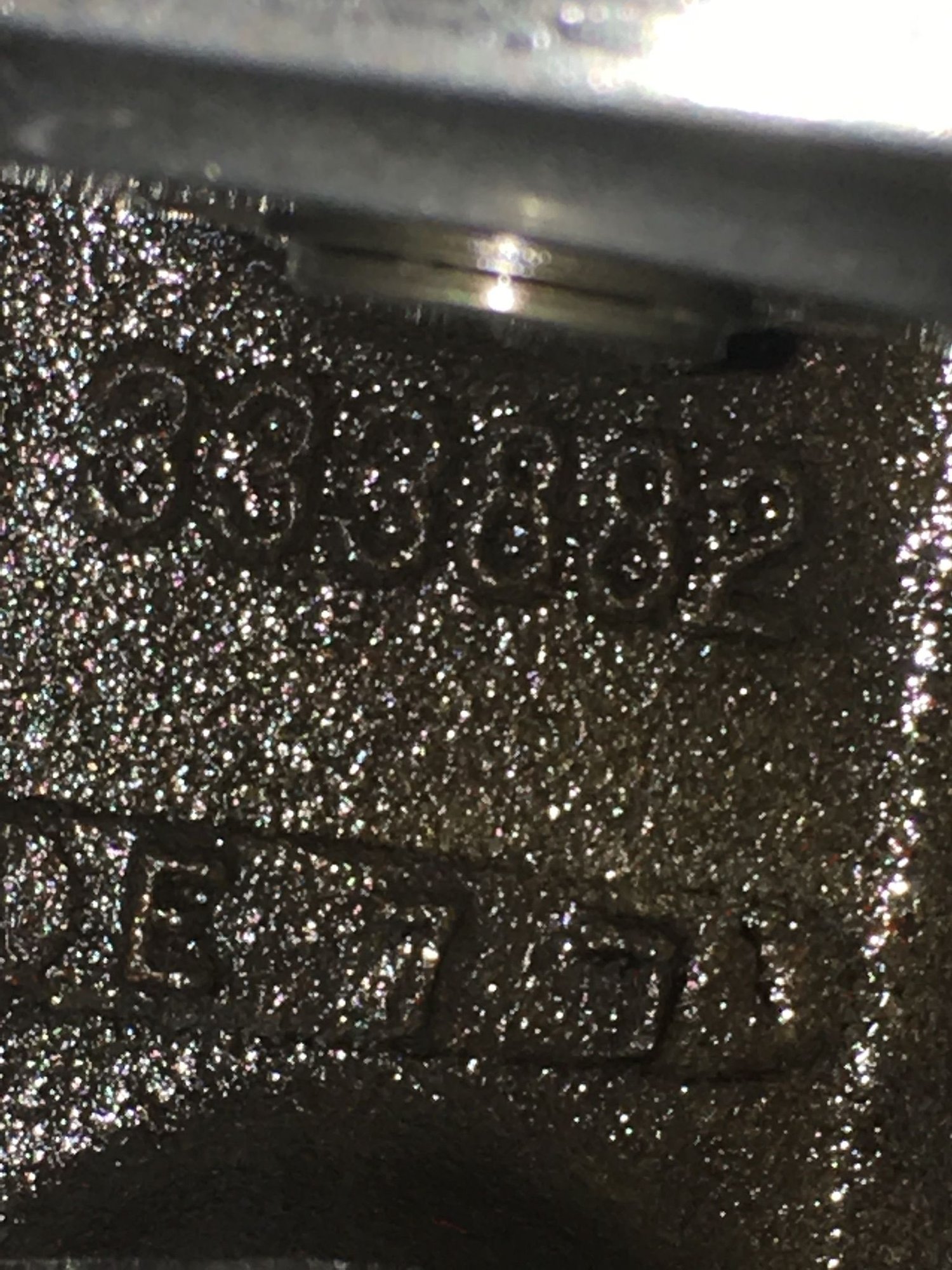

Ugh, 333 882

Hard to make any compression with those 76cc chambers (and an assumed short stroke). If they ever came off, I would not put them back on.
Now at least you know something about the engine.
