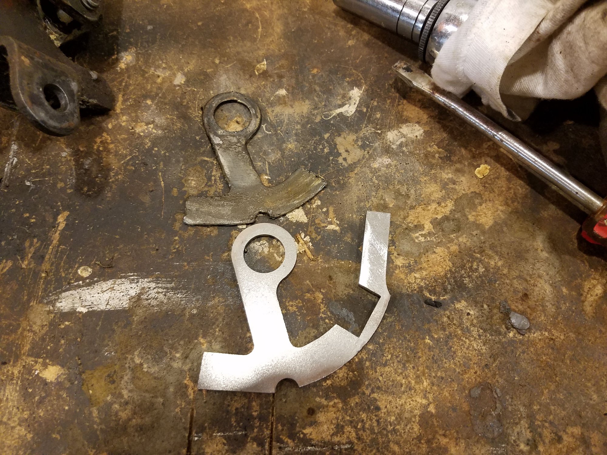

When I rebuilt my shifter I found the interlock plate broken as seen in the photo. Is this a common occurrence and does anyone know what might have caused the interlock to break like this.
Thanks.

somebody couldn't get into reverse and forced it?

Or the other way around and couldn't get it out of reverse. How is the interlock cable going to the steering column at the firewall. Was/is it connected. Check to see if it moves freely. I wonder is someone tried to or did steal the car at some point and broke it forcing the trans out of reverse. Just wondering, was the broken piece still in the shifter?

I do not recall ever having a problem getting into reverse but definately had trouble getting out of reverse on a few occasions. The broken piece was not in the shifter when I disassembled it. Could the piece that remained in the shifter have interfered with the linkage causing it to hang up in reverse?
The steering interlock cable had been removed by a previous owner.
Thanks for your replies.

But is the interlock lever, on the engine side, in the full UP position?

Yes it is.

The transmission is currently out of the car and will soon be rebuilt. When it is installed into the car the cable will be installed with it.
It seems that the best way to prevent a recurrence of the interlock plate breaking is a careful adjustment of the shifter linkage.
