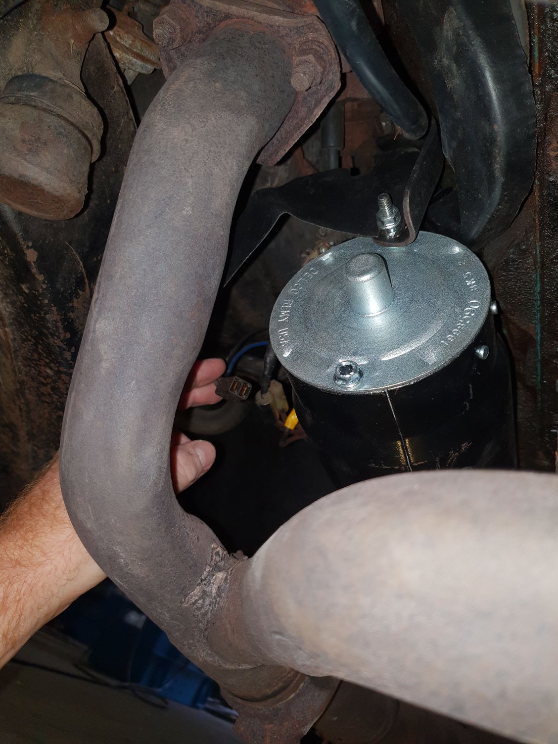

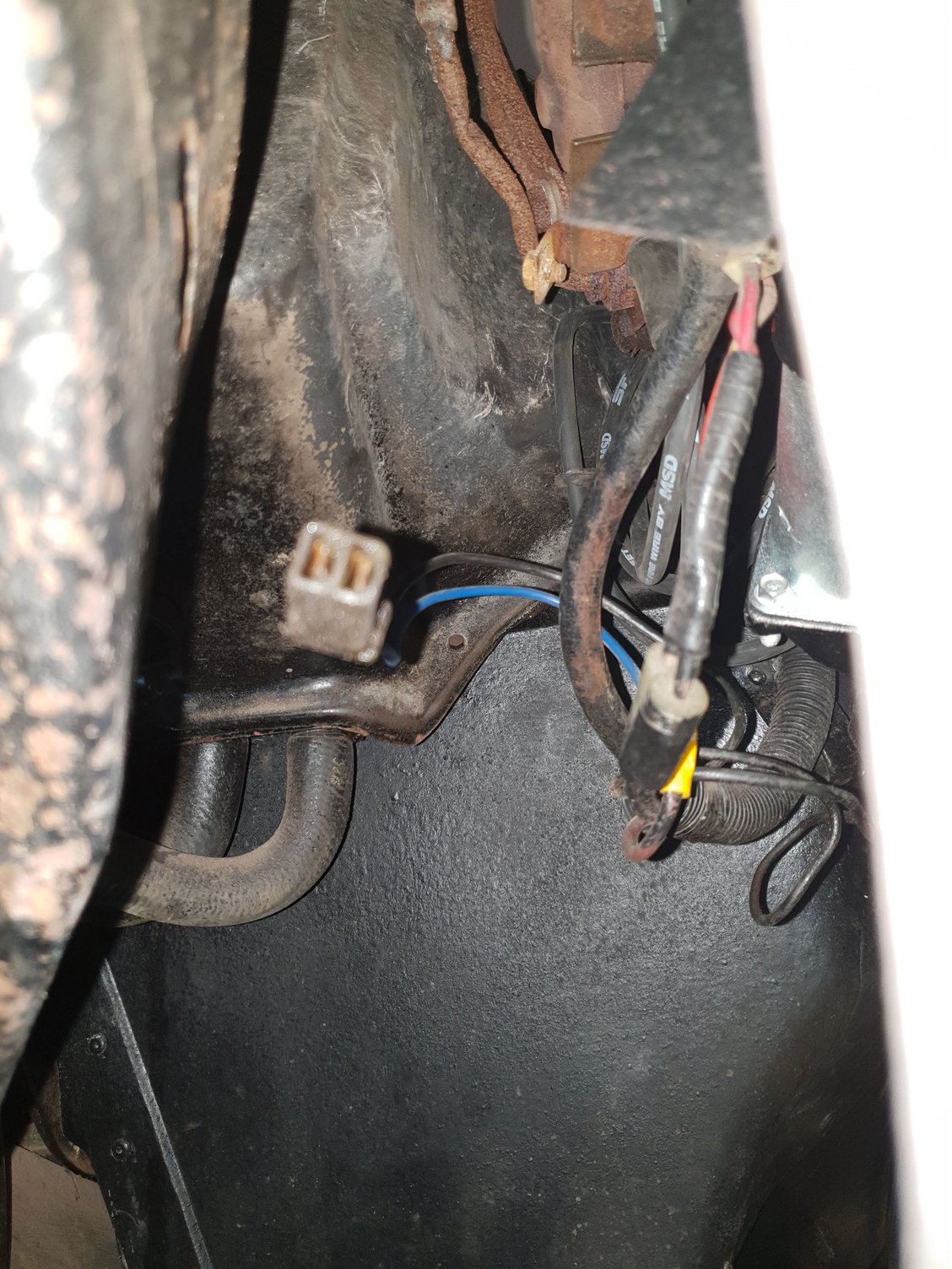

Don´t know why it didn´t work posting. Found this connector when replacing the starter and spark plug wires. Black and blue. Can´t find anywhere to connect it to. Goes up in the plastic tubing that holds the red and Purple wires to the starter. Connects to a larger connector close to the distributor. Can´t seem to locate it in my wiring diagram. Can´t recall pulling it off when I started the job. Bubba?

1979? Do you have L82 and AC?
That goes to the auxiliary electric fan switch kinda between the rear most 2 spark plugs on the passenger side.
If you don't have L82/AC it just hangs out of the way.

Sorry, had trouble posting, byt yes u r correct, 79 l82 4spd with ac. I,ll take a closer look between the plugs tomorrow.
