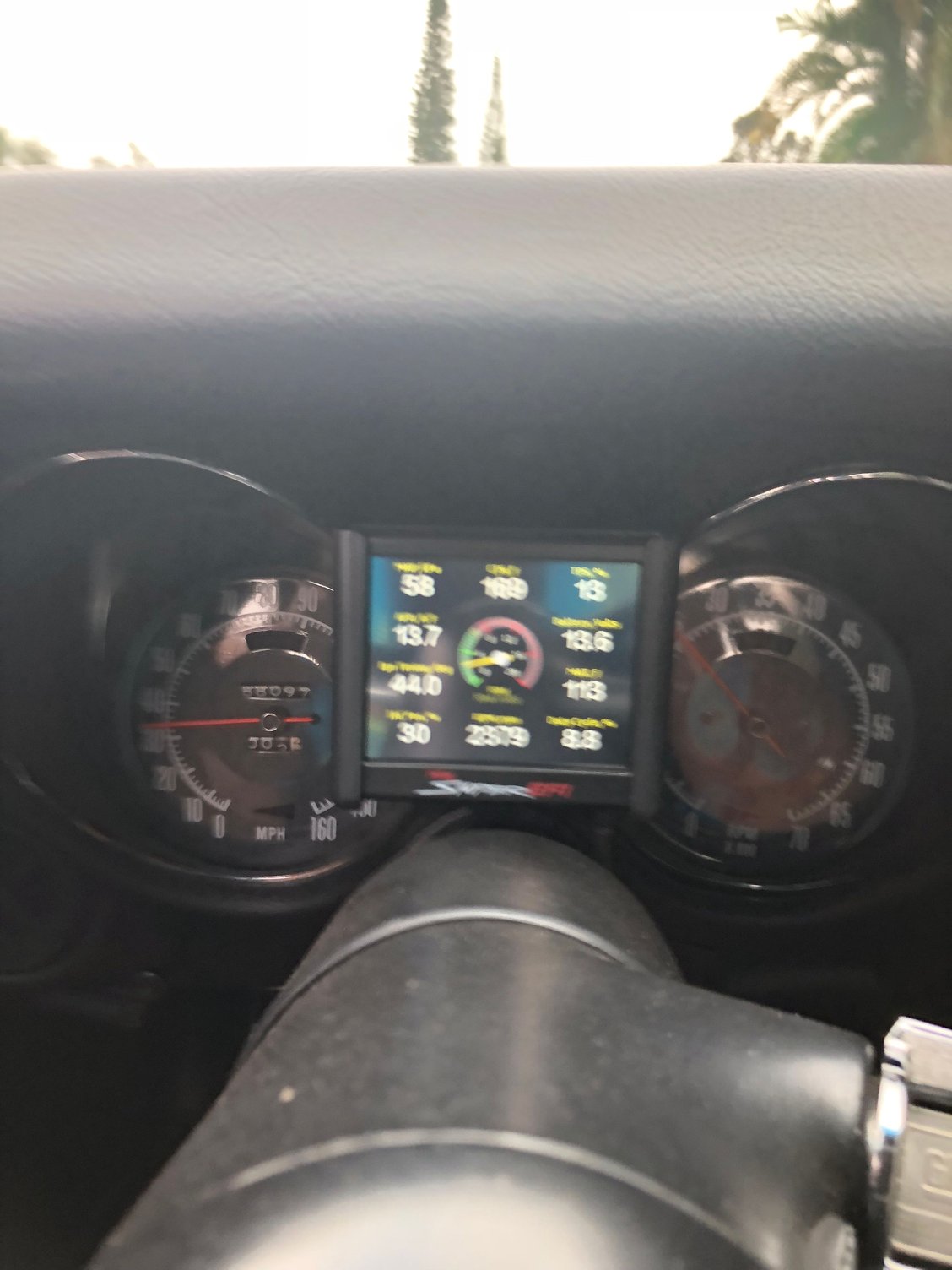

Here is my setup using a Sniper EFI installed about a year ago.I have two 02 sensors one in each bank.Two water temp sensors one mounted in the head for the
EFI and one in the intake manifold for the temp gauge.My fuel system is using a Robbmc power surge tank fed by the mechanical pump ,no need to mess with the existing fuel system and super ez to go back to stock if needed.I don't know about the FAST system but the Sniper still needed a laptop to fine tune it and get sum bugs worked out.The idle and drive ability is outstanding with the EFI controlling the timing..Vette starts right up idles perfectly no more stinky fumes !

Sniper display mounted on the steering column provides great info.. The Powersurge tank is mounted in the right side fender well area ..

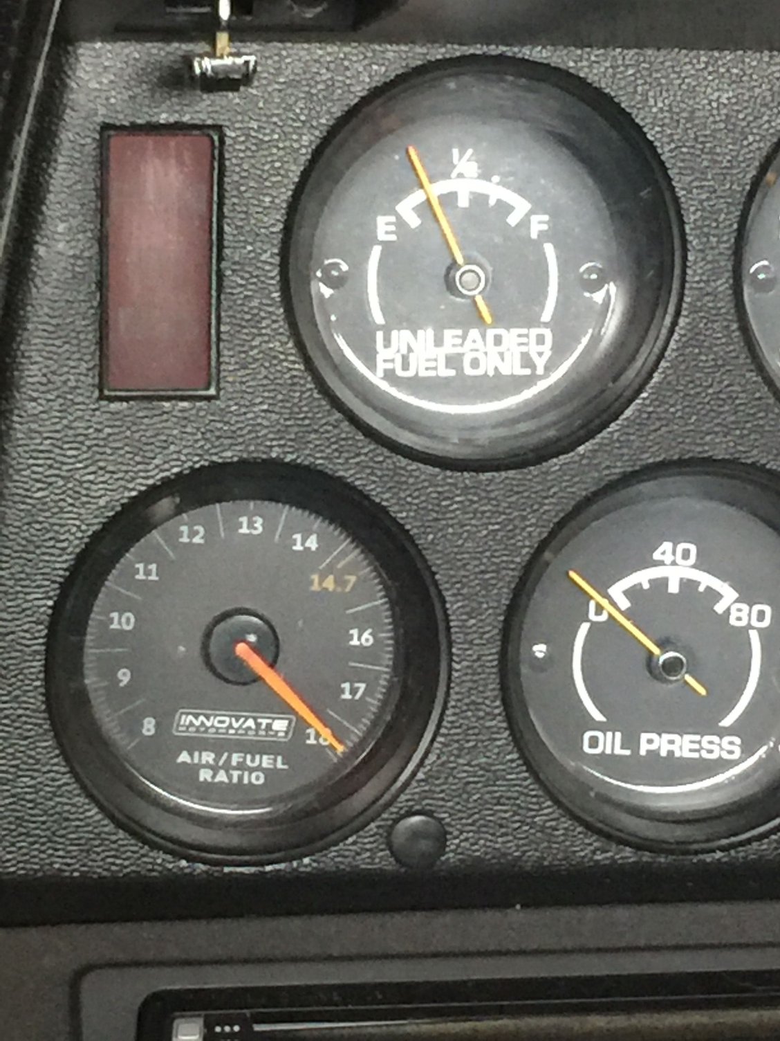

I have an O2 bung in each side. One O2 sensor goes to the EZ-EFI and the other side goes to an A/F gauge installed in the clock position.

I like the idea of using a stand-alone AFR gauge in place of the crappy clock for dual bank readings... I've been annoyed by Holley not supporting reading from 2 O2 sensors, even in the HP series and this is an interesting workaround I hadn't considered...
