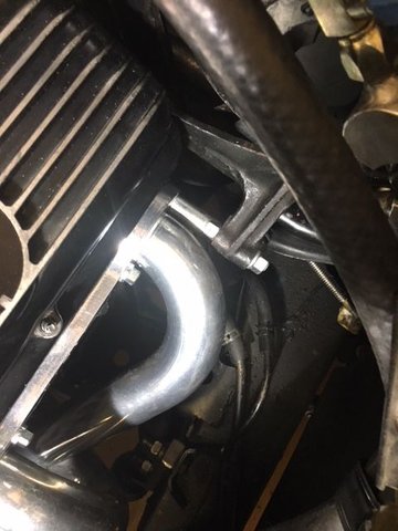

For the A/C bracket that would normally be bolted to the exhaust manifold, you might be able to re-use that one bolt. I believe it was close to two inches.
(Header bolts are around 3/4") I had a steel tube for a spacer and maybe the spacer was 1 3/4" long. Don't remember, my A/C is dismantled.

I purchased the bolt and spacer for my headers from Corvette Central for my AC bracket. Search for Air conditioning compressor mount bolt and for Air conditioning compressor bracket spacer. Cost will be less than $20.00 for both before shipping.
