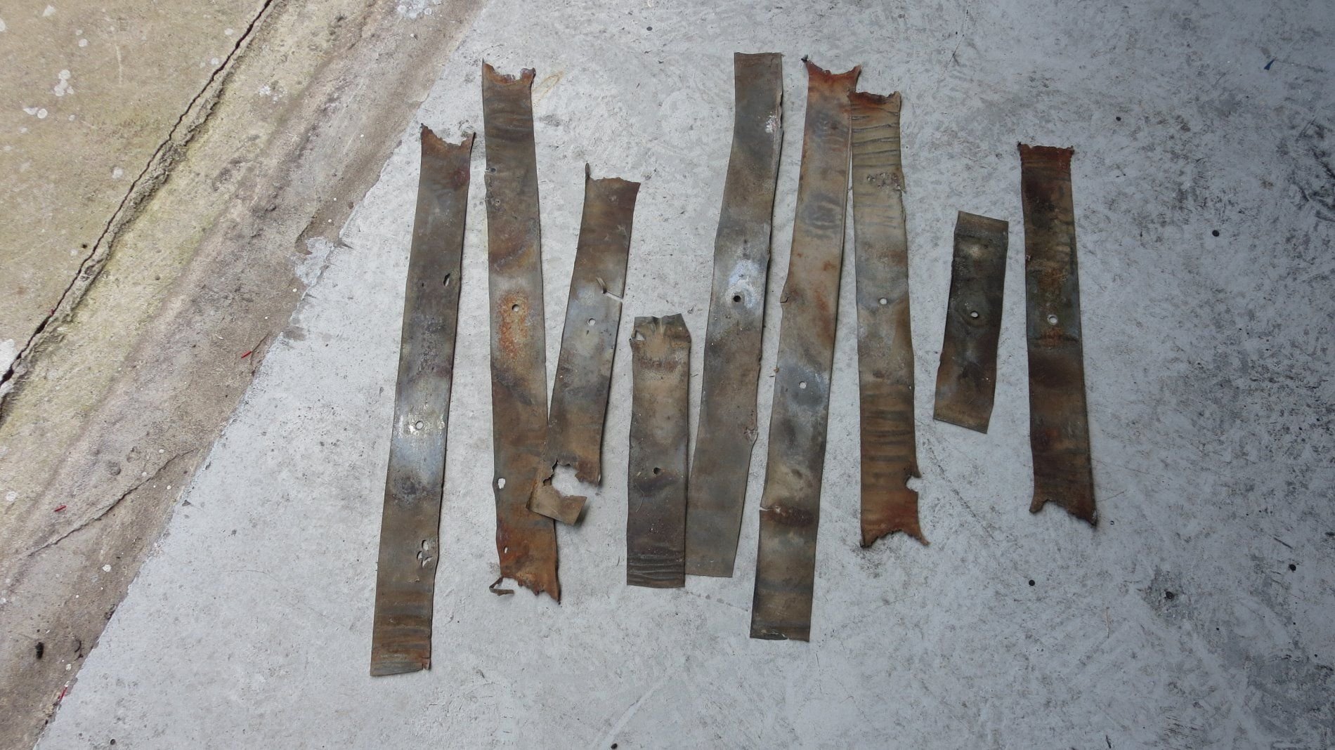

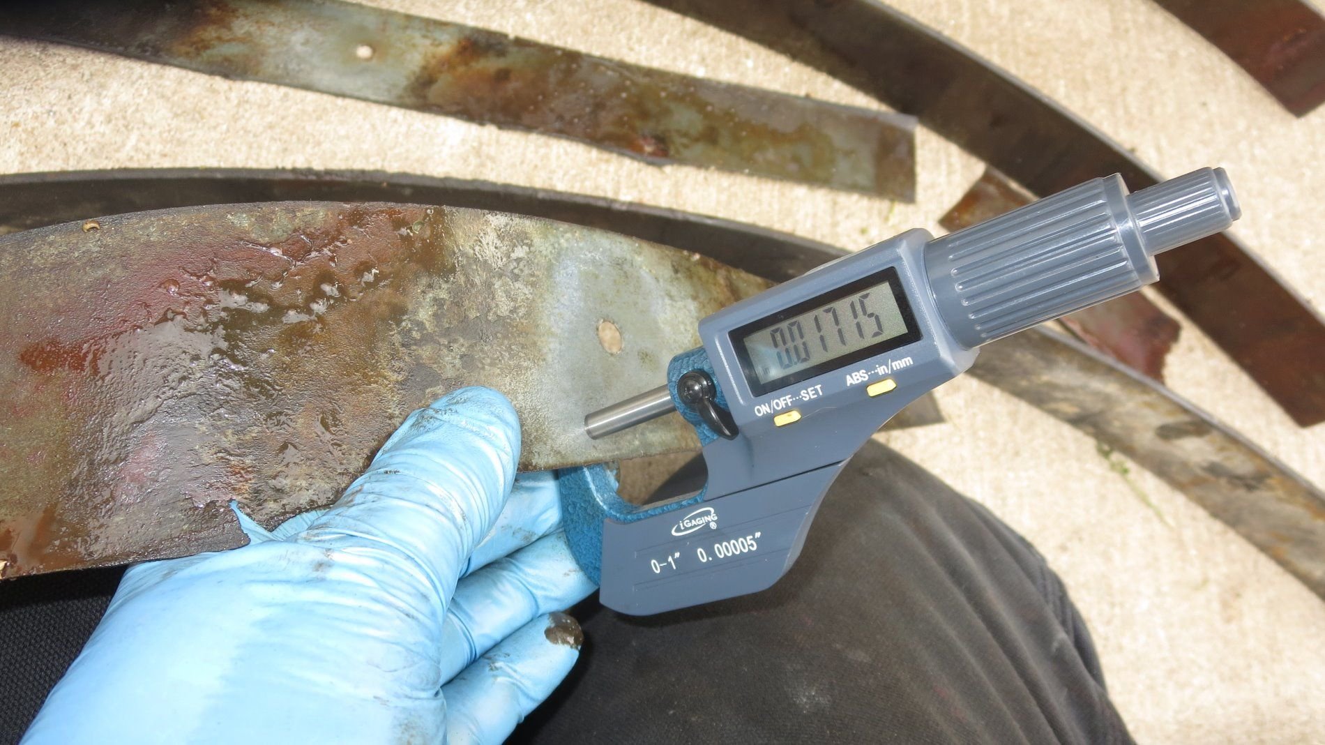

Ok, so I took the springs apart to see what was between them - it looks like some bubba took some snips and cut galvanized sheet metal and stuck them between the leafs. Is this right? Is the material between the leafs supposed to be metal? Metal thickness was 0.017"

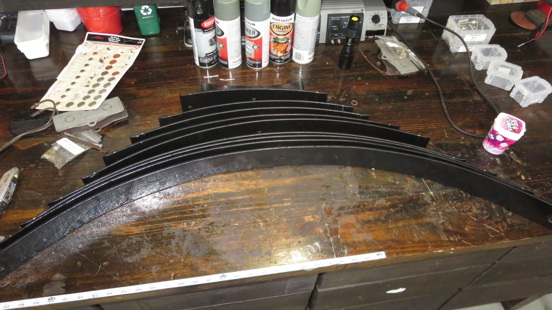

After sitting on this project for a while, I finally completed the refurbishment of the rear springs:

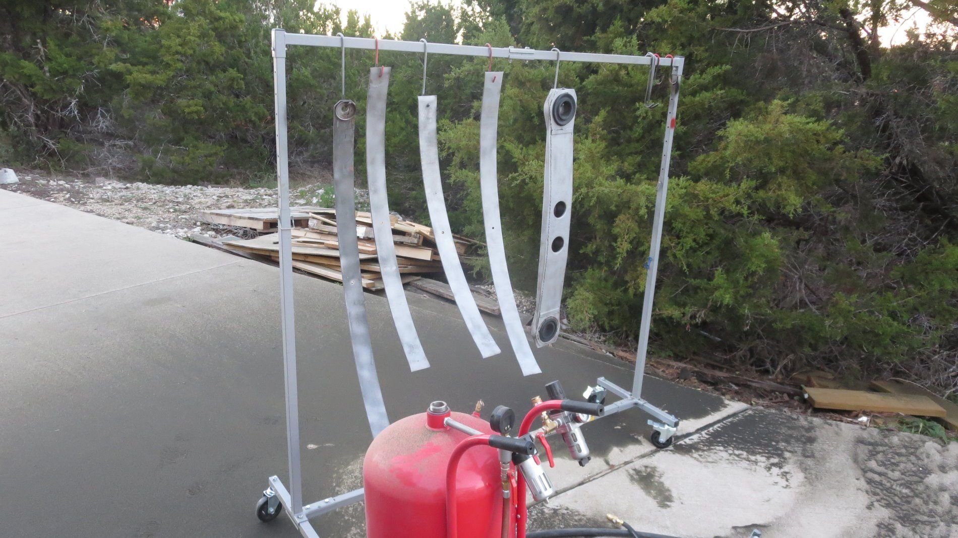

The smaller leafs I sandblasted in my cabinet. The larger ones I sandblasted them using a pressurized sandblaster
I coated all leaf springs with Ospho to stop any remaining rust and let it dry about 48 hours
Since I do not have a way to powder coat, I went with 3 coats of primer....
... and three coats of black, engine enamel paint
The old liners

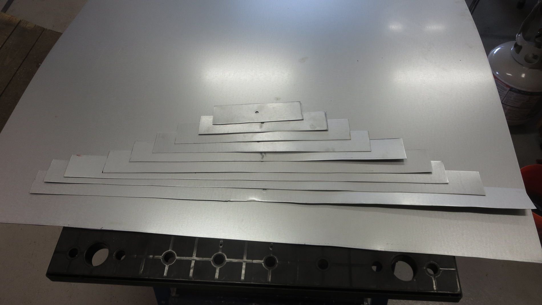

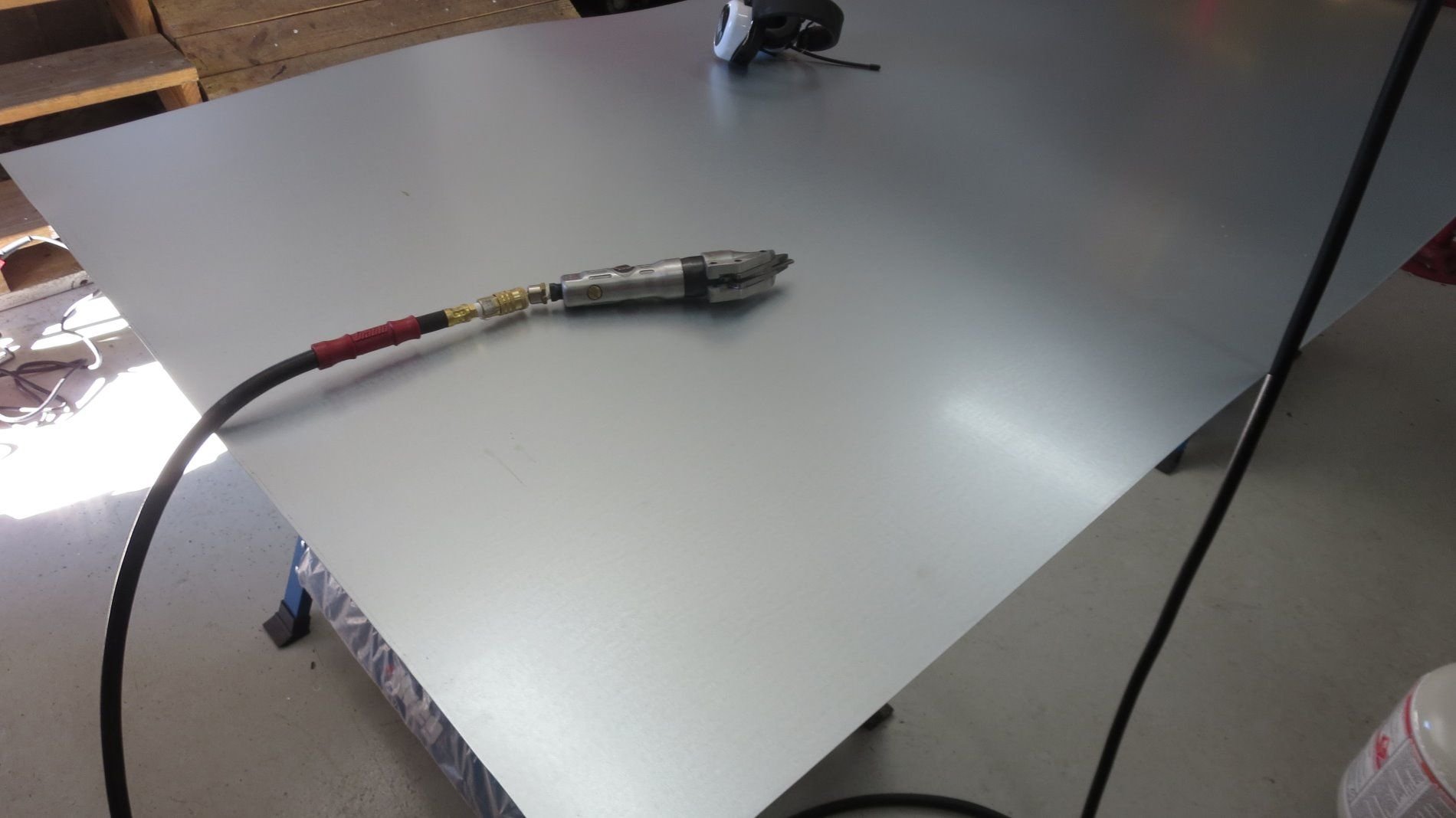

I went to my local metal purveyor and purchased a 24 gauge galvanized sheet. The minimum I could purchase was 12' x 4'. It was not that expensive plus I could use the rest for some other projects
Carefully measured and cut strips
Put everything back together!
