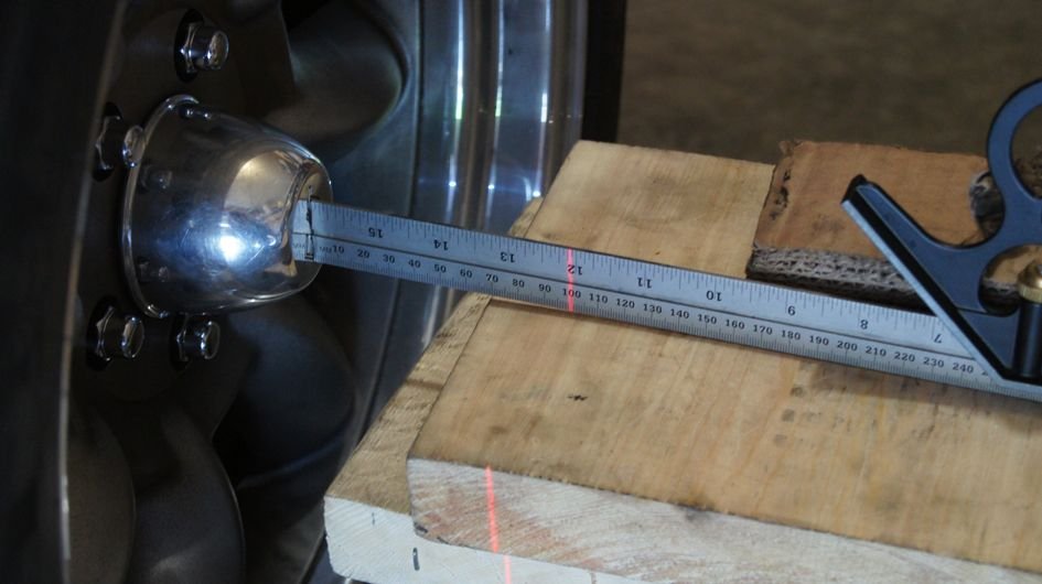

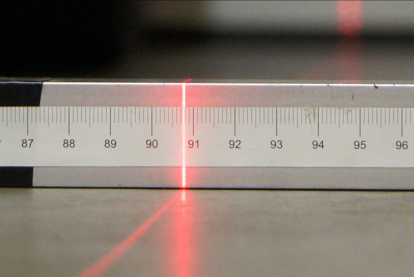

Here are the tools I use for DIY. Total time to take complete measurements is less than 10 minutes.
Camber / Caster
Toe Measurements.

You should charge for your alignments....I bet it works really well AND 10 minutes to boot LOL

Originally Posted by iwasmenowhesgone
Cagotzmann,
The pictures you attached show a bunch of equipment, and I understand how the caster / camber tool works, but your toe setup and pictures tells me nothing about how to do it your way. It appears you have a lazer sight and I suspect you are shooting it to these bars and measuring it.
This is the laser pointing to the measuring bar.
I measure the front distance vs the rear distance. eg total front measurement = 1875 mm ( I use metric since its much easier to using trig functions vs converting fractions to decimal) and to add simple measurement readings from above I would read as 907.5 or 908 its either 0.5 or 0 for me. This produces error of 0.01036 degree total toe error. you suspension settle is much higher than this.
Then mesure the rear distance.
In the picture I use equal length rulers to the front bar & rear bar are the same distance from the tire. Then I measure the distance between the bars eg (2764 mm)
eg front distance = 1875 mm
rear distance = 1880 mm ( total difference = 5 mm )
distance between the bars = 2764 mm
then the total toe angle = the tangent angle of 5/2764 = total toe = 0.1036 degrees
then use this https://robrobinette.com/ConvertToeDegreesToInches.htm
to convert to inches if you like. note the tire size effects this conversion.
Now for comparison using a sting method you would measure at the rim. Once you get a perfect box around the car ( very time consuming and impossible to repeat)
The best the human eye can read is ~ 1/32" ( is the measuring caliper touching the string or not )
on a 15" wheel ~ 16" measure distance @ 1/32" a single wheel you can measure tan (0.03125" / 16") tangent angle = 0.1119 degrees per wheel. that is 1.67 / 32nd per wheel. This is still acceptable but much more time consuming.
The larger the distance between the measuring points the more precise the measurement can be. So when I setup to measure toe it looks like this.
Just place the rulers under the tires and square the measuring bar to the rulers and the setup is 50 percent done.
Next pick one side and point the laster to the front and move the measuring bar to a exact number. ( doesn't matter what the number is let say is @ 100mm mark) then point the
laser to the rear bar, and again move the measuring bar to the "same number" 100mm mark. Now you are 75 percent done.
Next move the laser to the other side and take the readings.
eg pointing to the front = 1975mm
eg pointing to the rear = 1980mm
distance between bars = 2764mm
no calculator required difference = 5 mm then a little math you get the total toe.
then the total toe angle = the tangent angle of 5/2764 = total toe = 0.1036 degrees Once you do this often enough you realize that 5mm = 1/16" total toe
equal on both side = 0 total toe and a 5mm difference where the top measurement < rear measurement = 1/16" total toe out.
You can then make a simple chart calculating 1,2,3,4,5,6,7,8,9,10mm difference as a reference so no math is required when doing measurements.
This is very simple and not complicated less time consuming compared to using strings. The only thing you need to do when making actual adjustments for front toe is
center your steering wheel and set each wheel equal amounts from the rear axle. you don't care how much toe to set and only are concerned they are equal. Then adjust each sleeve equal until you get the total toe you want. After a test drive if the steering wheel is still not centered then you can again adjust each sleeve equal amounts ( one toe in vs one toe out to re center the wheel) once it drives nice you can again quickly re check the measurements.
My spreadsheet I use takes more variables such as laser error camber measurements tire size etc to make a perfect calculation but I have found the suspension moves enough that this simple method works very well. When I do my alignments for track days I set for 0 mm +- 2mm. Never use the spreadsheet again.
