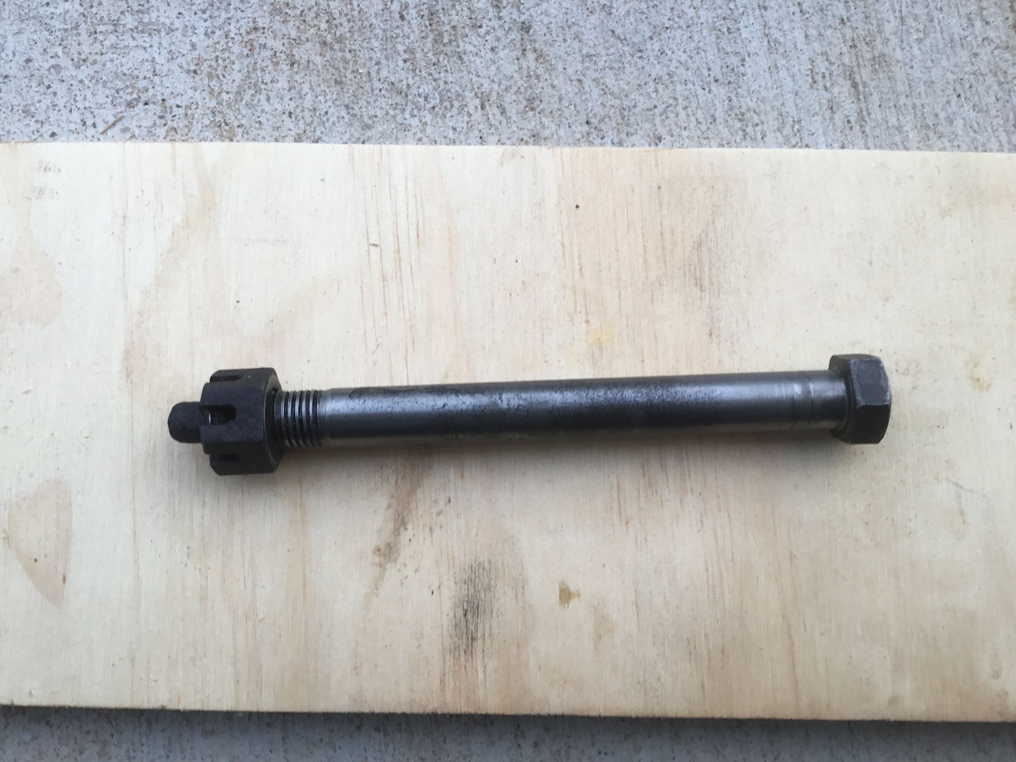

Follow up to differential front mount issues.
I received the new bracket and bolt kit in addition to the previously ordered front bushing. The failure in reference to the bracket is certainly due to the bolts not being properly tightened and torqued wherein the bracket was allowed to flex and move around. Though the nuts were cotter pinned they were barely tight, almost no effort at all to loosen. I have now replaced the bracket, bushings and all new bolts properly torqued per AIM and factory service manual specs. The bolts show significant wear and polishing due to the movement, bracket holes are also oversized.
I was able to replace all parts with the car on jack stands no problem. Even for an old dude! Thanks to all for the help.
