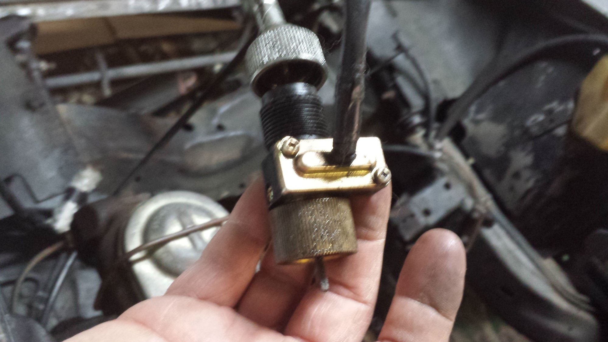

I have it figured out - Cruz control box, 2 pc cable. Its a 75 car, but as i have read they didn't start having cruz until 77. This car has been a mystery from day 1.
