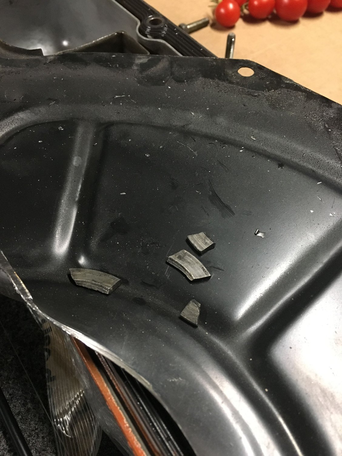

So last night I removed the bell housing cove and some how it was bent and rubbing on the flywheel. It seems the noise is gone. I have not started it but just cranked it over. I need to put the front on the engine back together. Crazy!! When I took it off 4 pieces of metal fell out. Could not determine where they are from, see pic. Anyone recognize. I check the starter and flywheel but no missing teeth

almost looks like pieces of the thrust bearing. But I don't see how they could make it out of the oil pan if that's what it was. Is that aluminum, or steel? See if you can pick it up with a magnet.

Those sure look like throw out bearing parts.

looks almost like the outer edge of the clutch plate but I cant tell if theres grooves in the pieces from the pic, I am assuming there was not a glaring problem with the trans which would be the case if it was the throw out bearing but I woulnt rule that out either, looking at the wear marks seems like it is the clutch plate but I would want to know if the clutch has ever been replaced if it wasn't centered properly but almost correct, there wouldn't of been an issue until it wore itself out. you should try to fit the pieces together and see if the grooves align or the pieces match, that can help narrow the issue as to whether its a housing mount or internal piece that broke. racking my brains I cant see why this would cause either dieseling or backfire. as for the dieseling it sounds now like a fuel quality or a plug / wire issue as you have inspected the timing and found that ok. dieseling is caused by unburnt fuel either through bad plugs / timing or carb too rich, take your time and inspect the plugs and as u do each cylinder check the plug wires with a voltmeter im betting that its a weak plug wire or broken plug allowing fuel to pass into the exhaust. if it isn't electrical then the carb might need to be rebuilt, but I would def check the electrical first.

Also, by piecing it together you will get an idea of the diameter. That could very well be pieces of the throwout bearing the flange that the fork either pushes on or that is behind the fork. Also, if steal it is probably a piece of the throwout bearing. If aluminum it could well be a bigger problem.
did not come out of oil pan, came out when the bell housing cover was removed, but I agree could be thrust bearing

could be the bearing but notice the metal fragments all inside the cover, looks like a shattered clutch more then a broken piece, if possible inspect the entire clutch although they tend to shatter into a zillion pieces I have seen them fragment

as mentioned above the pieces that do fit together appear to be about the diameter of a thrust bearing. Looks like I have another project.

If it was my problem engine, I would be dropping the oil pan, removed the starter before hand to serve two purposes, to see if the starter housing has cracked, may be that is where those four pieces of, look like case iron came from, and to make it easier to get at the right pan bolts.
Once the pan is off, crank motor to the # one/two crank throw is in the low position, grab on to each rod and try to move up or down, crack the rod bolts and remove in order to check out the condition of the bearings.
Before all of that, follow what one of the earlier posters suggested about pulling the valve covers to check for loose rocker adjusting nuts, rocker studs being pulled from heads and for broken valve springs.

Once again. Get a magnet. If you could pick the pieces up with a magnet, it's not thrust bearing, it's not piston, most likely at that point it would be throw out bearing. Or pieces of the clutch disc or pressure plate.

You don't need to tear the engine down, remove the pan etc because you found a chunk of something in the BELLHOUSING! You don't need to make more work for yourself listening to bad advice. You already tore into the front for nothing with the timing chain ordeal. You don't need to remove the valve covers now.
Slow down and analyze the situation, then proceed wisely and you will save yourself a lot of grief and money.

nod, multiple issues going on with the housing cover off you should be able to inspect most everything with a good light and mirror nothing from the engine would make it into the bellhousing cover without a ton of oil on the floor.
