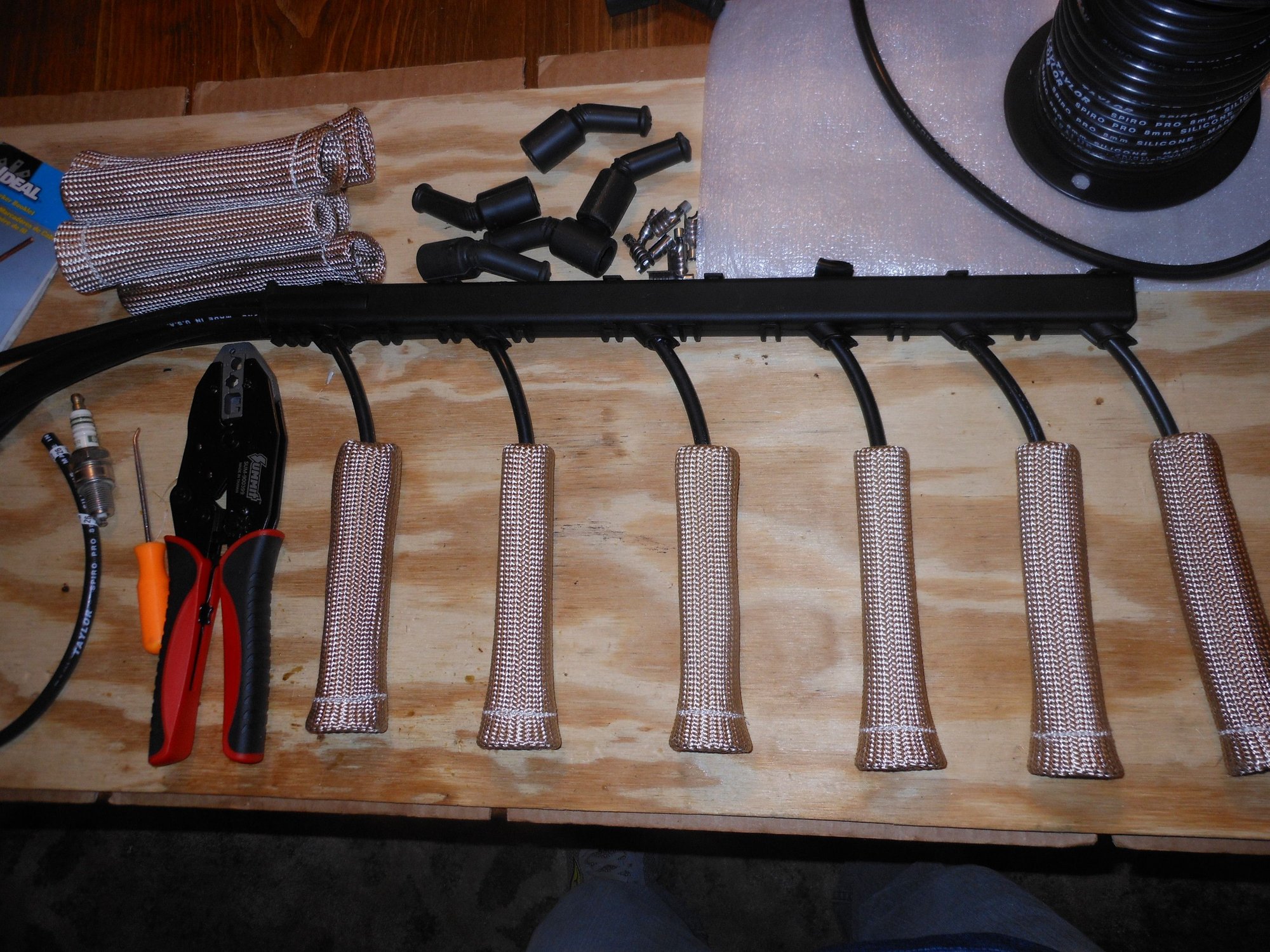

A nice sharp razor blade-palmolive dishwashing soap- an electrical wire numbering set (painters tape will work)- a sparkplug to make sure you get the boot placement correct and it's really easy.
I also ended up using the Lava boot covers- and since I am using LS coils mounted on the firewall- I prettied up the wire with a PET braided sleeving and a short piece of heat shrink
