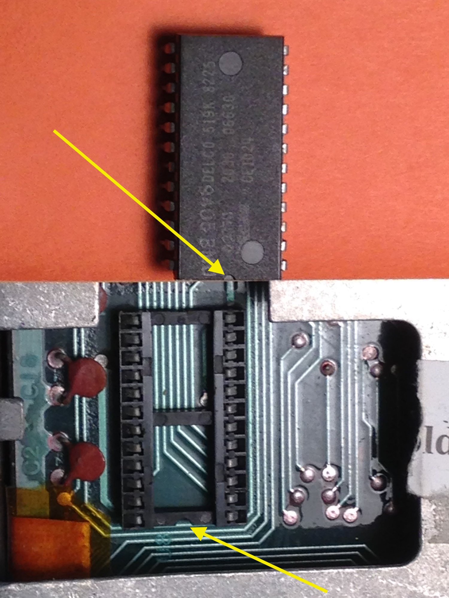

I have an 82 which has sat for several years. Cleaned tank and installed fuel pump and have it running. Good spray at the injectors, but poor drivability. Check Engine Light 12,12,12-51.51.51. Removed ECU and and EPROM cleaned all contact points as well as battery connections and junction box in battery compartment. But when looking at previous posts, the EPROM appeared to be in backwards. But when reversed, no codes- solid check engine light. Placed back as found and still 12,12,12-51,51,51. Manual says bad EPROM. When installing the EPROM, are the small cut in the EPROM supposed to match the cut in the holder as in the pic? If so, mine was in backwards! Might the ECU be bad also? THANKS for any suggestions.

There is no guarantees -- but putting the prom in backwards will usually not hurt the ECM -- it WILL kill the PROM. I am not sure of your theory that both the half moons should be together -- you really need to look in the service manual to assure that you put it in correct.

Yes, your orientation would be correct with the indents for the PROM and the fact that you put it in backwards and it didn't work means that you burned it up for sure and it will burn it up for sure every time you do that. The ECM board usually is fine and with the new chip, ensure you install it correctly and don't get the chip with the 160* stat feature, leave it at 195* or you may run into issues with a stock 82 CFI motor.

Got the new ECM and now have discovered the problem I had orienting the EPROM. My ECM did NOT have a "carrier" for the EPROM. The EPROM was installed directly on the ECM so it could go either way.. All instructions for the new EPROM install references placing the EPROM in the plastic carrier- then it can only be installed one way because of the shape of the access hole in the frame. It appears that the tiny indentions on the EPROM should NOT match the tiny indentions on the ECM. Anybody have a pic of the plastic carrier to verify this?
Thanks
Old Sep 20, 2018 | 01:07 PM
lionelhutz's Avatar
lionelhutz
Joined: Apr 2007
Posts: 11,150
Likes: 890
From: South Western Ontario
It's a universally accepted convention in electronics that the chip and socket notches match on DIP components, so it'd be really odd to have an application where they didn't.
The GM chip carriers I have seen for newer stuff have some kind of notch or variation that is on the same end as the notch in the chip.
If you want to measure, the pin on the bottom left should be 5V and the pin on the top right should be 0V. The voltage will be reversed if the socket notch was backwards. This reversing of the supply voltage to the chip is why it gets destroyed when it's reversed.
