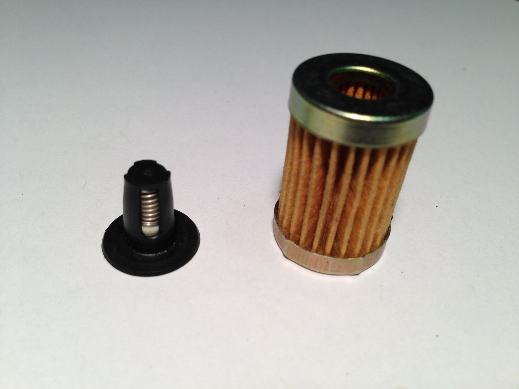

Those fuel filters with a check valve were/are sold by Napa and are a huge problem. With my 69 427 which is a bit of a fuel pig, if I stepped on it I could get through first and half way through second gear then ran out of gas. The only reason I found it was because it was ok before I replaced the filter with the junk pictured below. The jacket around the ball and spring is swollen out and it prevents movement plus the ball creates a big obstruction even if it was free to move. That filter is below and has the check valve removed for the pic. There is less than 100 miles on it....
Also, as 7T1 says above, make sure the filter is installed with the opening or inlet hole facing out of the carb towards the fuel line as that will make it even worse if reversed.
