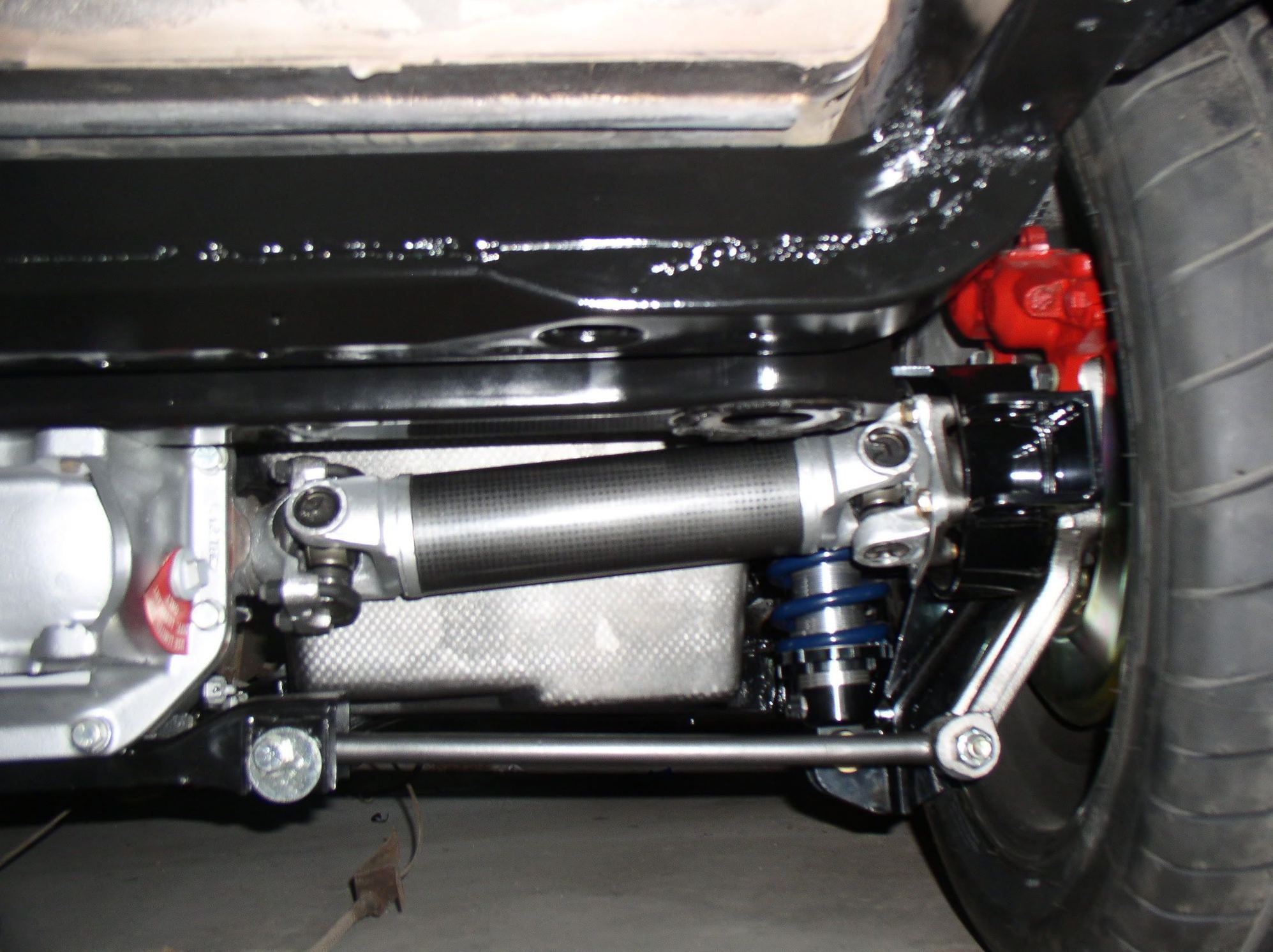

I bought the Vansteel set-up- as those guys have been doing suspensions for Vettes the longest- seem to know what they are talking about- have a great reputation...
PLUS- cost wise it made sense to me- as I needed a trailing arm- as one of mine was bent.
So for $1300 INCLUDING a set of new trailing arms- that had the parking brake mount relocated and are offset
BTW- the sharkbites don't come with trailing arms and are a few hundred bucks more...

hey Richard, is your rear end lowered about 1.5"?

Notice the coils are ALL the way down- plus there was no weight in the car at the time-had just put it together.. So yes-but the haftshafts need to be level.
I've got the Vansteel delrin bushings to raise the diff-not on yet-
http://www.vansteel.com/index.cfm?fu...owItem&ID=3904
Here's another way to raise the diff -to lower the rear and keep half shaft geometry correct
https://www.corvetteforum.com/forums...-bushings.html

thats an insane amount of $ for trailing arms, guess you pay to own one.
Not understanding how that Shark Bite system works, the shocks almost move laterally? do the outside mounts move around, any better pics.
hehehehehe you knew why I asked :P I was wondering
