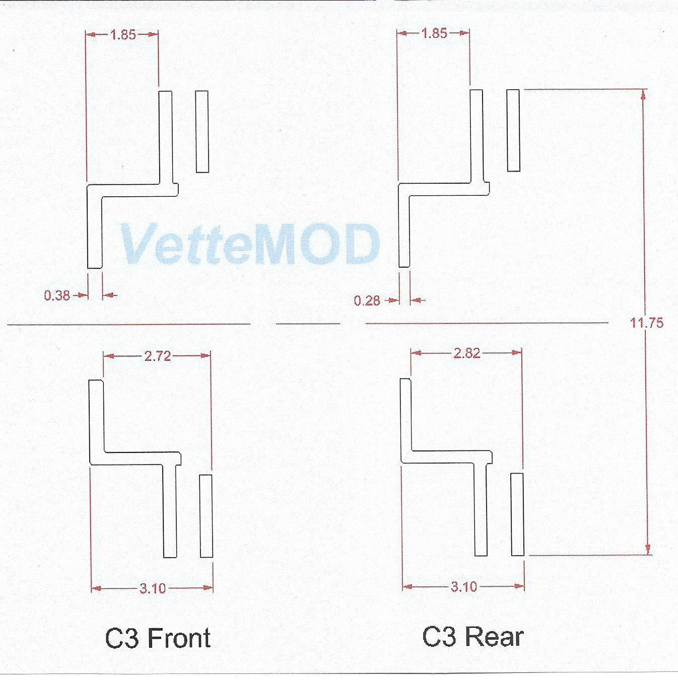

I'm not sure what the problem is but remove the washers that you put between the rotor and rim as that's not safe.
Rotor size inside the hat is different front to rear.
Thanks for the measurements...yes washers were just temporary to see if the issue went away. Thanks!
