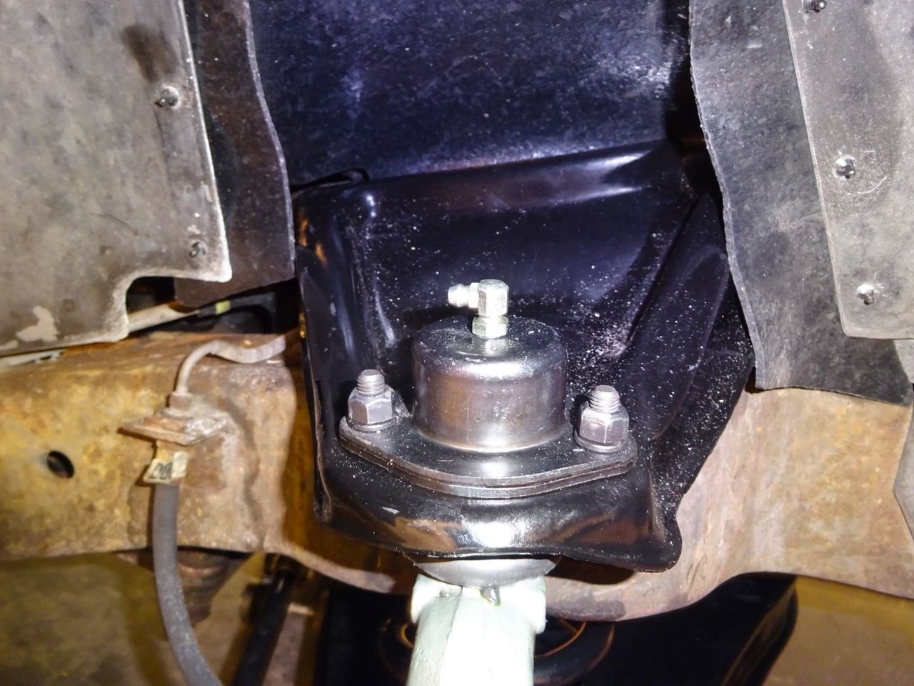

This is a photo of the RHS if it helps.

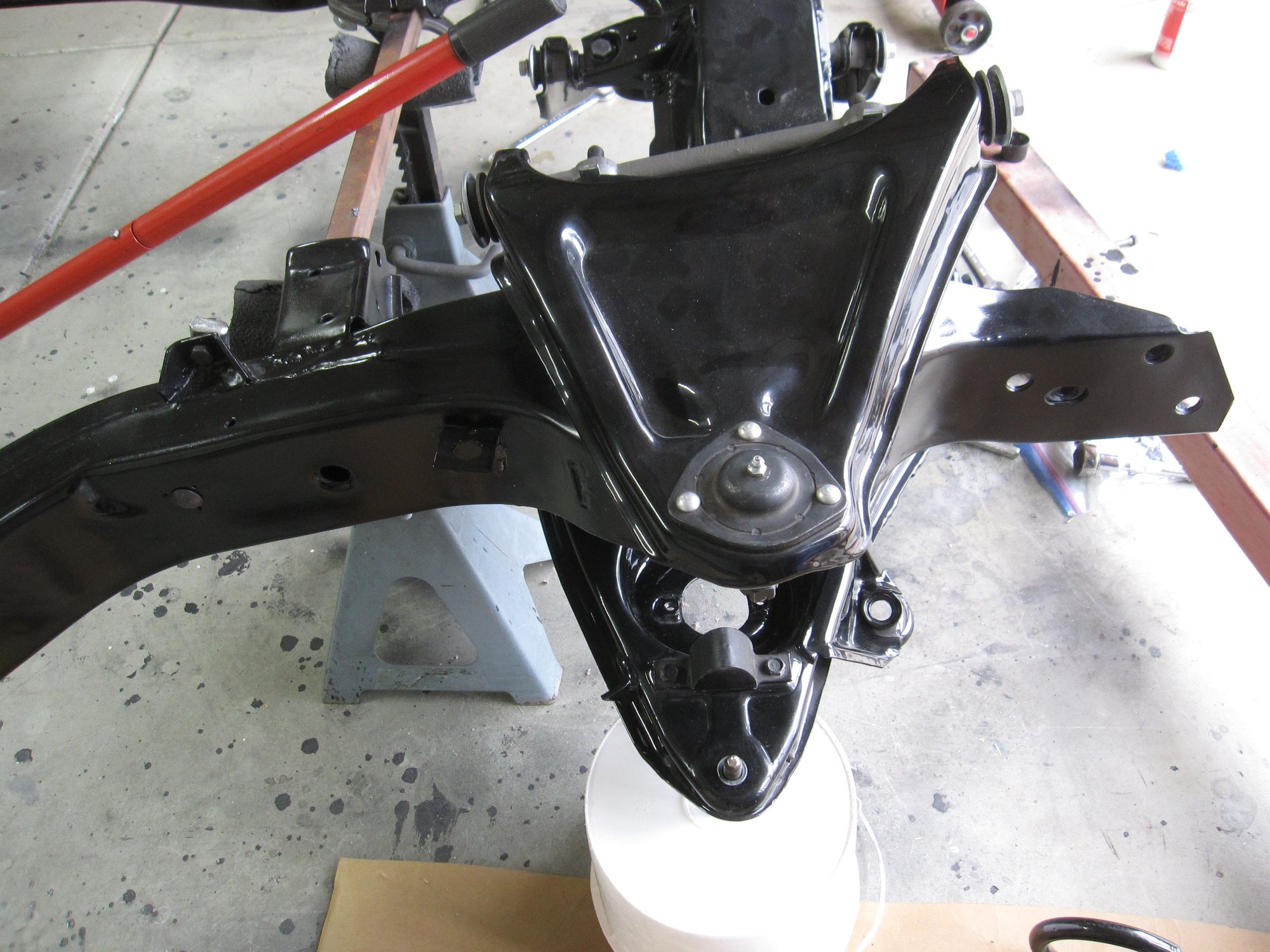

This is how I have them is this correct

Looks like it.

I switched them around and it was definitely not right so I had them right the first time.
