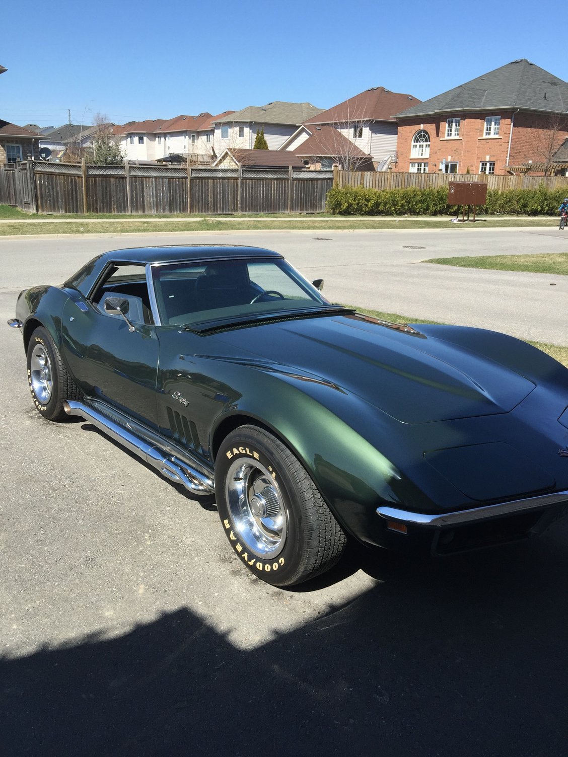

Old Dec 14, 2018 | 05:10 PM
DUB's Avatar
DUB
Joined: Apr 2009
Posts: 19,294
Likes: 2,754
From: Charlotte NC
Very nice looking car. I always like dark green cars.
