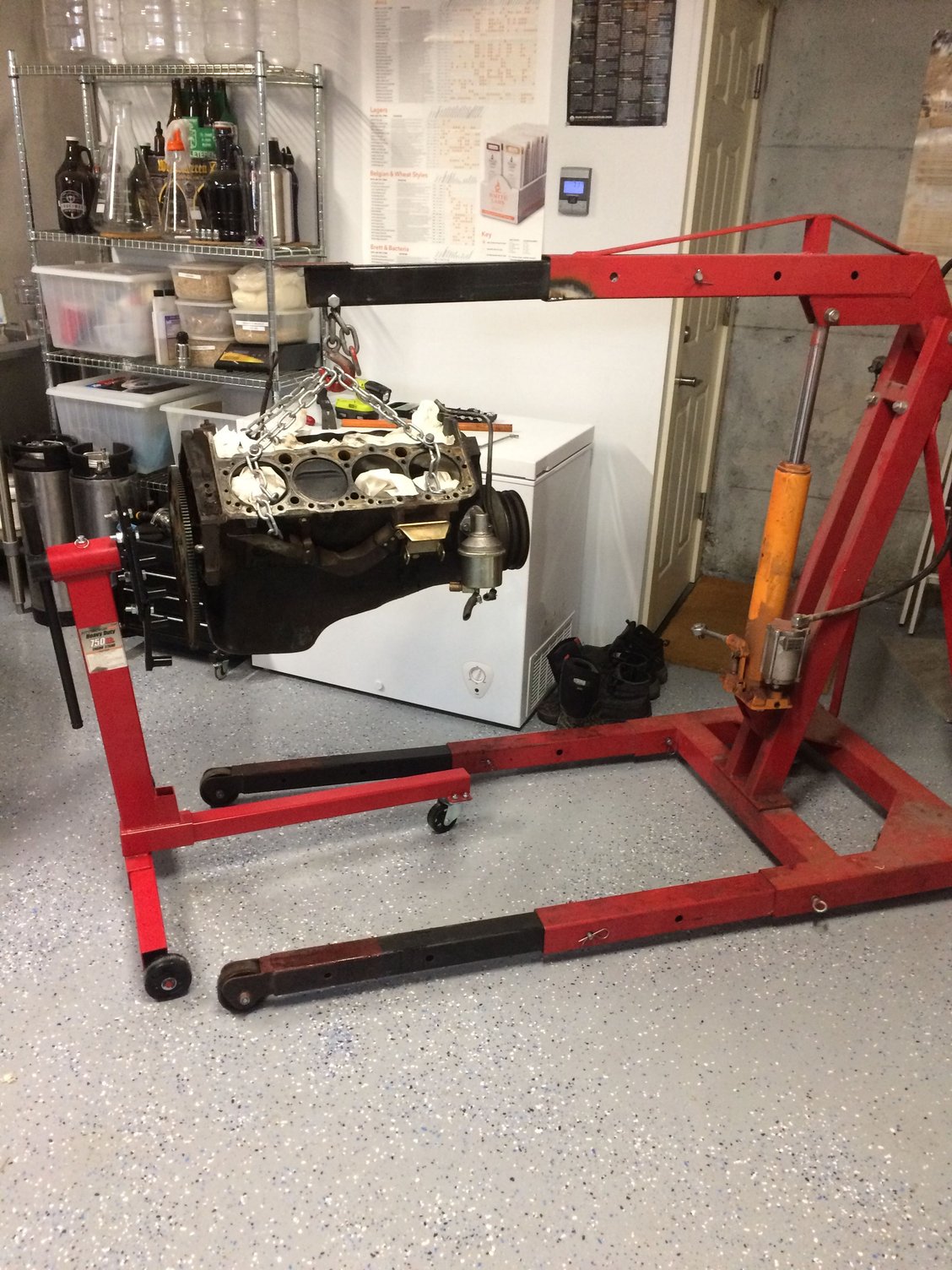

Someone asked for pictures; I only took one. (I was on a time crunch to get the borrowed hoist back to its owner.)
​​​​​​​Adam
