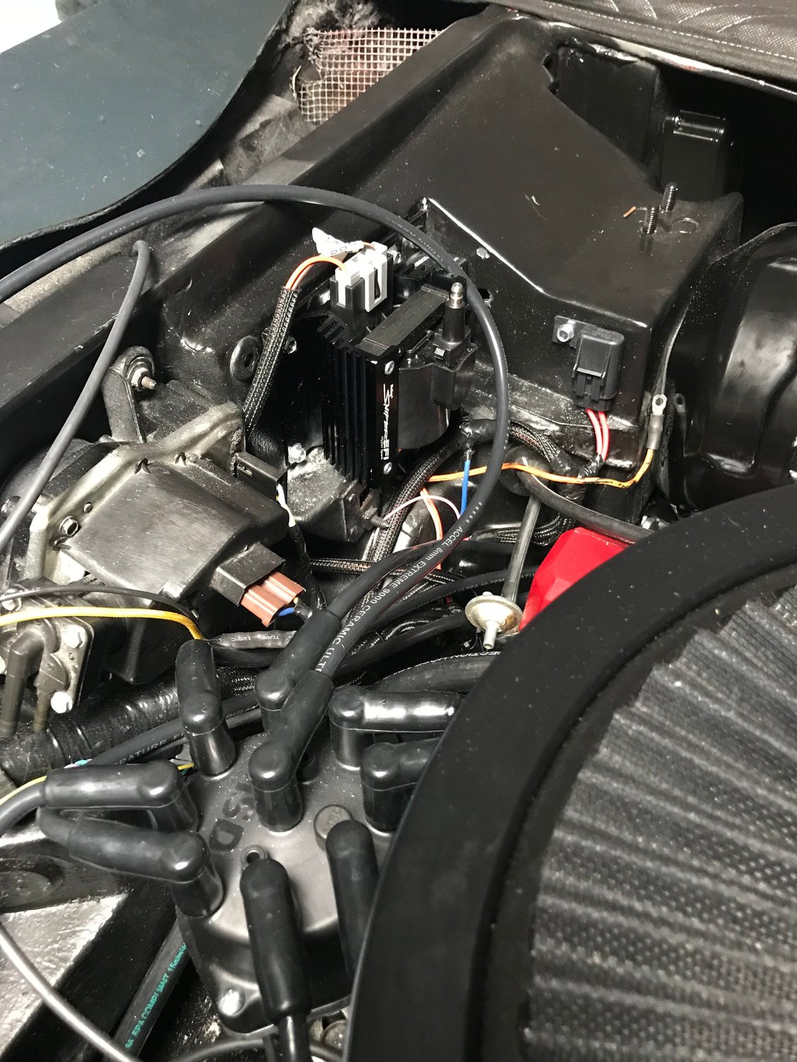

Anyone got a good idea where to mount the coil? Here’s where I have It so far but I’m not sure I like
It there

That's where mine is mounted. There aren't many options.

Anyone got a good idea where to mount the coil? Here’s where I have It so far but I’m not sure I like It there
That looks like a good fit. As mentioned, not much room under the hoods. Where did you end up putting the Hyperspark module itself ?
I mounted it on the driver side firewall in the fender. You can drill some holes and are able to reach in there to tighten the nuts from the wiper compartment. I did Have to get longer screws though. I trying To decide where I’m going to mount the relays and extra fuse box... might be right under the module.

Quick update, I ended up mounting the coil in the same spot as @Johnnypegs, and the multi spark box on the passenger fender. I will post some pics when done. Unfortunately, my setup was missing a critical harness plug that connects the distributor to the Sniper. So , couldn't test fire. I called Holley support this morning and they're shipping a replacement out. I have to say, that clear cap they use for aligning the distributor is very slick ! Very simple to do. The hardest part of this entire install is the tight clearances we have to deal with for getting all the wiring done. I do think that if i had over the valve cover plug wires, this would have been nearly impossible. At least going around the back of the engine then under the headers freed up a lot of space for the wiring. Also the way smaller distributor cap makes for a lot more working room. Oh, and making your own coil wire ! Wow, that was tough getting the wire through the 90 degree boot !

One bit of advise that stumped me for a bit. There is a 7 pin and a 10 pin harness. On the 7 pin harness, the yellow lead connects to the coil negative on the HEI distributor. With the Hyperspark, that gets removed completely and goes unused. The 10 pin has only 2 leads that get used (for my setup, i have a seperate electric fan controller). The Brown lead which will go to the coil negative lead and will drive your factory tach, and the white lead which goes to the white lead on the multi spark box. That will leave a whole bunch of unused wires on the 10 pin harness all of which can pickup RFI noise. A company called EFI System Pros sells a Sniper spare wire removal kit that will include a tool to remove the wires from the harness and rubber plugs to seal it off. I highly recommend buying it. It's only $20 and will clean up your wiring and reduce the risk of RFI.
Also, not saying this will be an issue for you, but if you get some weird stuff with your IAC, i ended up having to replace my alternator due to some weird RFI coming into my sniper system. I replaced it with a Tuff Stuff 140 amp and have been golden since ! What made me suspect it was while riding in a parade (lots of idle time), i noticed on the sniper handheld screen my voltage would occasionally drop to 10 and 11 volts. That issue and IAC weirdness are now gone !
