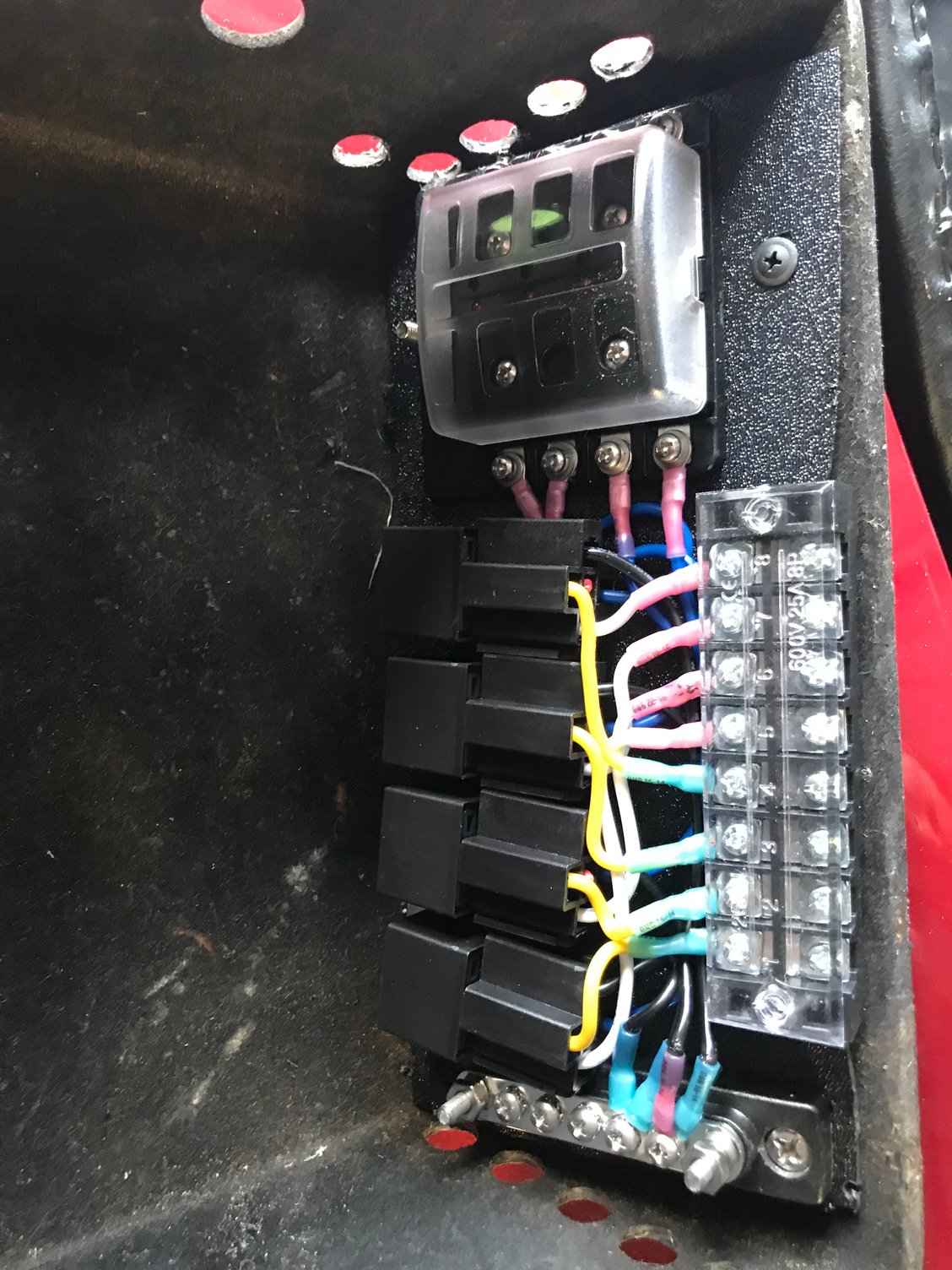

Originally Posted by Johnnypegs
Gives me multiple grounds, switches and positive hook ups with only one wire to the battery
What i have done so far is build a fuse panel for all the hook ups to plug into instead of run a bunch of wires to the battery. The one Thing I havent Been able to figure out a good location for the coil either.. it’s a little bulky. Any ideas?
Where did you get the fuse boxes and buss bar?
JIM

Originally Posted by Darinm
I used a similar concept but with a store bought fuse block. It's currently on the drivers side inner fender, but now that my fuel pressure regulator is gone from the passenger side inner fender, i'm thinking about relocating it there.
How about these? Where do you get them? Nice and clean...
JIM
JIM
Bass pro shop. It's meant for marine applications. Still 12 volts though, just not on a boat.

Johnnypegs's Avatar
Johnnypegs
Joined: Mar 2017
Posts: 250
Likes: 20
From: Boca Raton Florida
I got All of my stuff on amazon. I ended Up mounting the whole unit near the battery in one of the 3 compartments. There’s a good video on YouTube about how to set it all up and wire it. I can Link it if you want.
