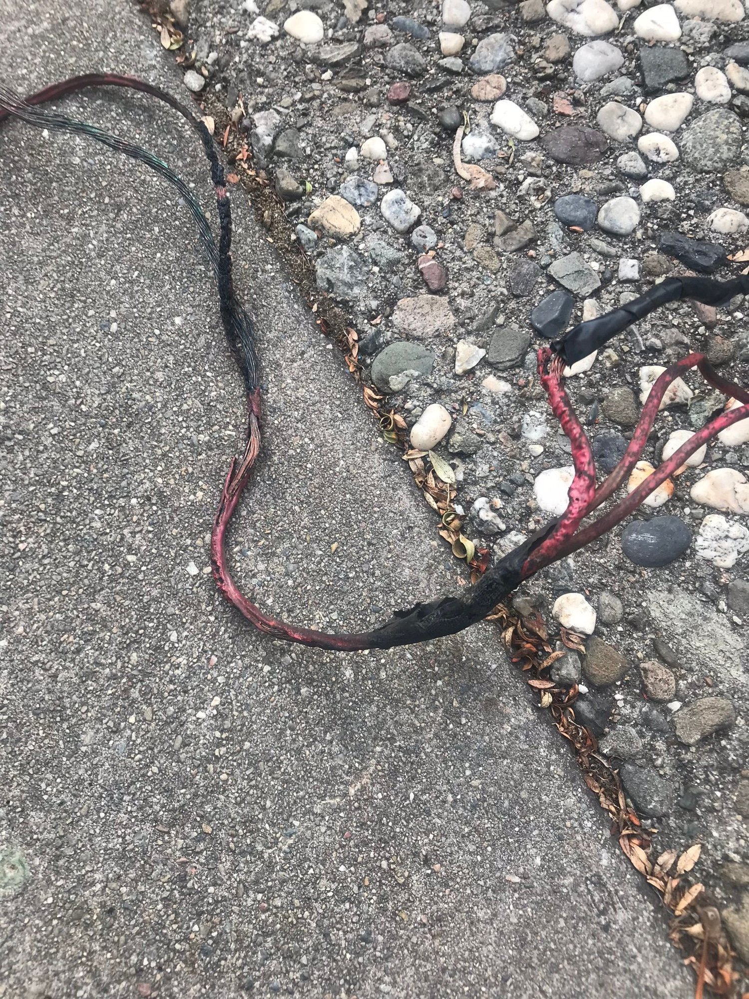

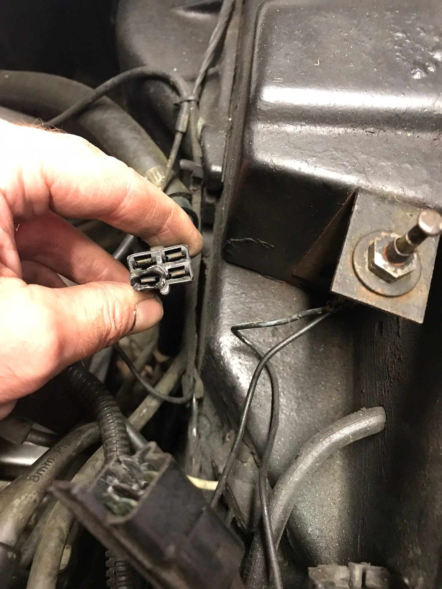

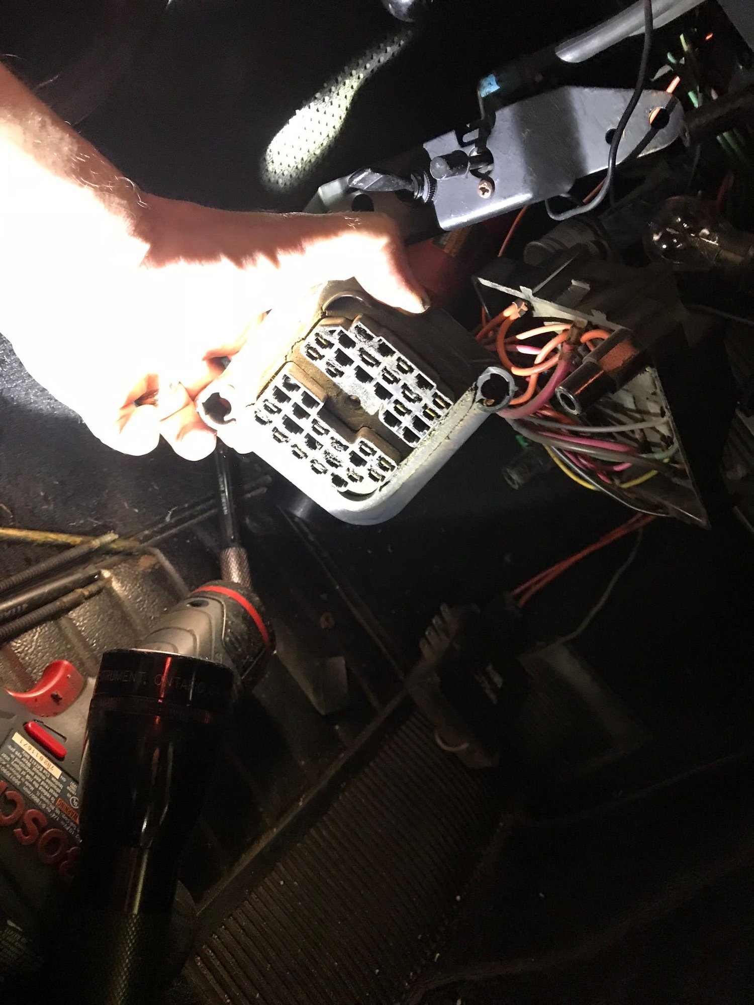

I bought my c3 not running with the starter circuit melted. After replacing the melted portion of the harness with new harness I had to plug and unplug the bulk head connector a few times to get it to seat correctly. This involves carefully tighteng the bolt at the center of the connector that holds the large connector to the firewall. Pic shows how the inner portion of the firewall connector can be removed for repairs to back of fuse box area ( probably not needed in your case)
I do recomend cleaning and re seating the 4 pin plug that is part of the harness that runs along top of firewall from brake booster area to blower fan area. My 4 pin connector was badly melted and needed to be replaced. Both connectors could be high resistance voltage drops.
In my case the wiring apparently melted when previous owner held key to start for a prolonged period of time. There are fusible links a few inches from the starter that had been replaced with regular wire sometime before causing the total meltdown.

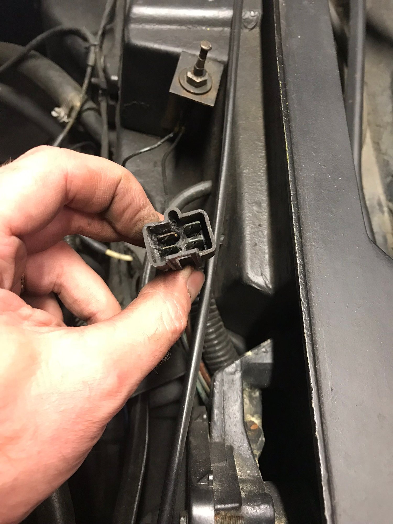

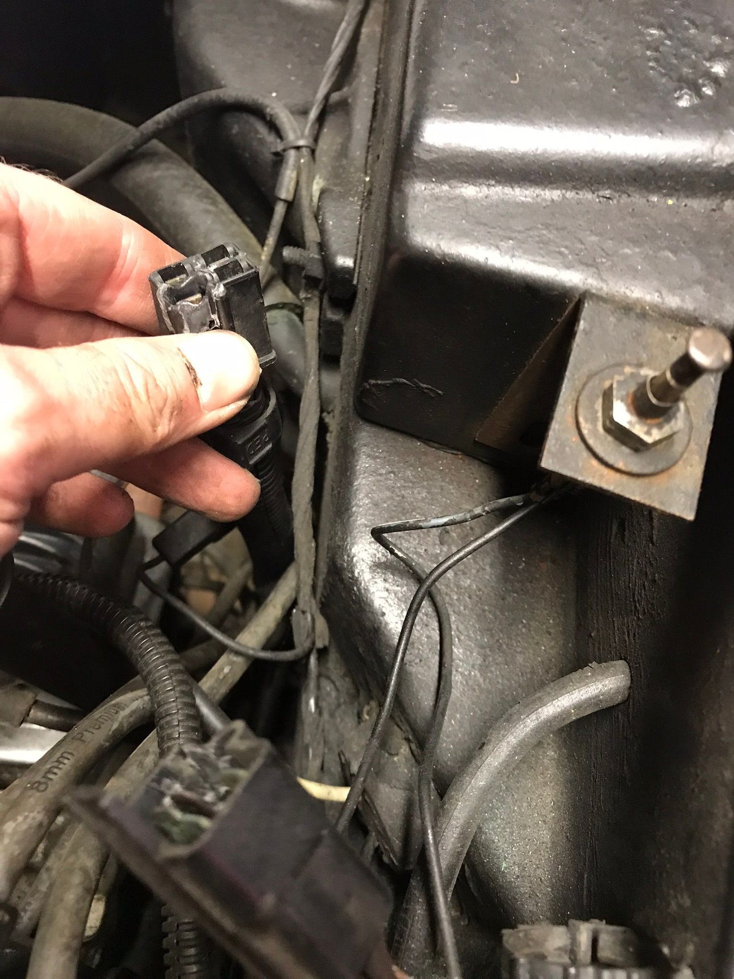

The 4 pin plug contains the starter solenoid wire.
Checking the 4 pin first makes sense because it is so much easier to get to than the firewall main harness connector. You will see the 4 pin plug sitting close to firewall and wiper motor .

Pics show my 77. Didnt realize your car has different wiring. Sorry for disapointing advice.
