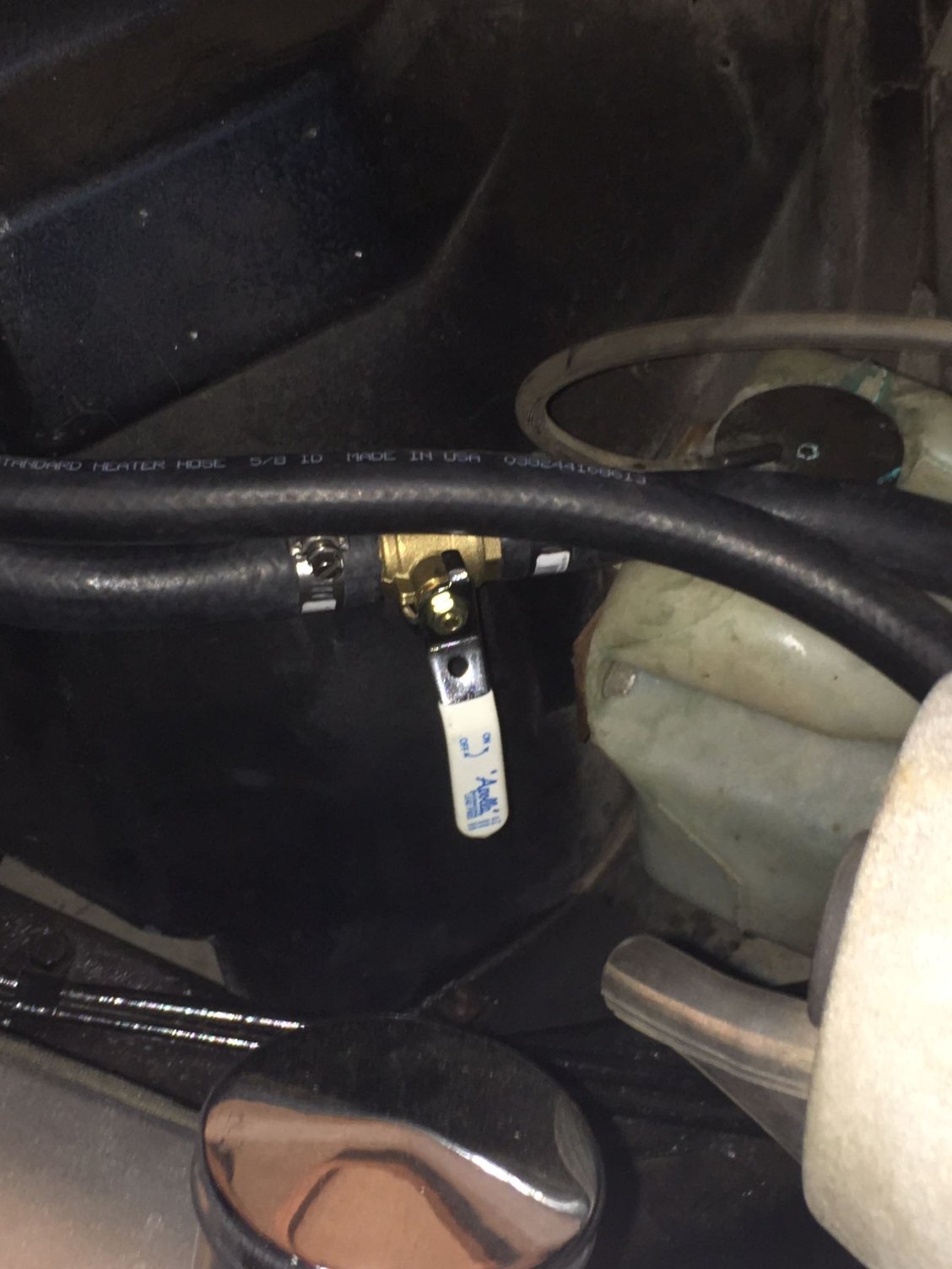

You can install a simple valve on the 3/4" hose that goes into the heater core, and shut it off for summer. Works excellent and made a huge difference in reducing my interior heat. Anytime it gets cool or rainy and you need heat or defrost, just turn it open and presto.

I like that kind of shut off valve but I would like to attach it directly to the manifold or water pump, what size adaptor would I need and where can I buy one?

From: Minnesota
I bought this one at a local home center, and it had the hose barbs on it already. You can buy threaded versions, I'm sure, and will need to find the appropriate fittings on your own to plumb it to the pump or intake. I put it in the hose as it hides away nicely along the side of the engine compartment.

Likes: 1,560
From: mount holly NC
Thanks for the reply. I have the same shut-off valve installed in the same place, I also have one on the 5/8" hose and just thought that it would look better and be more convenient to get a nipple that would screw into the intake and water pump and be barbed on the hose end so I wanted to know what size the threaded end is.
I've been told I only need one valve but since I have two I'd like to continue to use both.

you should only use one shut off valve.
In theory if both hoses are shut off pressure could build in the heater core and cause it to rupture due to over pressure or vacuum. Water does expand and contract with temperature change.

The pressure is a result of the water expanding / contracting.
If it's 60 degrees when you close the 2 valves and the car sits in the sun at the beach it's now 150+ degrees in the car. The heater water will expand and pressurize the water - maybe to the point of damaging the core.
The opposite can also happen - close the valve when you remember, engine running and hot - hot water 160 - 180 degrees. Let the car sit and it's now 45 degrees out - there is a vacuum (- pressure) in the core - which it was never designed for.
Does it fail ? it's a real possibility.
Plus you have stale fluid in the core for how ever long the valves are closed. With one valve there is some exchange of fluid due to the change in pressure, (controlled by the rad cap) even though there is no flow through.

I placed mine on the hose near the tire well, if you put it on the manifold you will need to check your hood clearance and also trim down the handle. on the hose it is neatly tucked away out of sight and a little more astetic.

Hi, garretthes,
I'm sure that by now you understand that the quickest way to eliminate cabin heat is to install one shutoff valve on either heater hose, as illustrated by JoeMinnesota.
Also, follow the information that DUB offered as he is an expert and restores Corvette's for a living.
Blue 72,
Yes, I do have two shutoff valves but I am not sold on your theory about expansion and contraction having a negative effect on the core. Both valves have been installed since 7-29-2008 and the core has not leaked.
I can remove both the water pump and manifold nipples and get the correct diameter and thread size but it would be easier to have the new nipples on hand at the start of the job so that is why I asked if someone knew the size.
