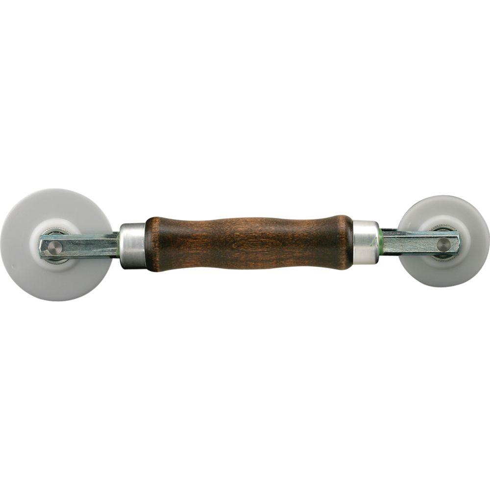

This tool helps a lot:
That tool is a good one, it's used to put screen's in screen doors... Another tool that works good to get the top beading of the top into the rear bow is a small staple puller. They generally have a bend to them and allow you to seat the top in the rear bow and then you can push it in place because of the bend.
Maybe Al changed to wd40 over the years but I was trained to use regular oil.... either would probably work just as good. Years ago we took a large flat blade screw driver and cut a U in the end of it for pushing in the hold in cord... it's kind of a 1 off, but it works great..
