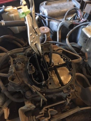

Little update, just because.
Car is home in the garage. Went to pull the carb, and the fuel line is stuck in the flare nut. go to loosen flare nut, whole hose twists.
Hit things with kroil, let sit overnight. now the flare nut and fuel filter turn real easy, but line still twists (still stuck in the flare nut).
more spray, some rap rap rap with a brass gunsmith hammer, let's see where we go.
pics just because. had to rig the choke a bit to get it backed into the garage.

Looks like a nice original carb in need of rebuild. It can be set up to run very well. Good luck with the process. If you have guy who knows how to set them up, that's great - let me know if I can assist.
Lars

and it's off.

It definitely has some problems, but looks like a good, original, rebuildable carb that will run great once correctly rebuilt and set up.
Lars
