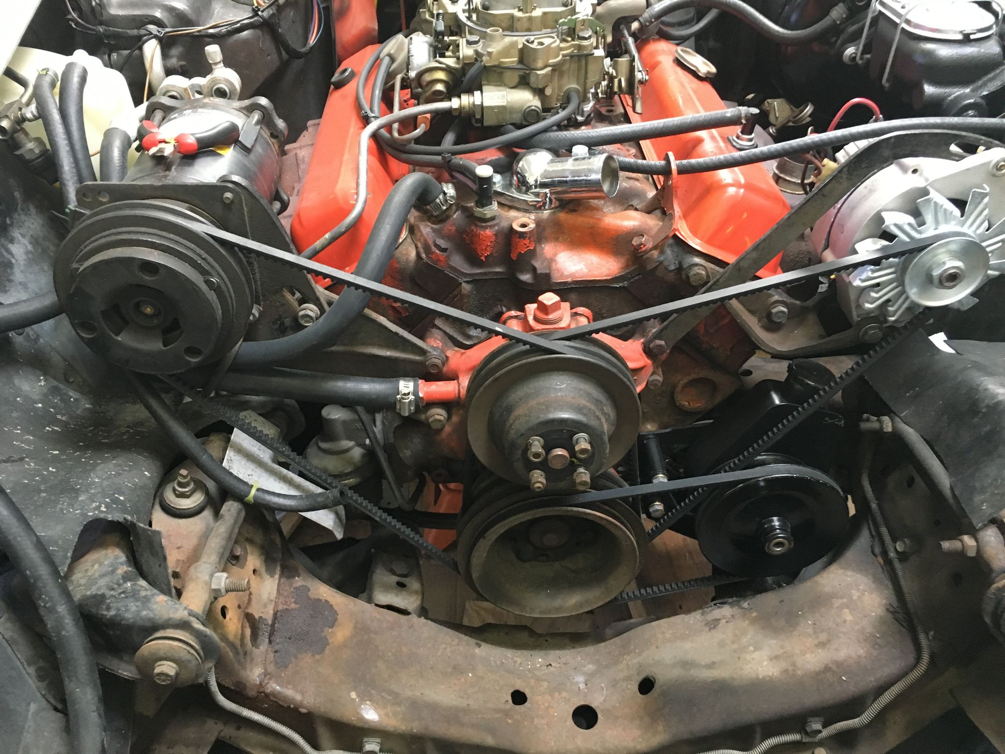

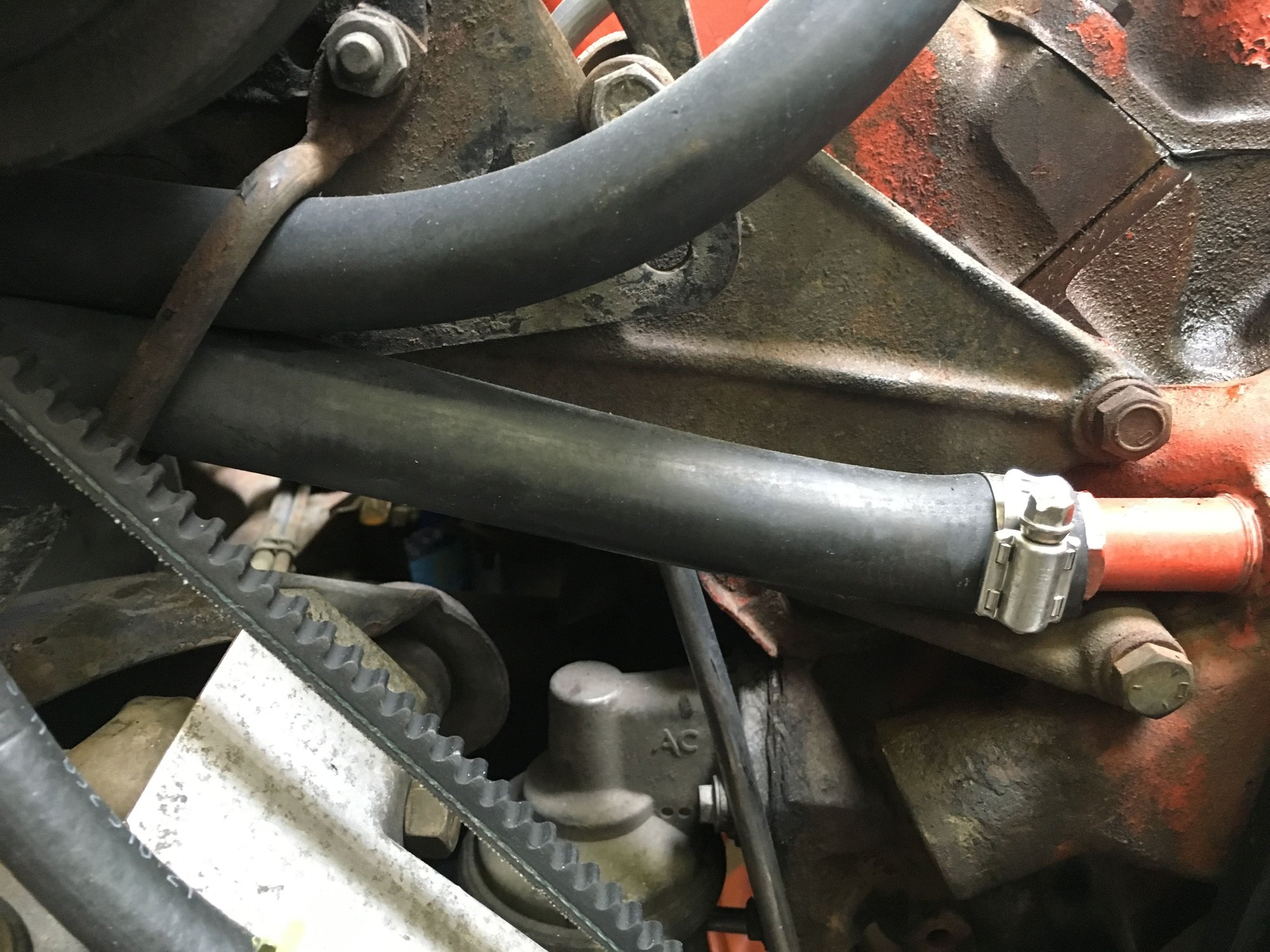

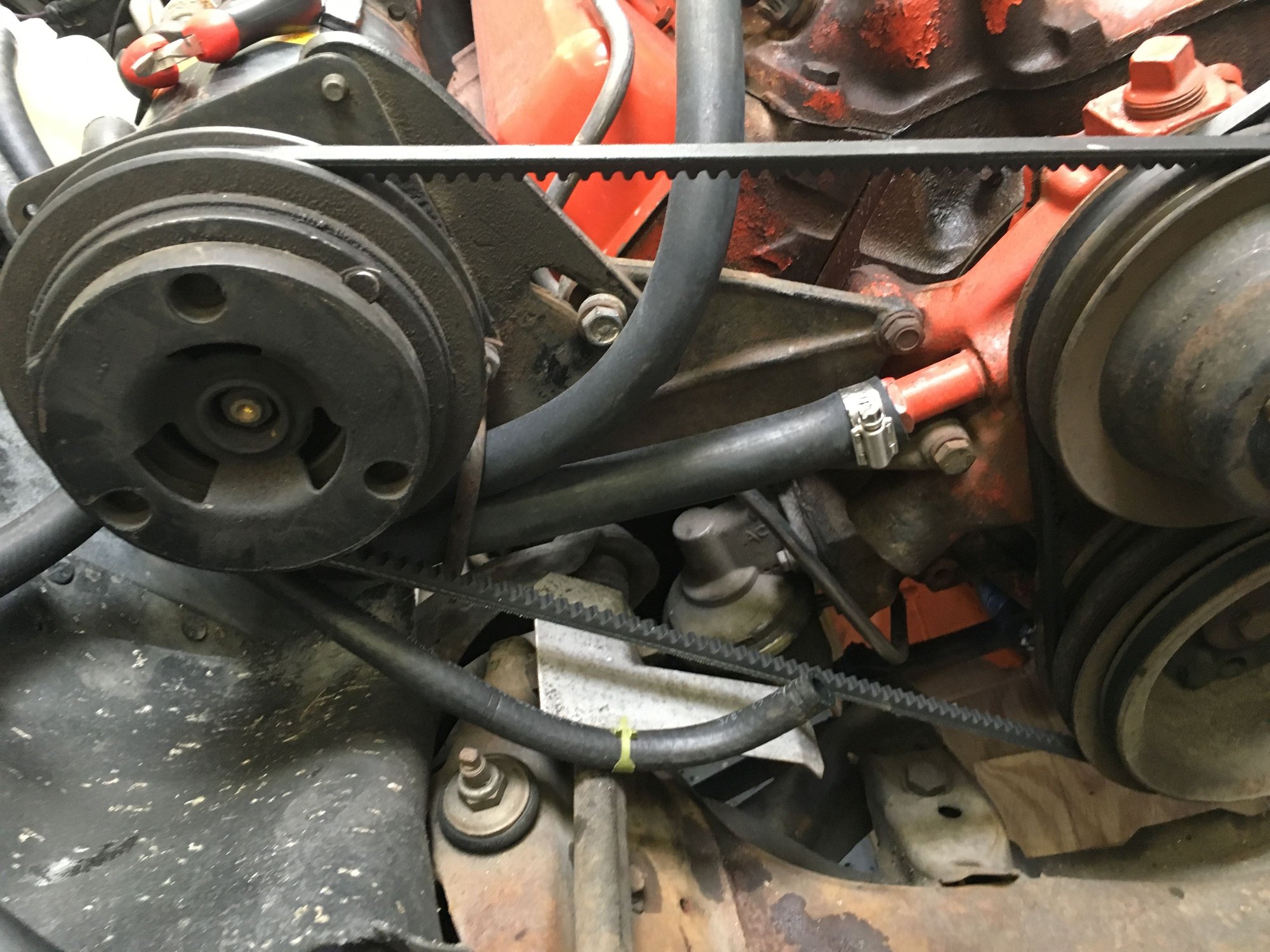

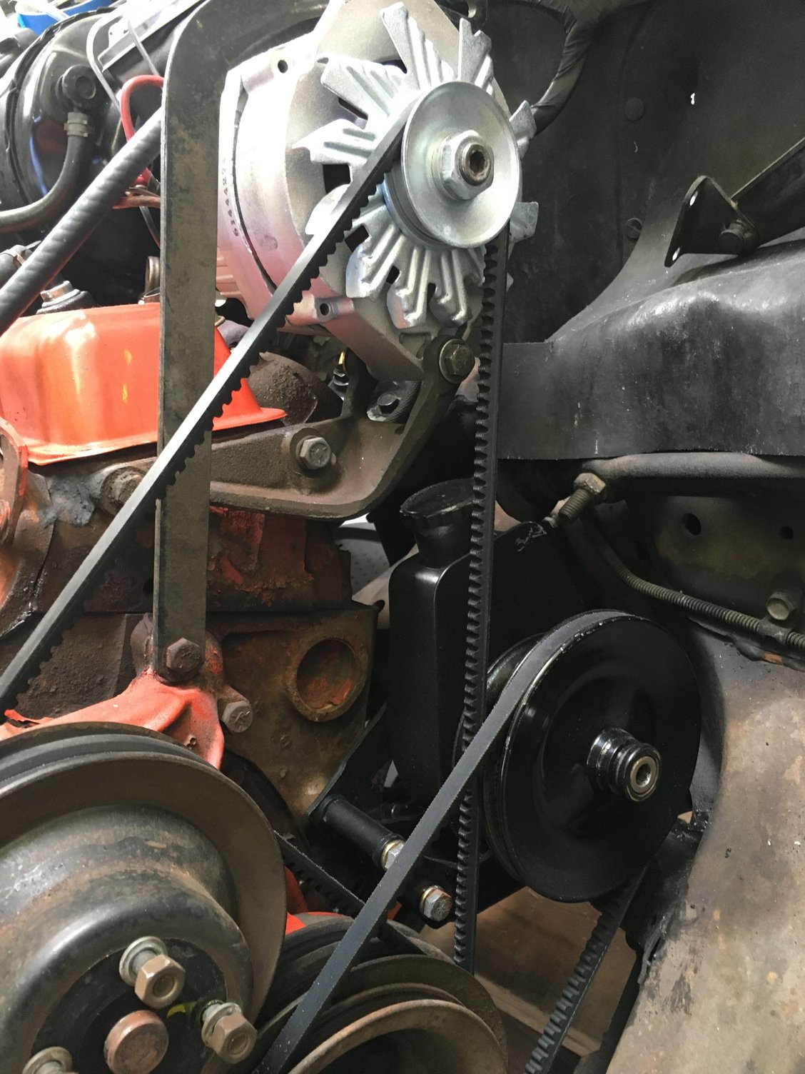

1976 L-48, maybe this will help. Good luck.
Old Oct 30, 2018 | 01:16 PM
teamo's Avatar
teamo
Joined: Feb 2013
Posts: 572
Likes: 61
That is a big help. Thank you.
