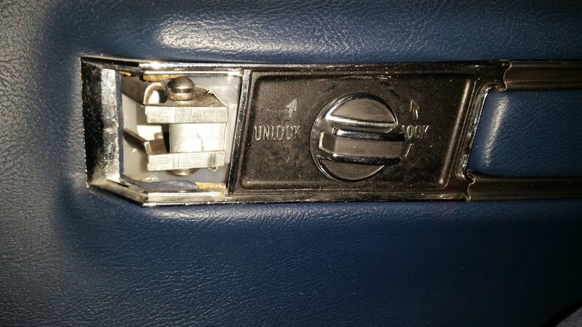

Simple problem, but I'm a simple guy.
Is there an easy way to install the handles once the panel is on?
The 2-rail mechanism has to extend out a bit (Open) in order to match the rails with the grooves and handle to clear the panel. I now have an idea why I once had to replace a mechanism; because the previous owner was prying on one rail in order to slide the handle on.
Or do I really have to remove the panel, install the handle first, then reinstall the panel?
Thanks much.
Steve

Yes, it is much easier to install before the panel is on.

Stick a flat bladed screw driver in the mechanism and pull it outward a tiny bit, then wedge something behind it... (another screw driver) .... then insert the handle. Once you get the handle in place insert the screw.

I keep it wedged open with a washer. Put the handle back on, pull on the handle and the washer falls out.

Thanks guys, but after 30 minutes of pryin & cussin, took the panel off, screwed the handle on, and EVEN THEN, had a difficult time getting the panel through it. Don't remember havin such a hard time with this before.
I know when I'm beat.
