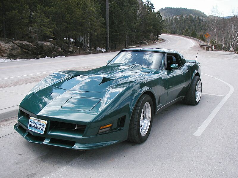

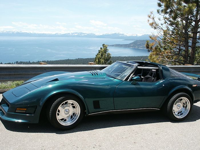

I will look around I had 285 and then 315s for 10 plus years with out flares with 11 inch wide wheels. They stuck out a little bit, but who cares

That’s stock ride height correct?

I'm not sure what the stock ride height to the center of the wheel wells lip to the ground is those pictures are back when I used the vb&p street and slalom kit. Lightweight front end with one inch shorter front 550 pound front springs and 500 pound rear so rear end height is bolt length adjustable. At the time the only thing to adjust front end height is the front tire diameter or space the front springs
the front is down for forward rake for higher speed stability. As power went up I continued to increase rear traction

The front tires are either 255 45 17 on 9 inch wheels or 275 40s on 10 inch. I also used 295 35 when I changed to qa1s coil over front end
