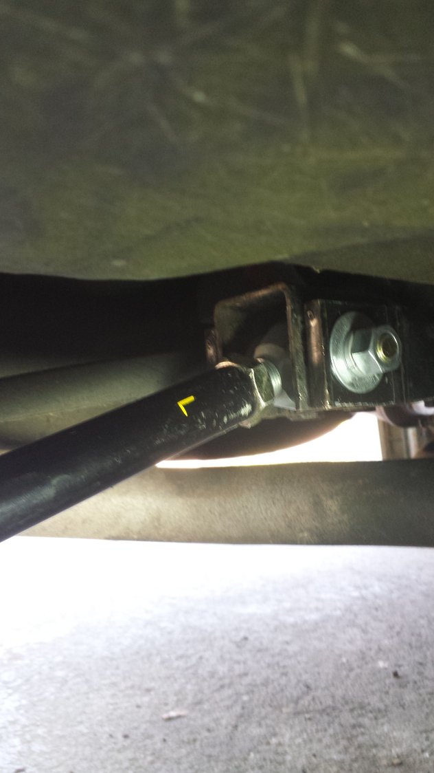

Which way to loosen the locking nut. Pull the wrench towards the front of the car, or pull the wrench to the back of the car? I've ALWAYS had an issue with left hand threaded items. The front of the car is the right side of the photo.

Counter clockwise as pictured... so towards the rear. Think of the nut as being a lid on a jar. Right hand threads you'd 'remove' the lid. Left hand threads you'd 'tighten' the lid.

Now I'm really confused. The photo is the front inner part of the rear strut rod on the RH side. In my mind, looking at the photo, counter clockwise would be pulling the wrench towards the front, or to right in the photo.

Wrench handle is hanging down. Move it to the 3 or the 9 to loosen?

Think of it as a regular right-hand thread. now put the wrench on it and tighten it. which will be pulling the wrench handle towards the 3. rotating the nut over the top towards the 9.

Hold up a bolt w/nut in the same orientation as the one you are working on. Turn the nut, paying attention to whether it's loosening or tightening.

Those are coarse threads, look closely at them and they will reveal which way the nut needs to turn.

Almost all you need to know, look which way the threads seem to go into the nut and turn in that direction to loosen.

The adjustable strut rods are basically a turnbuckle shaft and a pair of heim joints. One RH, one LH, like your tie rods.
I put red electrical tape on the LH thread ends, and make sure they end up on the port (left) side of the car, to make it easier to remember which way to turn them. Even then, I get it wrong half the time and have to look at the pitch of the threads.
