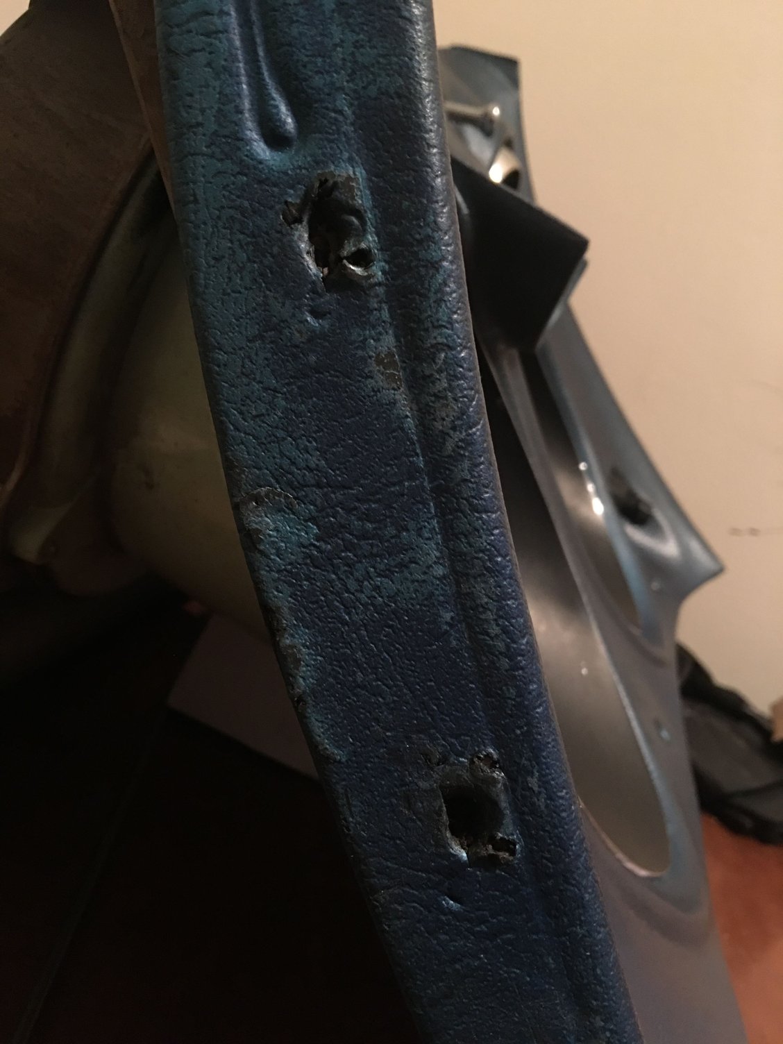

Hey all,
What is the most effective way of repairing dash panel threads?
drill a lager hole and fill with epoxy ?

YES. that is what I had to do, dont forget to pre-drill a small hole for the screw or the epoxy will crack out.

Holding the central gauge cluster, those holes are in the speedo/tach panel. I have the same problem on the other side with the map pocket panel. In other words, the central gauge cluster is just half hanging there.
The screws are essentially slid in there and not cinching whatsoever. Rather they are cocked and sorta holding.

The retainer in the photo above is what is used on the early C4 doors and in some areas of the interior of a later year model C3's, I can get you the part number tomorrow bit I seriously doubt I would try to make these work. Due to the depth of this type of retainer...it may not want to work due to the length of the screw needed to make it lock in place will have to be longer than the screws your car needs.,....thus causing it to possibly poke THROUGH the vinyl.
I have used heat gun to soften teh vinyl and peel it back so i can make a steel plate and fit it to teh main dash panel and then get the vinyl to go back to where it was....then drill a new hole.

Well what I did was take some sawdust mix it with Elmer`s glue and fill the hole where the screws go, wait a day or two and your good to go.
Just use a little glue not to watery.

I've heard about the baking soda and super glue trick but never tried it. Might be worth looking into for this kind of thing. Supposed to be drillable and sandable.

Guys... To me and IMHO... the best fix on this is to use what is called "Plastic Fusion" or "Plastic Weld". You can find this 2 part epoxy at most any local flaps.
Using the console side panel nuts and/or the door panel nuts is harder because you have to enlarge the hole to accommodate the nut and this nut also has an edge to it which will make it harder to install the center dash bezel... I've seen people use the dry wall ex-panders as well, but they too have a lip on them.
With plastic fusion you open the hole up a bit, mix this epoxy up and then push it into the hole making the outer edge smooth. When dry you then re-drill a tiny hole in the repair and the screw will tap it's own threads. I don't remember what size drill we use in the shop, it's after hours so there isn't anyone here to ask... but you drill it just a tiny bit smaller than the screw size.
Plastic weld is made to glue and repair ABS plastics and it works like a charm. We use this stuff almost every week to make repairs... it's amazing on fixing cracked area's behind dash pads, kick panels and other places as well... you just V groove the crack, sand and scuff the backside material and glue it.
