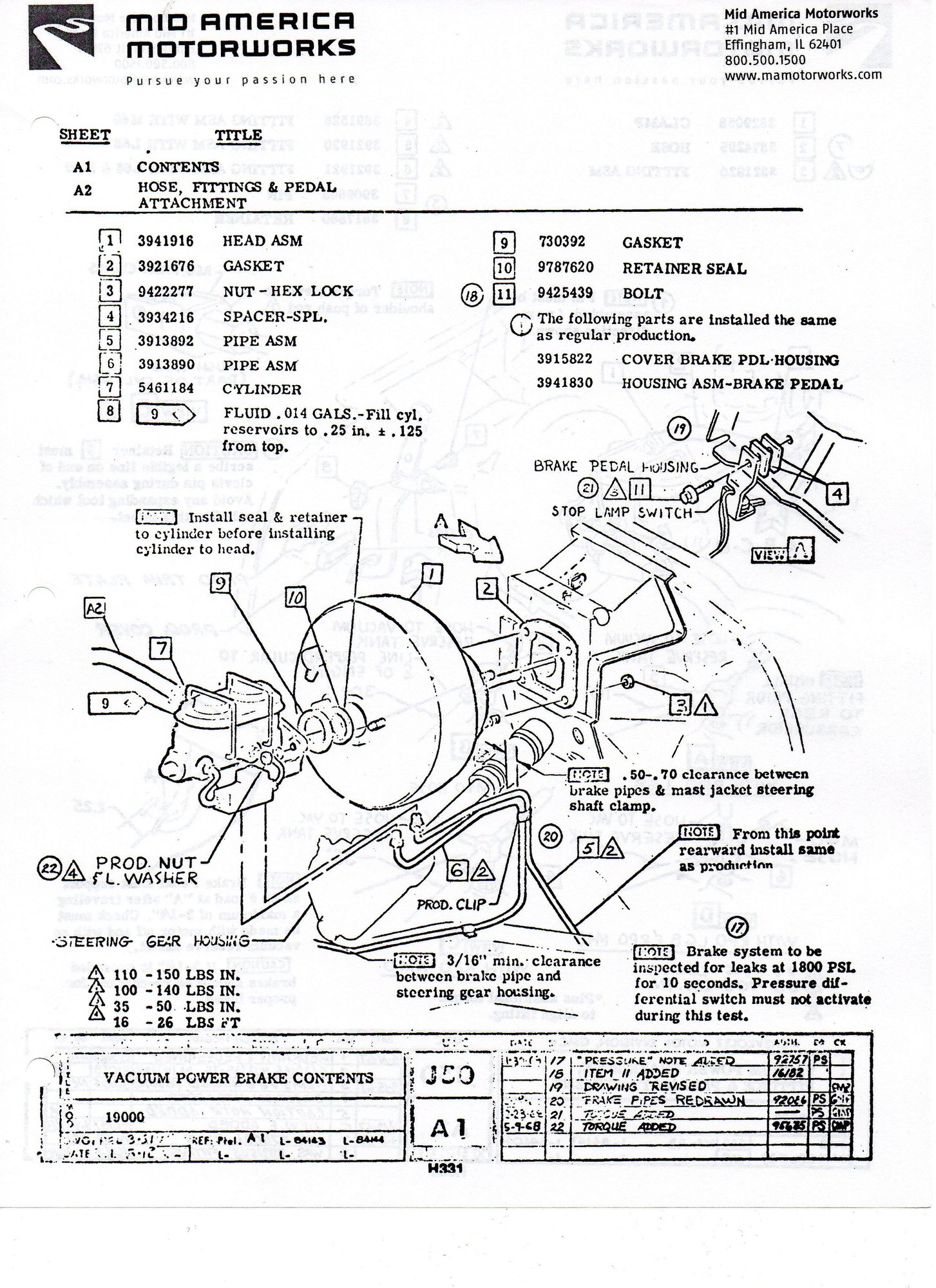

68 vette, power brakes, lines from Inline Tube for power brakes... where does this one go to?

From the proportioning block to the splitter block for the front brakes. Its a pain. I made one that didn't route around the power steering.

Looks like the line that goes across the front crossmember to me.

No that one is symetrical.
Look here: https://willcoxcorvette.com/corvette...wer-brak-68-68
Good to know.
Yep...looks like the AIM H331 drawing for that PB line (item 6).
Redvette2
AIM Vacuum PB Contents - page H331.

i apreciate the help guys... wow who knew... i put it on, fits but talk about **** routing... i'm running a rack and pinion so i have lots of room there...too lazy to go make one better at the moment lol
