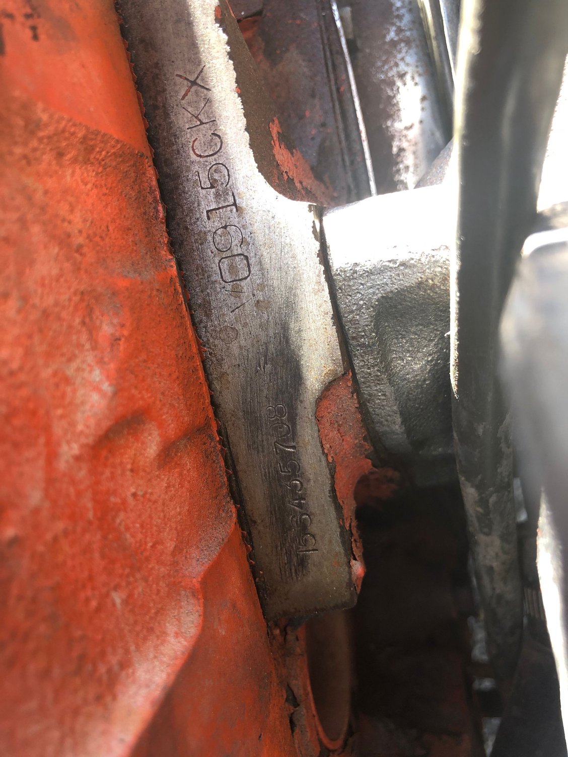

Hi everyone, im Keydel and im new here, i have a 1975 corvette L48,with th350 matching numbers, heres the things all numbers on engine, Car , Dates codes all match but the engine model code, its CKX wish belong to 1972-73 and 1976 corvettes any help

  1. What's the vehicle serial number or the vehicle identification number (VIN)?
  2. Can you post a photo of the engine pad suffix code?
  3. What date codes match?

Are you sure it's a 75? CKX was for AT base engine cars in 72; it was not used in 75. It was used in 1976 for base engine cars with AT. It could not be matching numbers for you unless you have a 76. Post your VIN.

1Z37J5S435708
engine vin-I5S435708. V0915CKX

35708. an 09-15 engine build date. A very late 75 could concuevably get a 76 engine code.

Your engine is the correct engine for the car - it is not "wrong." The VIN is a match. It was assembled on September 15th 1975, which makes your car a very late production car. They would have staged the assembly line with a mixed bag of remnant '75 engines and early production '76 engines. A '75 Vette does not have significant value with or without the "correct" engine - it's nice that it's correct and original, but it does not add significant or special value to the car being a late production '75.

A way to tell would be which carb # you have , the 165 and 180 were different.
165 = 7045222, 180 = 17056208 . calif 180 = 17056506

It's completely irrelevant. The two engines are the same. They use the same camshaft (same cam as Chevy used in every pickup truck, station wagon, and Checker taxi cab), same compression, same induction setup. The only difference was in the exhaust system and marketing games that GM played with the ratings of their engines installed in different vehicles. The engines are the same. Call the horsepower anything you'd like. You probably have about 150, and it's the same whether the engine was built in September or July.
