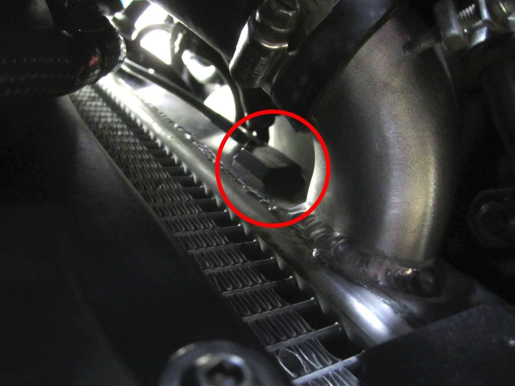

I installed a PWM fan controller last year from Derale and the temp sensor is installed on the output side of the radiator. Originally it was s probe installed through the fins but as it turned out the aluminum rads were causing issues and they switched to a surface mount probe, again installed beside the out side of the rad

This is an interesting topic. Cooler side of the radiator may give you more consistent coolant temp going into the motor, but is that what's really needed? in order to maintain the same engine temperature under varying loads, the engine may need cooler or warmer coolant temps coming from the radiator. So I vote against the sensor at the cooler side of the radiator.
BTW, for any DIYers, I posted a DIY PWM fan control thread. https://ls1tech.com/forums/forced-in...-less-diy.html
