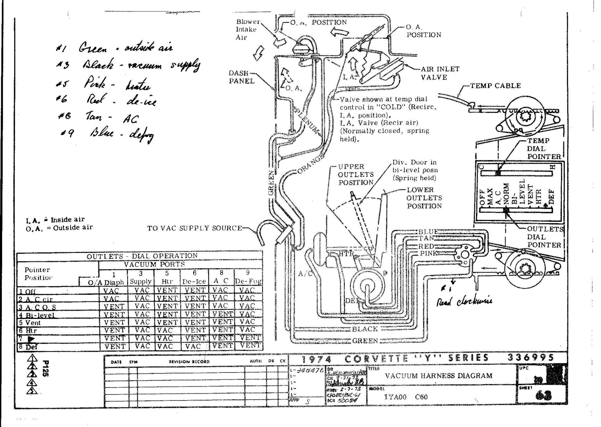

Quick question - 1975 with A/C - On the center console - The dial on the left (Driver Side) controls the a/c or heat or which vent by vacuum only no cable. The dial on the right (pass side) controls hot or cold by a cable to the box under dash - no vacuum. Am i correct?

Yes.
