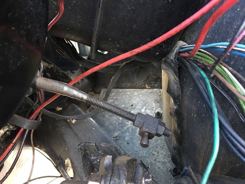

Does this clutch pushrod look right?

I know on a C3 it is supposed to be offset, but this looks bent.

I thought the same thing last time that the engine was out, mine is bent about the same. T

It also looks like the stud on the adjustment block is worn a bit. Might give you some slop.
