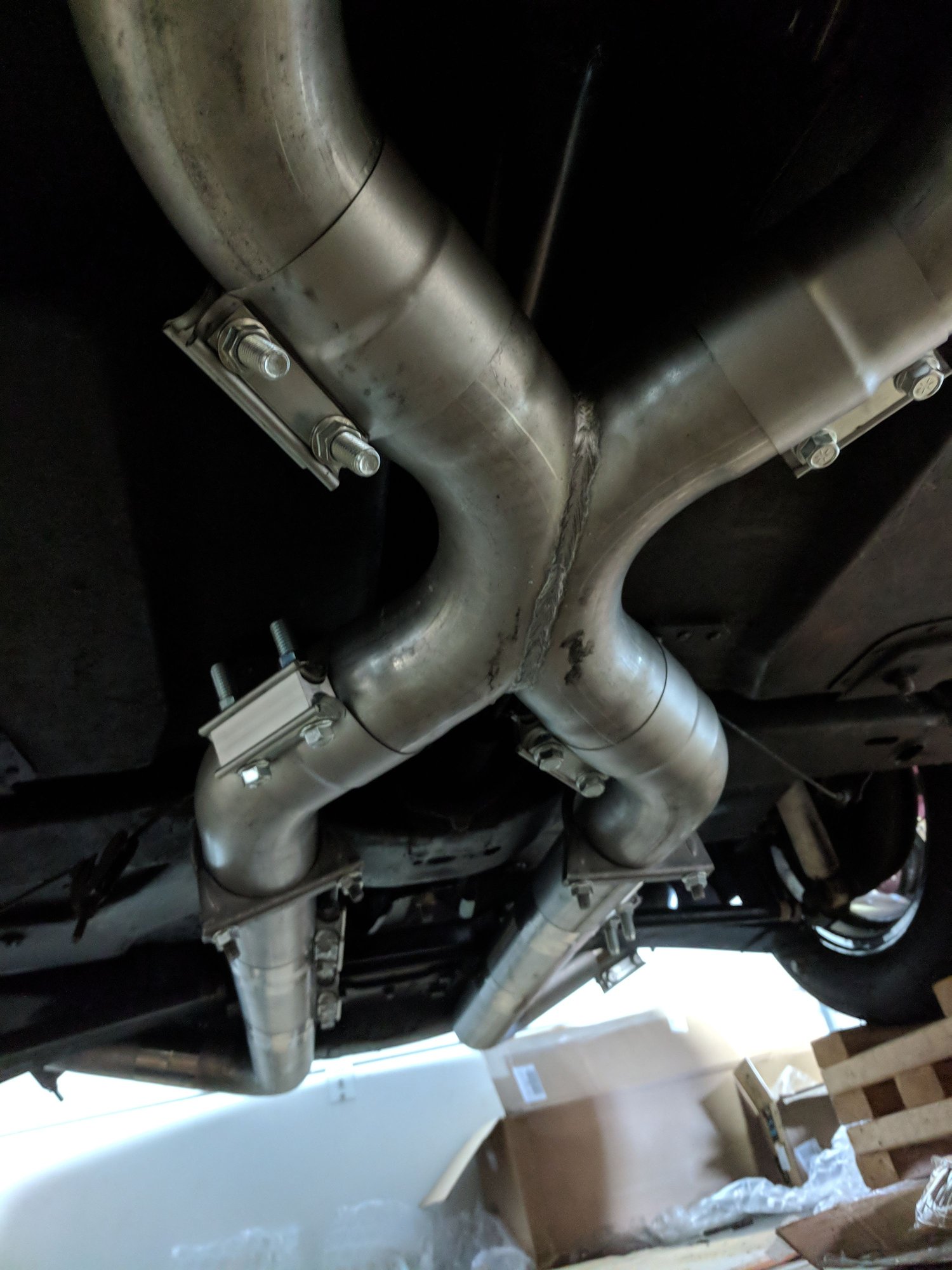

I agree. I just put my 3" exhaust together using the summit x-pipe and a bunch of individual mandrel bent pieces. This is what my x-pipe looks like

Yeah looking at Summit's website, it seems they sell many different versions/brands of X pipes.
I was just posting the one above to demonstrate the potential pinch point in the X many X pipes have. All depends on how they pie sliced/welded the pipes etc.. You can see how on some X pipes, they take two 3" pipes, then section them out and weld them together, and the middle of the X is more like two 2 1/2" pipes because they cut half of the pipe diameter out to join them.
