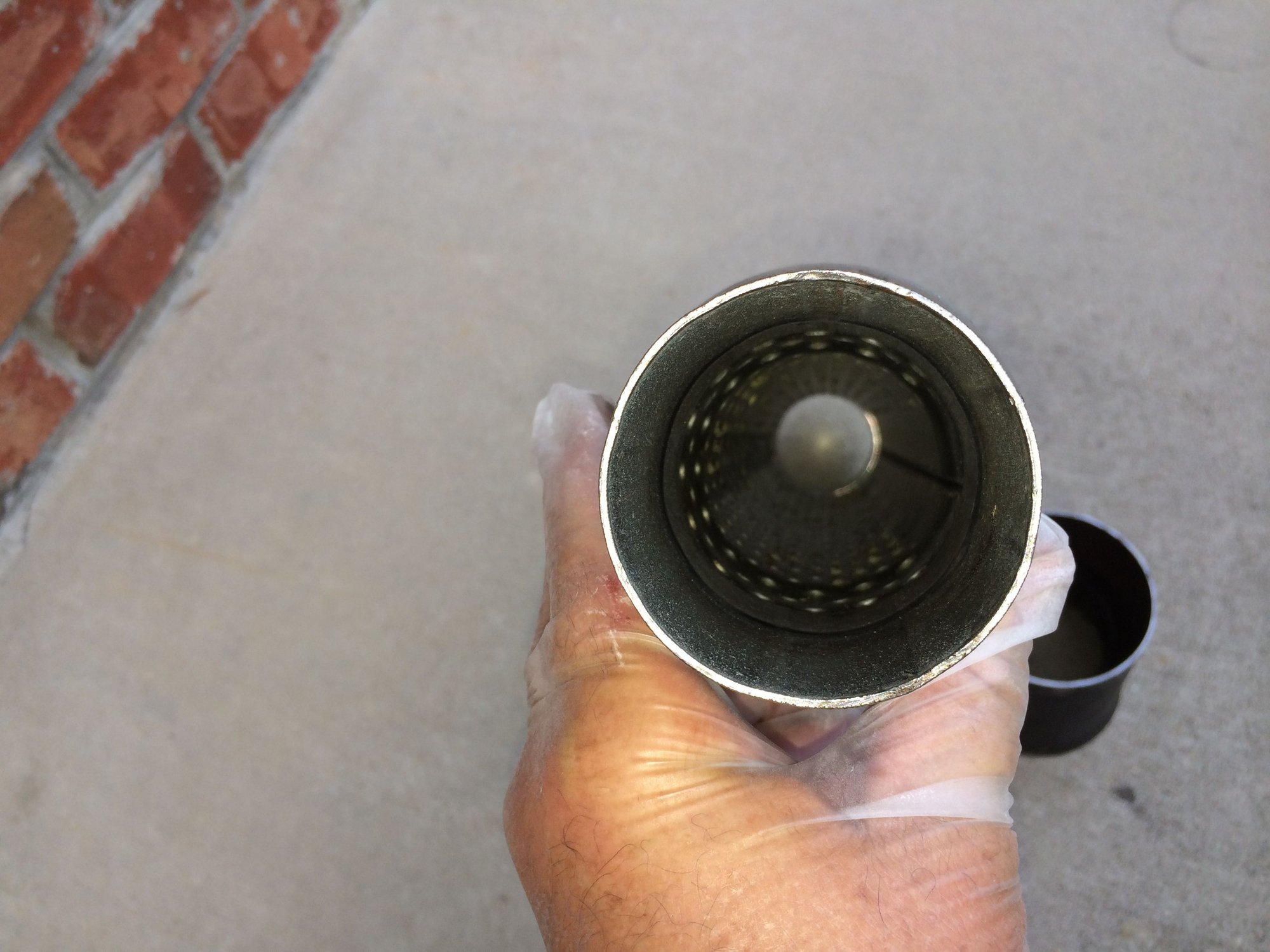

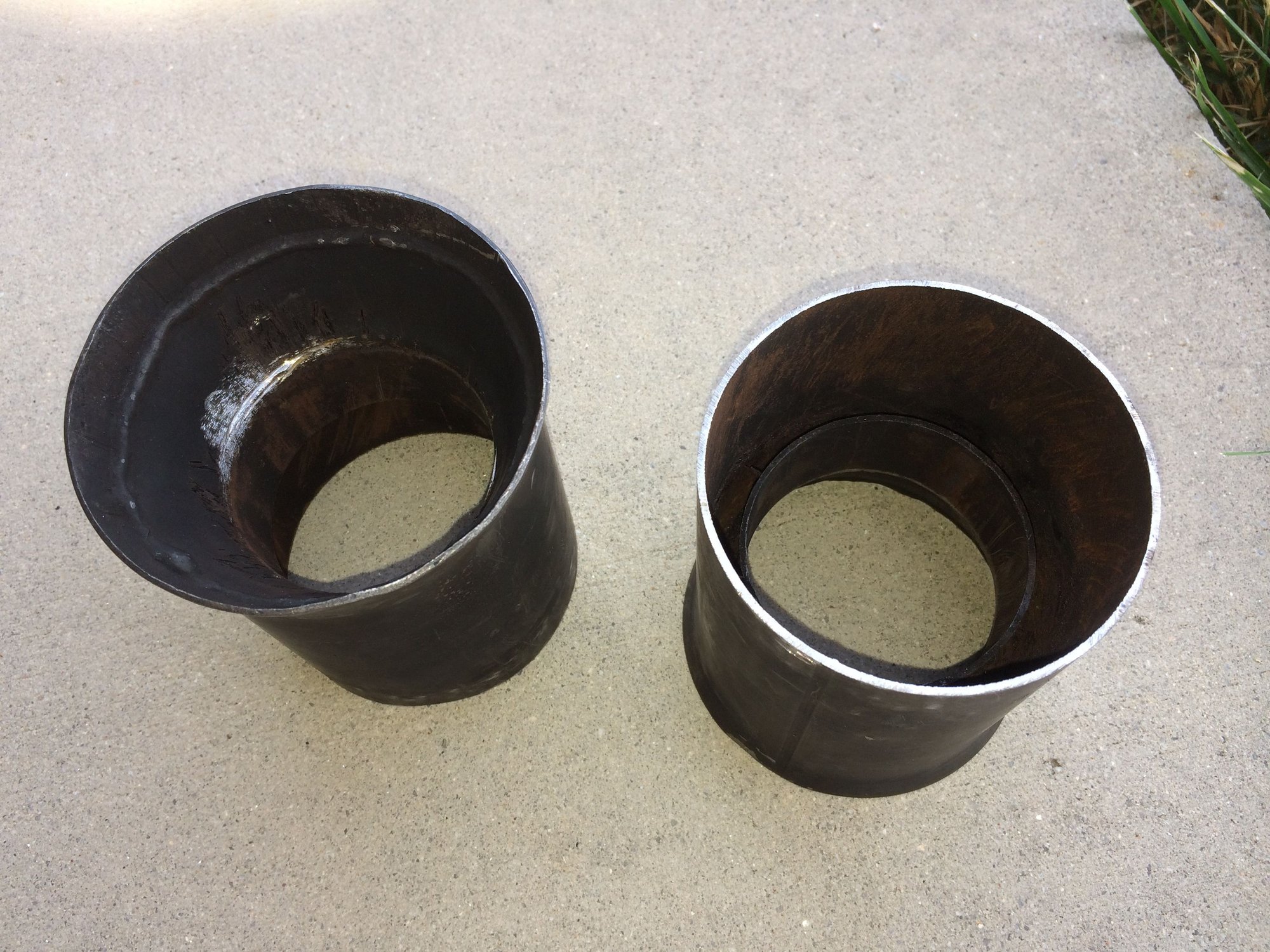

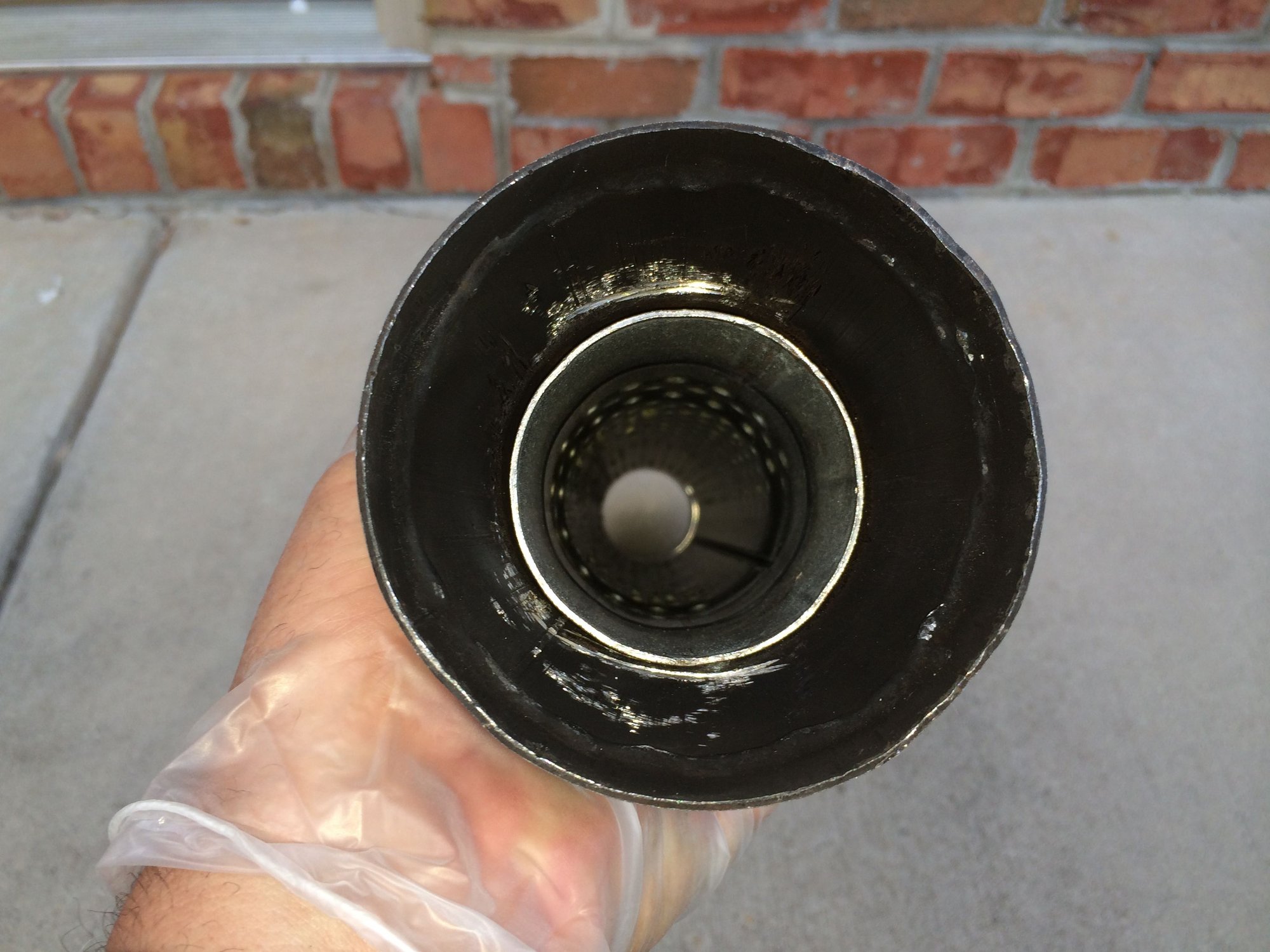

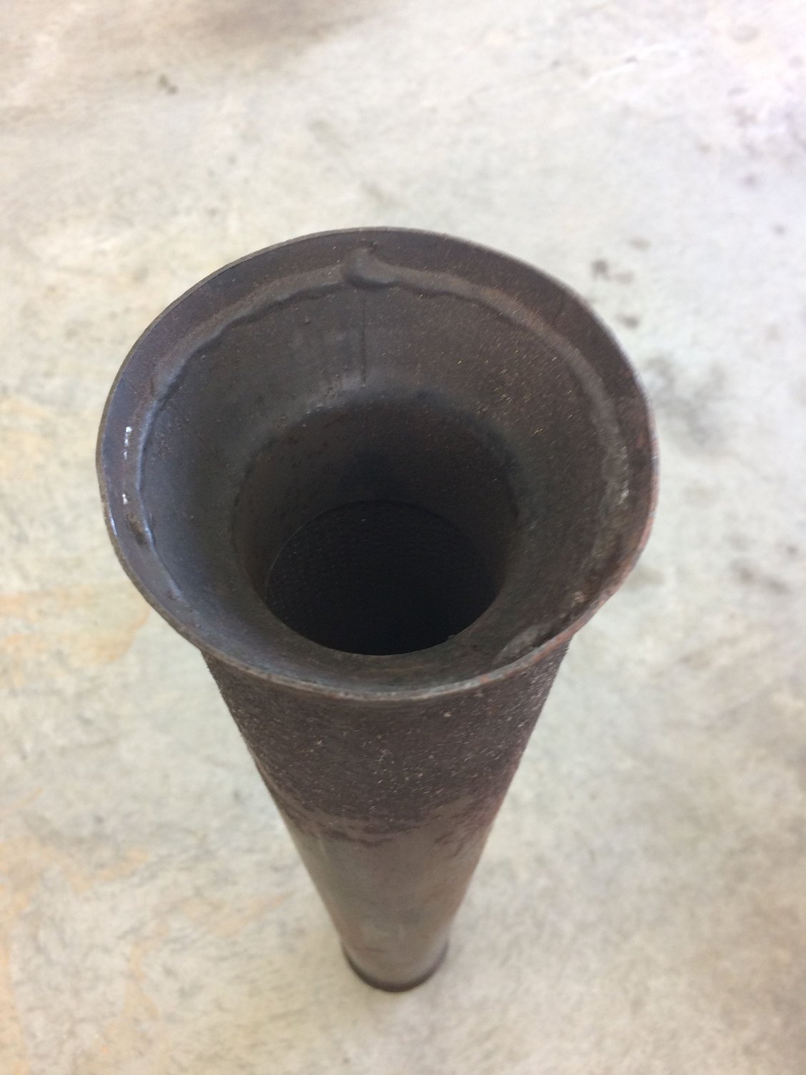

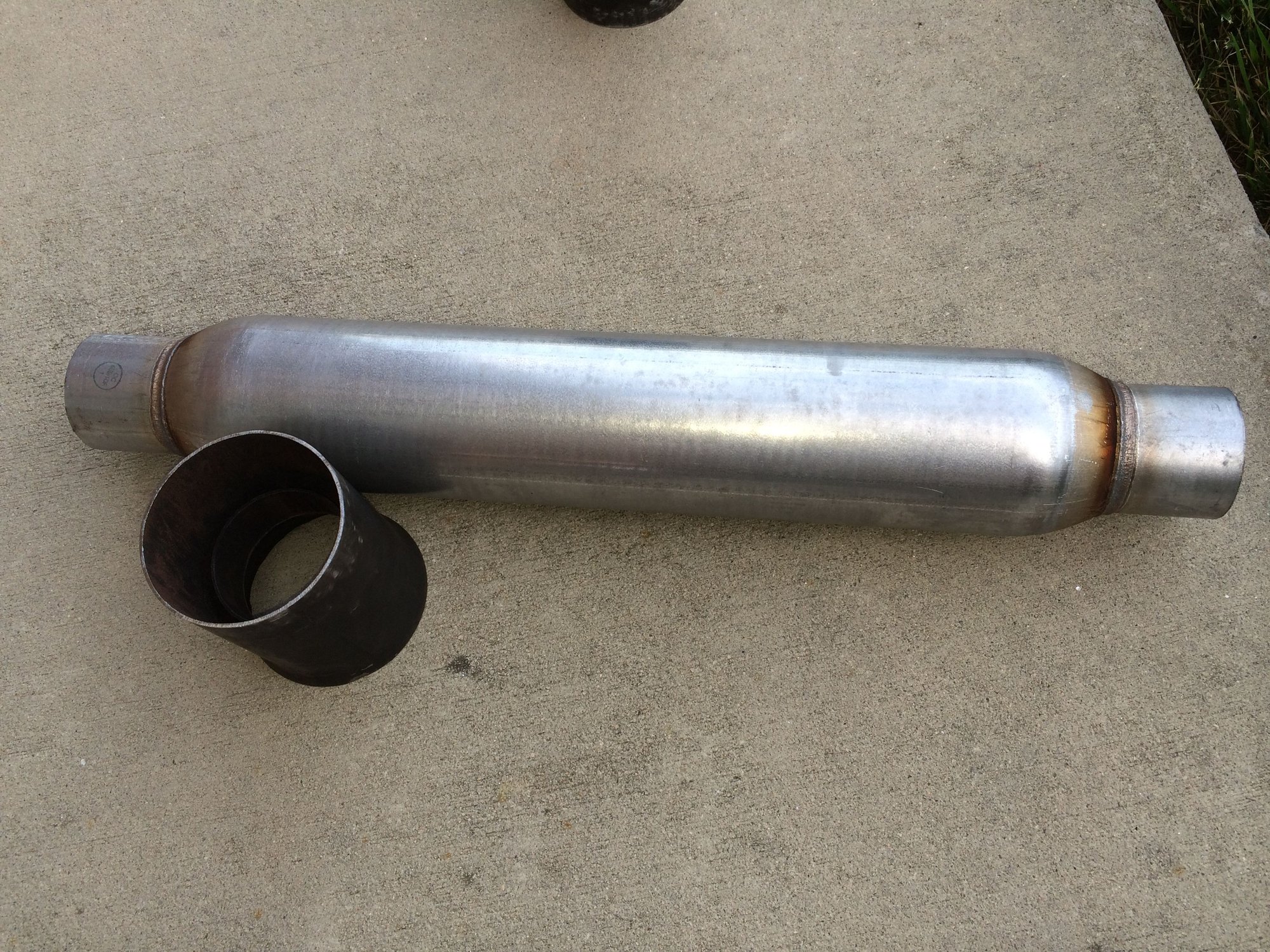

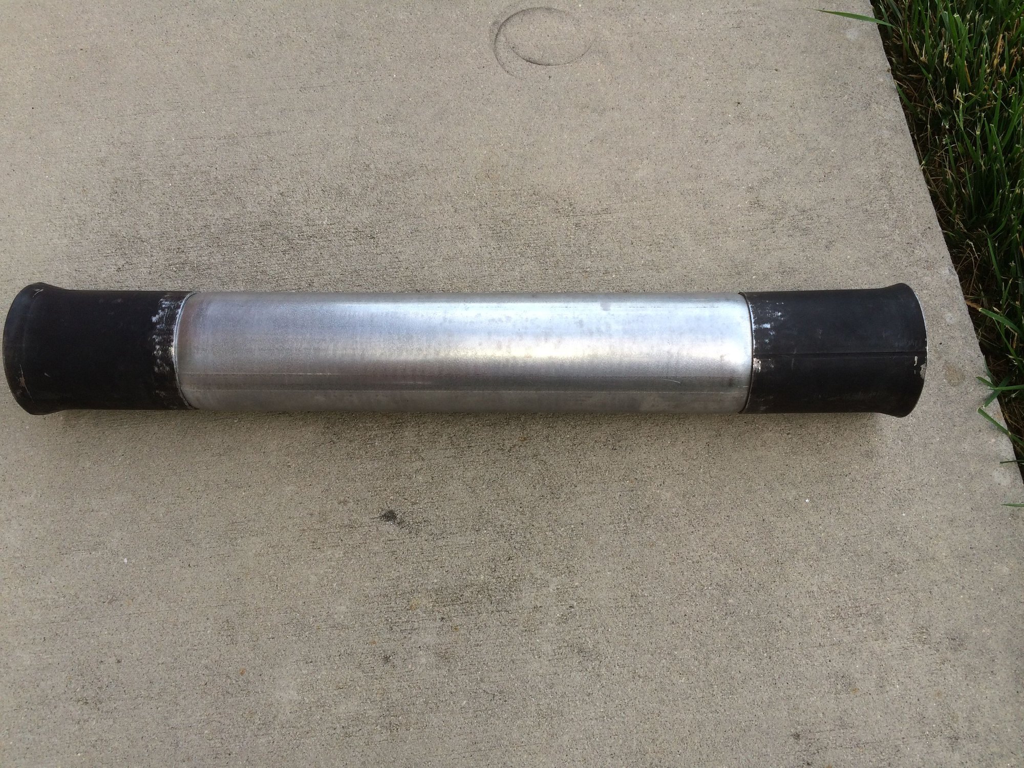

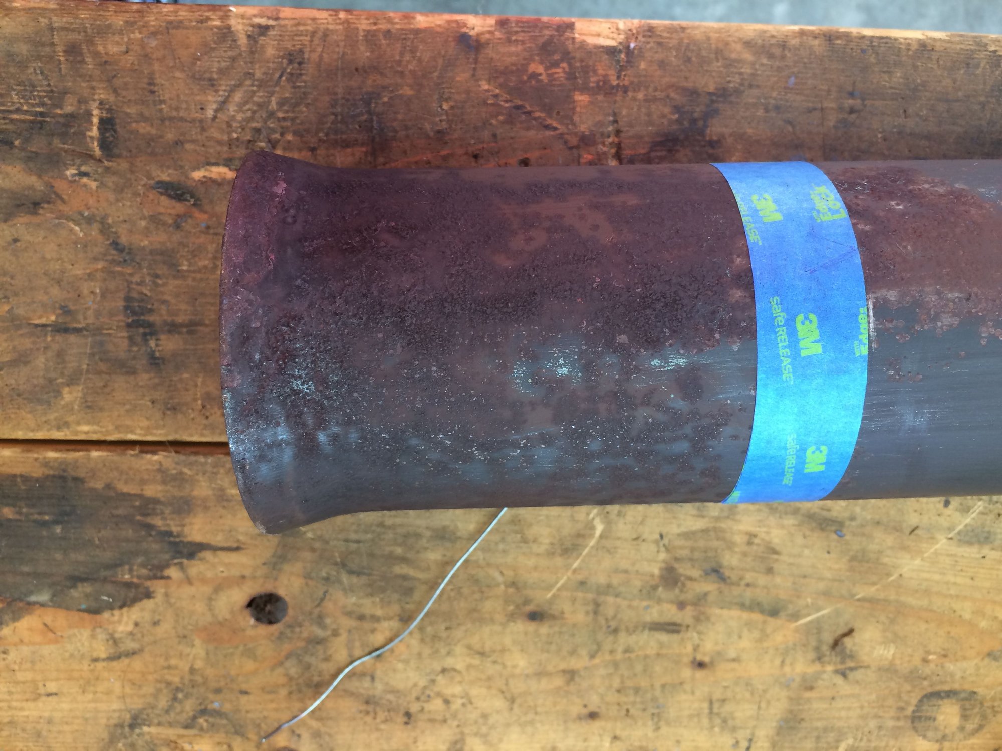

They are a pain to take apart and replace. Not difficult by any means but you don't want to do it back and forth. I had "earplug required" inserts when I bought my car. I tried a bubba built insert that a friend had and it was still too loud. I bought Hooker glass packs and the sound was acceptable but too restrictive. I finally cut the ends off of the old inserts and welded them to 22" Magnaflow glass packs. I can now hear the radio and carry on a conversation at cruise and it has the deep mellow Magnaflow sound. Best of all it isn't very restrictive and you definitely hear it under moderate to hard acceleration.
Old burned out pipes
Ready to cut. About 4".
The cut off ends. The inner pipe has to be cut out also.
A look down the Magnaflow 22" 2 1/4" inside.
The cut ends fitted.
Ready for assembly. Make sure you have the correct ends on each pipe. One end is larger diameter than the other. You need large and small on each muffler.
Ready to weld. This one is actually 18". It was too loud for my taste so I have done this twice.
If anyone is interested in the 18" inserts they are available. Just PM me.
