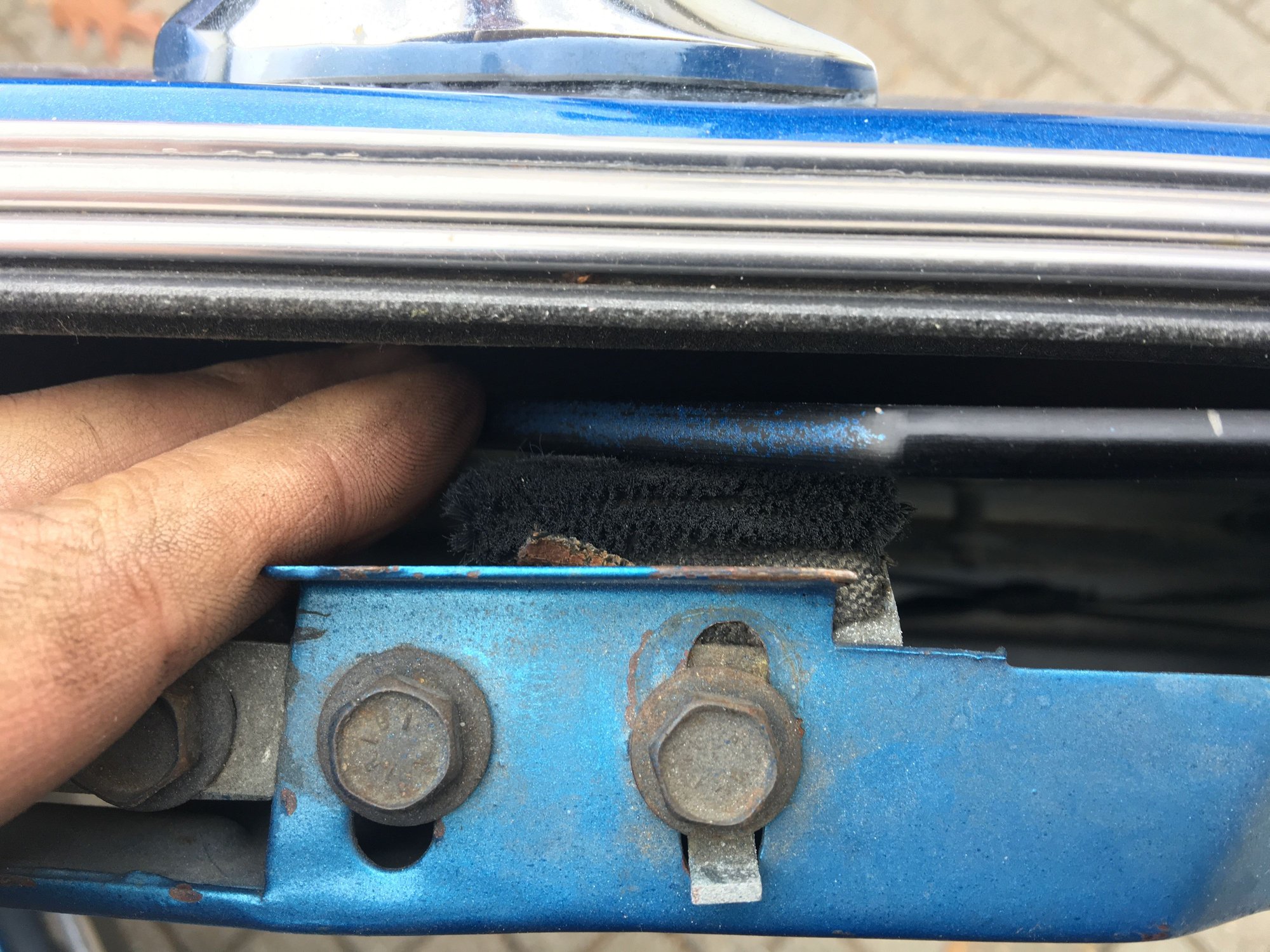

Hey All,

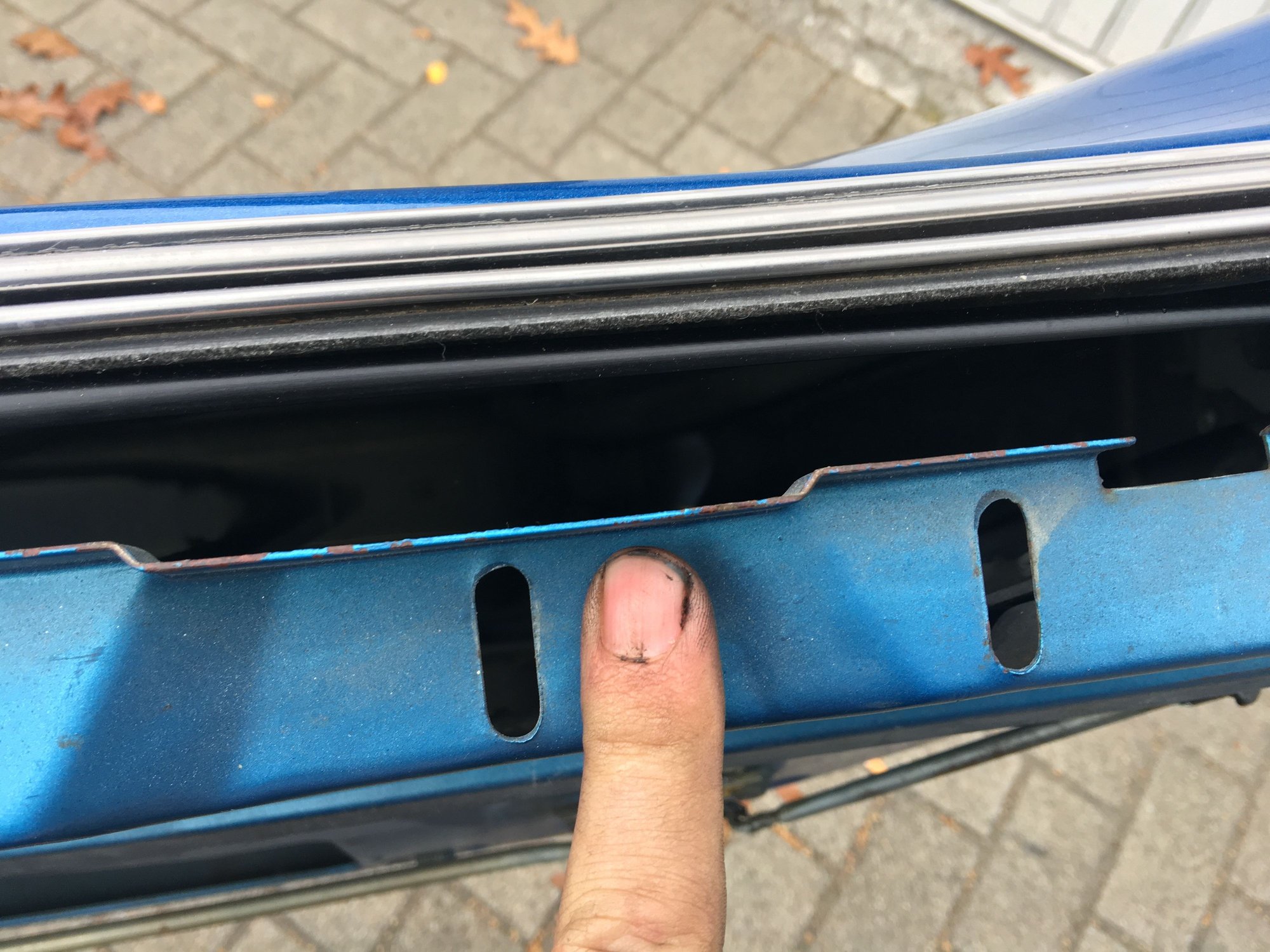

Looking at my door glass. There are two brackets with felt that press the glass against the outside wiper. Am I missing a third one?
Is there a felted bracket missing here ?
Also, are the ends of the wiper screwed to the door? It seems like they should be.

I think it only has two.
My '73 only has two also.
Steve
Only 2 anti-rattle felts per door. And if you're talking about the wiper on the outside with the trim, yes, there is a short screw in each end, along with the snap-in buttons on the felt that hold them in place.

Fantastic, gents... you are fantastic.
The two top screws are missing in the door panel... they were never installed. This leads me to believe that rattle comes from here as the whisker was never truly brushing it up as it should.
Goodness the outer skin sounds like a drum !!!! Fortunately, I have some left over FatMat. That should make a huge difference
