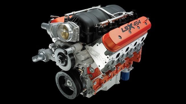

Here you go-
454 NA small block w/ 627HP on pump gas - and has a 2 year/24K warranty-

^ Nope, Gen 1 only.^
