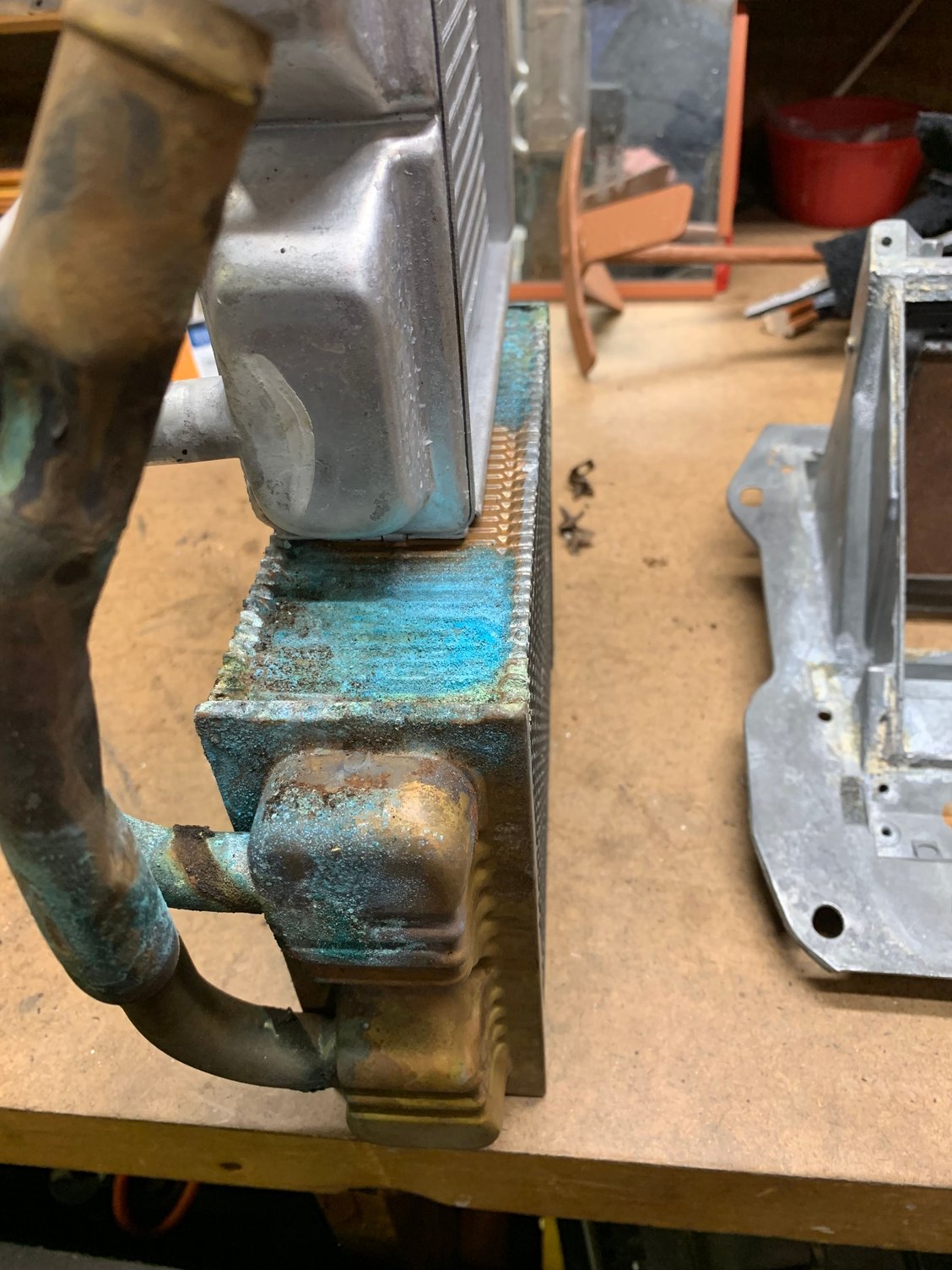

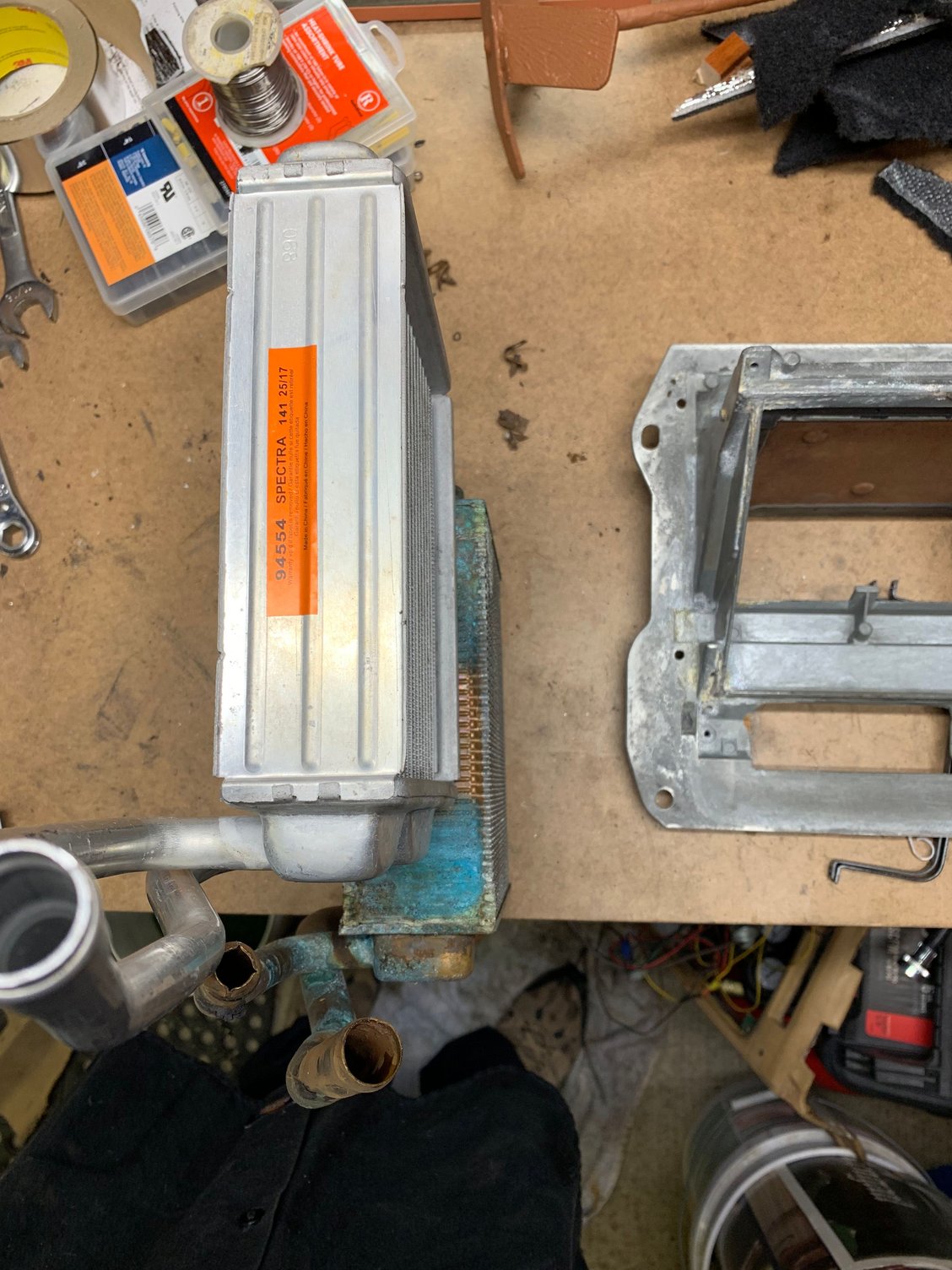

Hello, I know this has been talked about before, but until you see it in person you don't realize the difference. I bought a "direct replacement" heater core from Napa. As you can see below, they are not similar in size at all. I'm thinking of returning it and having mine recored, unless someone has a good fix for holding this down so it doesn't rattle itself apart. As it is now, the original straps are useless because the new core is so much smaller. Thanks

I did my 78 a few months back and had an issue with the end were the hoses connect. Had to modifly the housing a little to get it to fit. Otherwise it was similar in size.

I'd take it back and aso take my old unit too. See if Napa has a dimension chart in their parts book. Look at a core from the next year up or back. They may have dicked up the numberd in the book or on the program.

Either the wrong core in the right box or the right core in the wrong box w/ wrong label. That's not acceptable. Close enough is for pitching horseshoes.
If you have a radiator shop within a hundred miles, take your old heater core to them and let them go at it. After all, its a perfect fit, direct placement.

The NAPA site shows both of the cores you have. The new one is without AC, the old one is with AC.

Not knowing what year car you have (you have no info in your profile), you may have bought the wrong part.
(For a '79 Vette):
NAPA part number NHC 6603140 without AC:
NAPA part number NHC 6603080 with AC:
Check the dimensions:
Heater Core Height: 6 5/8 in.
Heater Core Hose Size: 5/8 in., 3/4 in.
Heater Core Length: 6 in.
Heater Core Width: 1 1/4 in.
If those are not the dimensions of your stock core, you need to get a core from Paragon Corvette or have your old one re-cored.

Went through this several years ago with my Pace Car.
Napa's parts book showed the exact heater core I needed, brass and copper. Ordered it and got same aluminum you got. All they had, parts book was pretty much totally out of date.
Ended up getting one from Zip. Had assurances it was correct brass/copper unit before buying it.
Also, If you check ebay, all the ads I saw that SHOWED brass/copper units were in fact aluminum.
And 78 and newer were in fact 1/2" thinner than the earlier ones.

I got one of the smaller cores, the straps didnt fit but it was tight enough in there that it doesnt rattle, but i have a 68 too which is always a whole other problem.

My A/C'd '73 was leaking (after new carpet installed, of course ) and thought it best to just replace it. Got it, and
WHAT A JOKE!
Smaller, light weight, .
Local radiator shop was able to clean & repair the car's original part.
If you've got a Harrison there, keep it! Have it looked at by a repair shop. These are heavy duty enough to most-likely save, thus keeping the car more original AND having no fitment problems.

Well, I return the heater core to Napa. Interestingly enough, you can’t return it to just any NAPA store. I tried to return it to different store than the one I bought it at and was told no. So now I have to decide what to do. My original heater core is a Harrison. So I might just get that recored. Or, I might just bypassed the whole thing. Thanks for the info so far.
