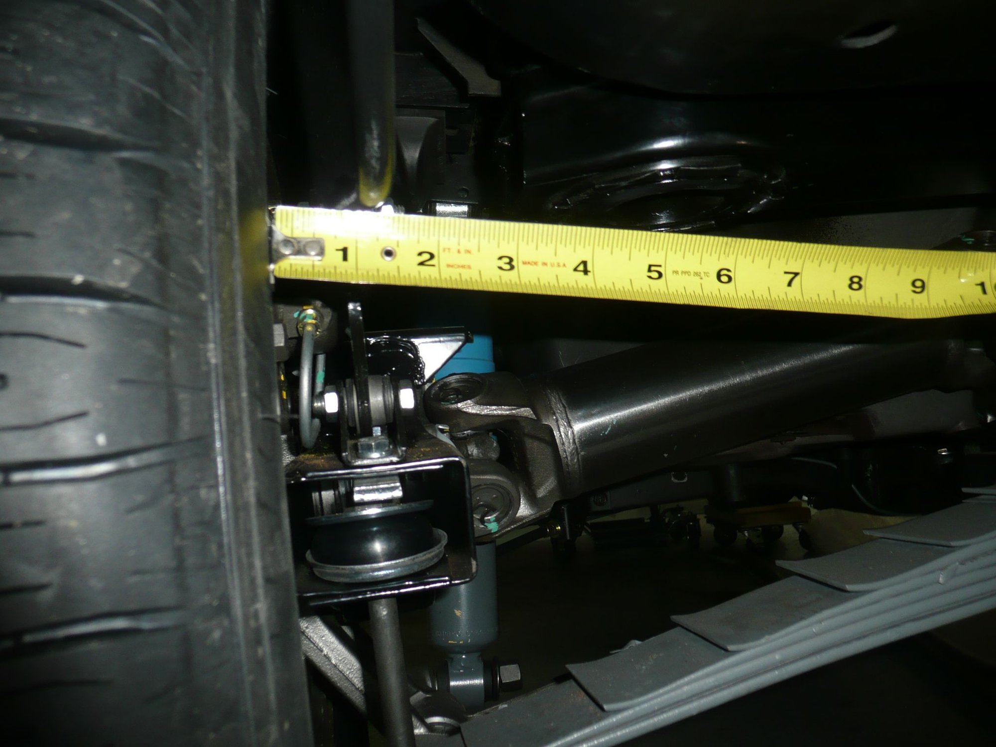

I have put 275 60 15s in the rear of my '81. I recently purchased a Van Steel 3/4 " rear sway bar. I can't install it because the bar hits the inside of both rear tires.
Is there another bar that someone may have used that worked with this combination without the interference?

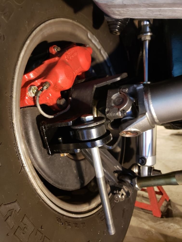

Mine's still up in the air. I swapped the 4.11 gears in, then decided to drop the trans to install my custom converter.
The spring I had made is 440 lbs so I am hoping to just not run a rear bar now. If later I decide I need one,.....I still have the old bar I can try and do what Gkull suggested, or get a short bar. I was running a 360 lb spring with the bar before, so I'm really hoping the 440 lb will compensate enough.
BTW I ended up with aprox 4 3/4 inch wheel backset with my Weld 15x9s and 295 55 15 drag radials. Looks like it'll work, but be pretty close to the T arm pocket. I'll know when it's back down on all fours this spring. This pic shows what I did to move everything inboard 1 1/2 inches.

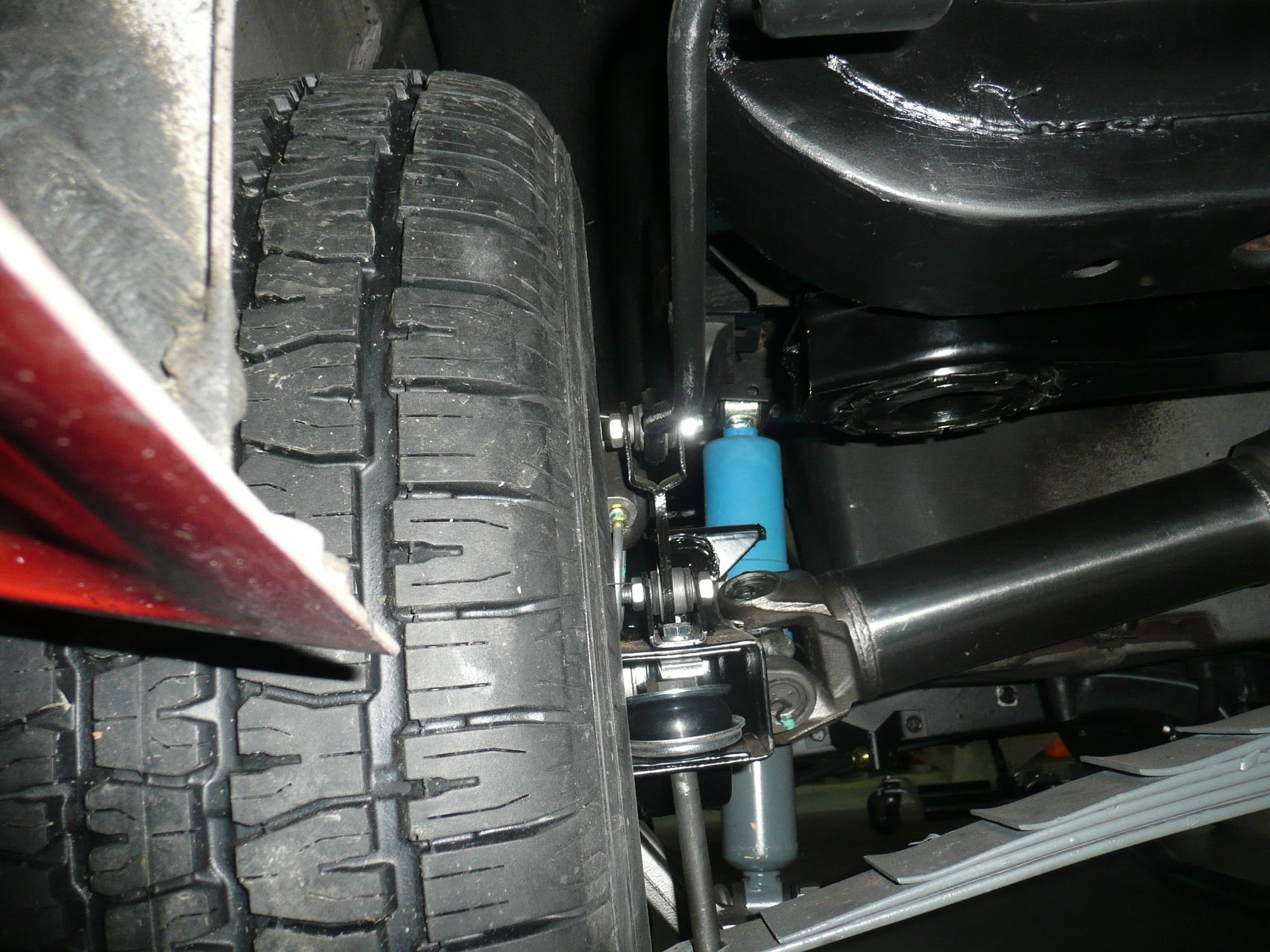

I don't know if this will help you, but this is a stock rear bar on my 79'. Has about an inch clearance to the 255/60 tire on stock aluminum wheels.

I have 275-60-15s on the rear.. If I'm lucky I'll might have a 1/2" clearance.
