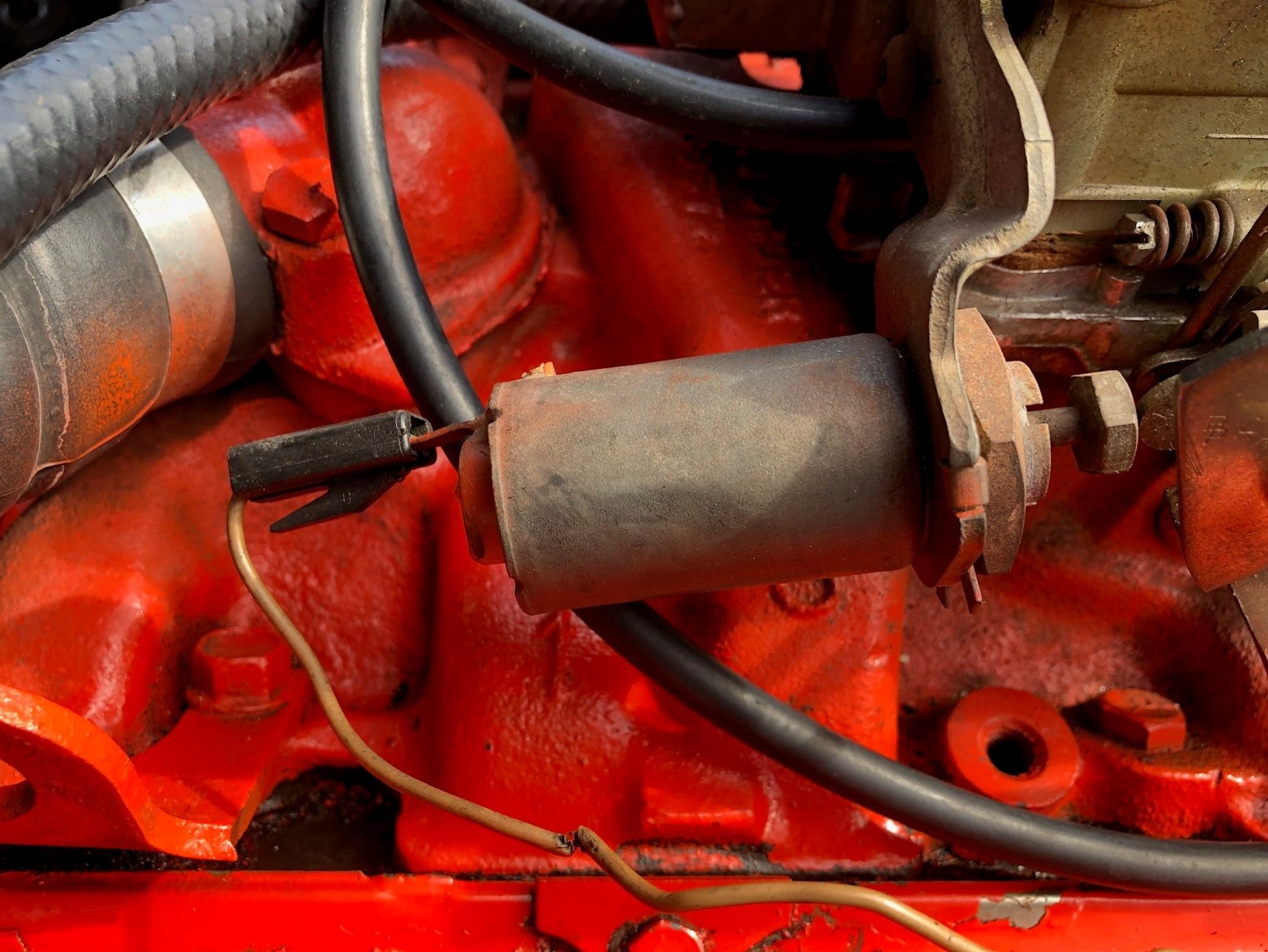

Located near the front of the engine, one on each side.
Located near front of engine on passenger side.
Located near front of the engine, driver side

On the carb, idle solenoid for factory AC. Second one is probably TCS (transmission controlled spark).

Easy Mike, I think you have them backwards in your description, don't you ? 2nd pic is carb idle solenoid...

The first picture is the TCS, second picture is the idle solenoid.

The first photo is the Transmission Controlled Spark solenoid. It prevents the distributor vacuum advance from functioning until the tranny is in 3rd gear. This keeps the timing retarded at lower vehicle speeds (like in stop-n-go traffic) for lower emissions. The second photo is the idle solenoid. Depending on the year and application, some vehicles used these to keep the idle speed constant when the A/C compressor kicked on. Other years used these as an anti-dieseling solenoid by closing the throttle blades when the engine was shut off, thus preventing engine run-on after shutdown.

Thank you for the detailed answer Lars! Boom! My car is a 73 w 350.
