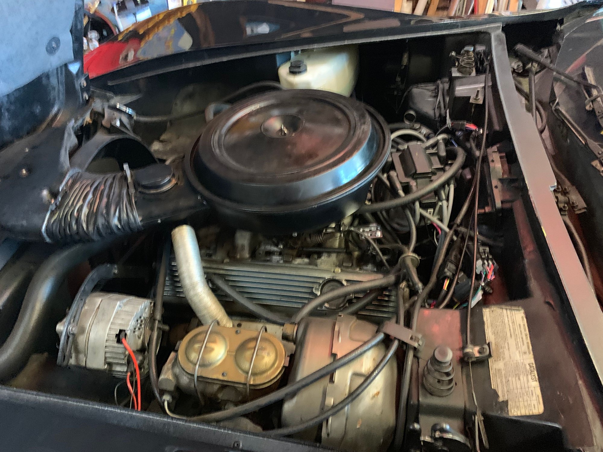

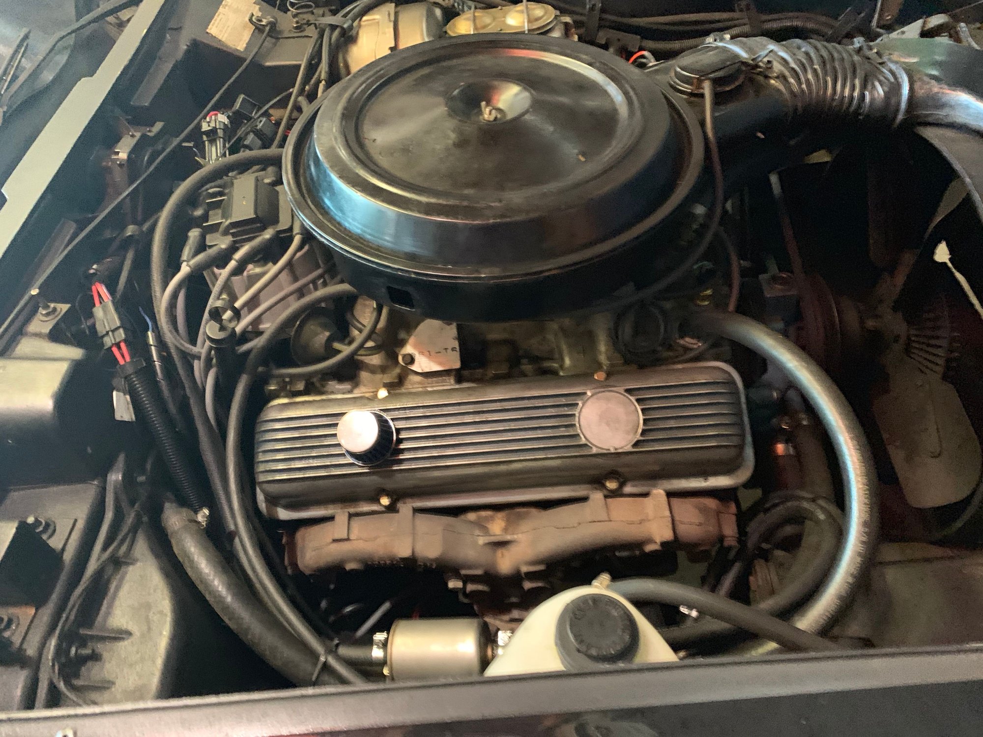

I like the stock look of my 77 l48 so I reused the stock air cleaner with Holley sniper
It runs great with sniper efi. Much smoother at cruise and wot. Im surprised how much drivability is improved.
The guys at efi pro were a pleasure to work with.

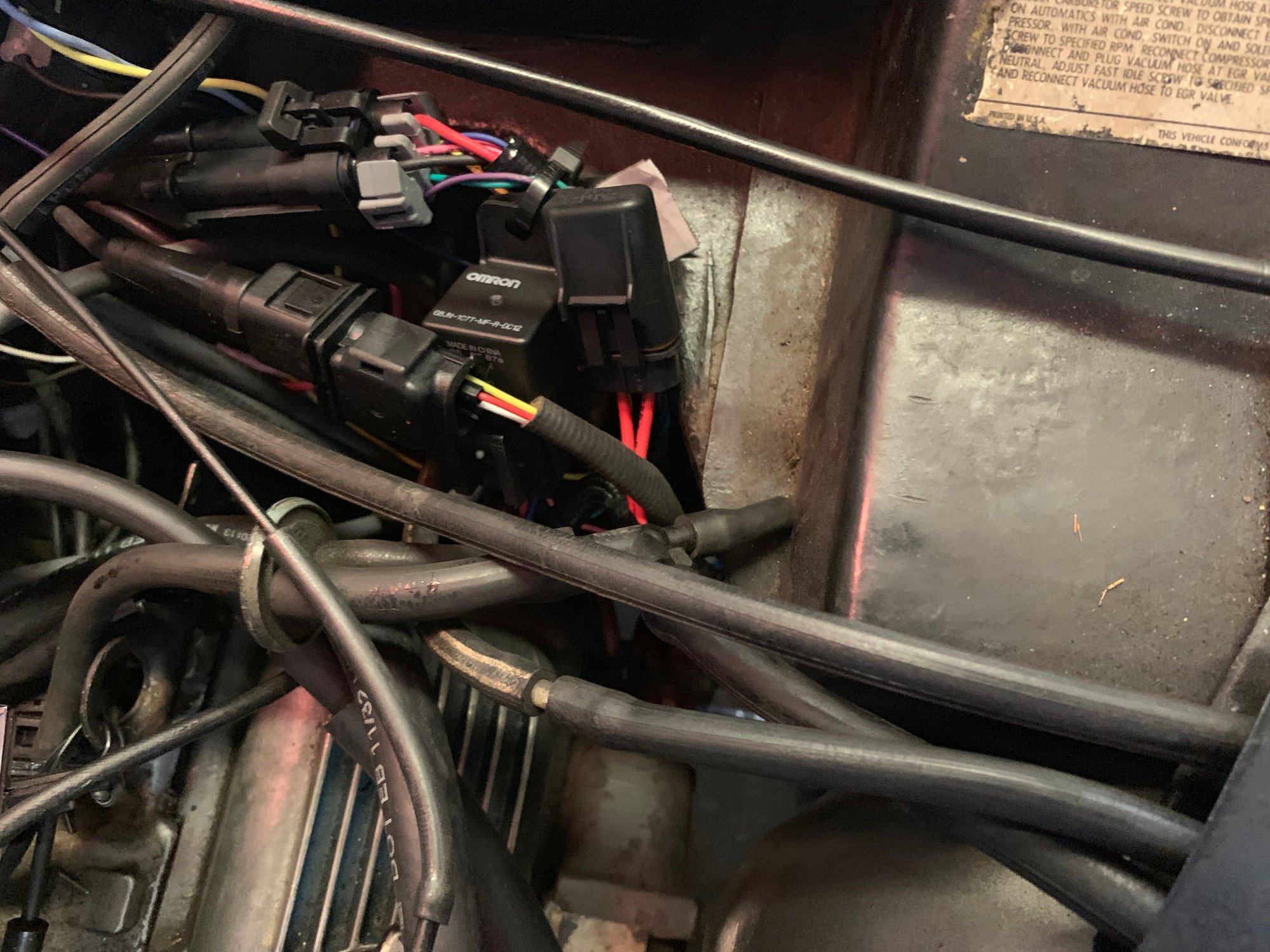

I did quality wiring, decent fuel system work
thread on tank here ( https://www.corvetteforum.com/forums...tal-story.html )
and terrible throttle linkage fab work that I cant show anyone.
Holley makes a progressive linkage and throttle bracket extender but I wanted to test the idea before buying all the special brackets.
Longer throttle arm , progressive linkage and reprograming to progressive throttle mode made it work more to my liking on take off.

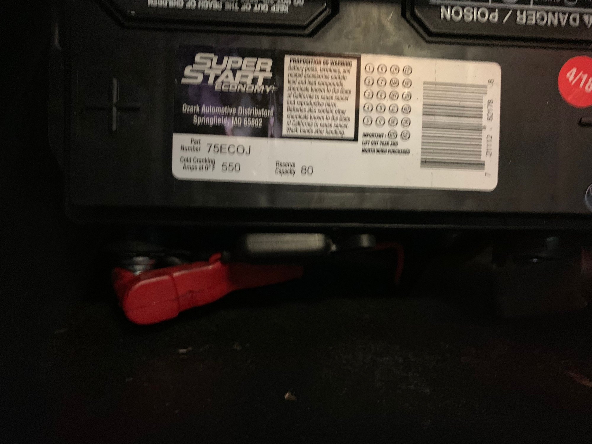

My only suggestion to Holley is to add a fuse where the main power connects to the battery. The long red wire has a fuse way down the line by the sniper relay and plugs leaving a long stretch un protected.
Im wondering if switching to the holley ignition components ( dist, box and coil ) will noticably improve drivability. I have a recurved hei big cap which seems to be properly adjusted.
I added the fuse holder and 30a fuse ( black cap visible )

Dude, clean up your engine. Maybe an L82 snorkle for that EFI.
i kind of like the stealthy\sleeper aspect of it....
that at over the radiator L46 CAI probably flows enough....
Chevy 350 engines are supposed to be dirty, in my honest opinion. As long as the car looks good.
