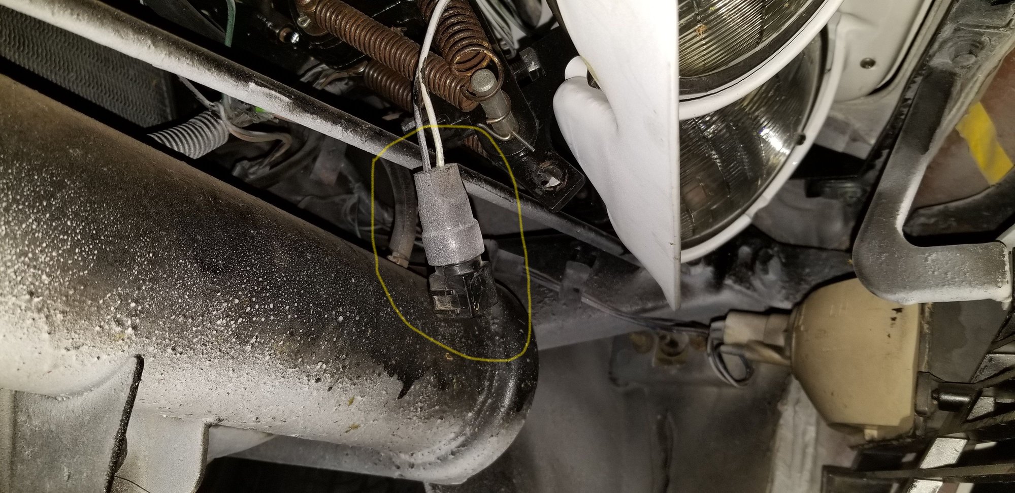

So my driver's side headlight has stopped closing without manual intervention. I managed to break something when pulling it shut today:
Am I correct in thinking it is the headlight door open warning switch?

Correct

Yes.. as Ralph stated, that's the limit switch... If you want the light to turn off in the dash un-plug it...
But why isn't the door working?
If you need help with this just post back
Willcox
